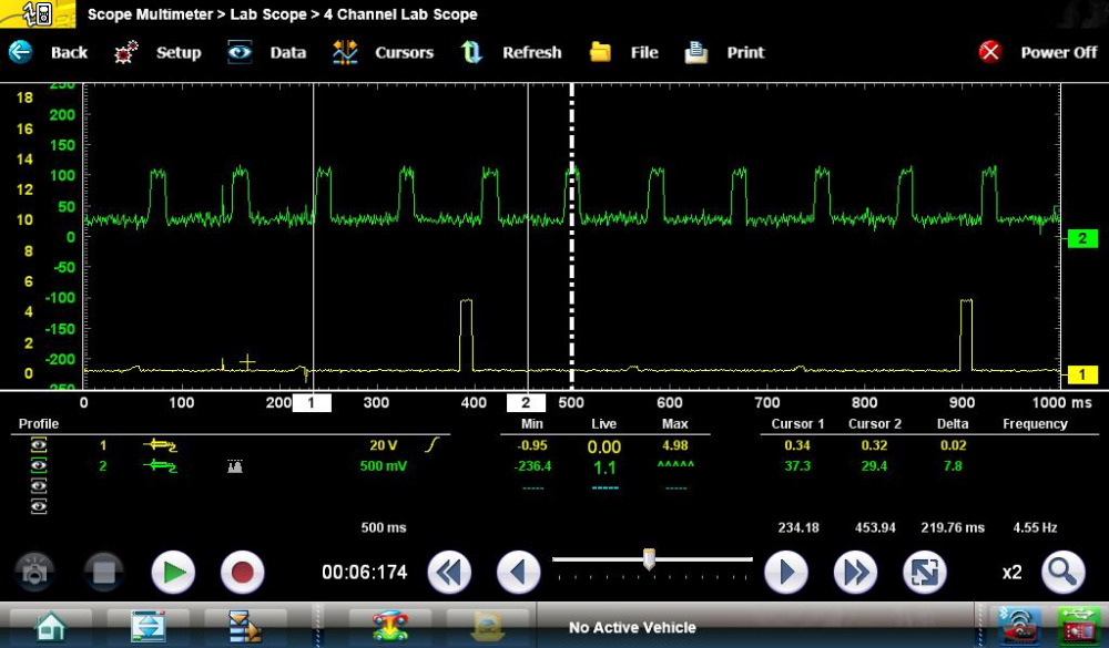

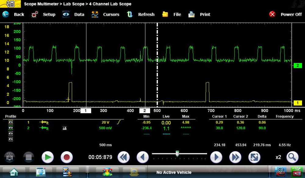

Find out why the injectors are using so little amps. I was expecting ~1 amp on each subsequent ramp, not 250 mA.
I don't think cam crank is an issue because there are no codes, there's injector and spark control, and my initial suspicion concerning the missing injector ramps after all of them fire, well, if the cam crank was an issue the missing ramps would be consistent throughout the capture, not just on initial crank, so that leads me away from cam issue.

I've think it's time we have a look at your cam and crank signals. When you have outputs that are not being turned on, like fuel injectors, it's probably due to bad inputs. Just look at the missing ramps !
You second question about the signals jumping around. That looks like a scope sample rate issue, if you had peak detect turned on you wouldn't see that. Long time bases cause this issue

6 years 10 months ago - 6 years 10 months ago #31795 by Tyler
Replied by Tyler on topic 2001 ACURA CL 3.2 CRANKS/ NO START
jreardon wrote:
I hate to disagree with Paul here, but I think this is actually a scope ground issue. :blush: :lol: Ignition coil trigger signals (and other signal circuits) look like this when the test lead is connected to the coil, but the scope ground either isn't connected or connected poorly.
That doesn't stop the amp probe from reading correctly, however, as it doesn't need an external ground. It makes it's own voltage, and doesn't need to be grounded to the car to work. That's why the amp trace looks OK, but the trigger doesn't.
For example, I got this off my car. Green trace is connected to the #3 coil, but no scope ground is connected.

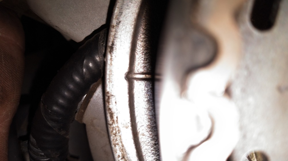

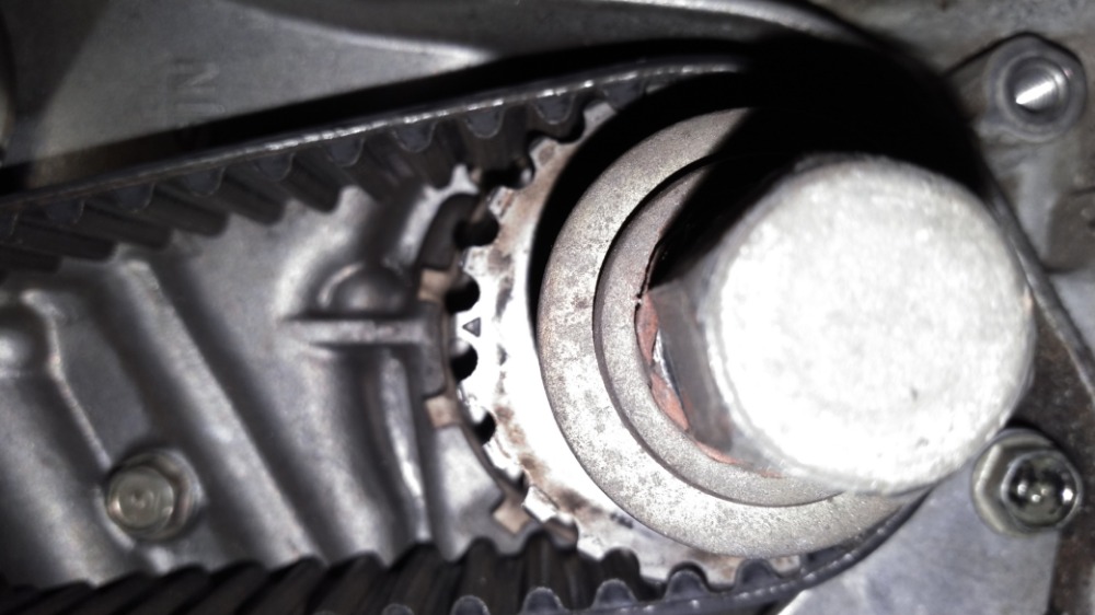

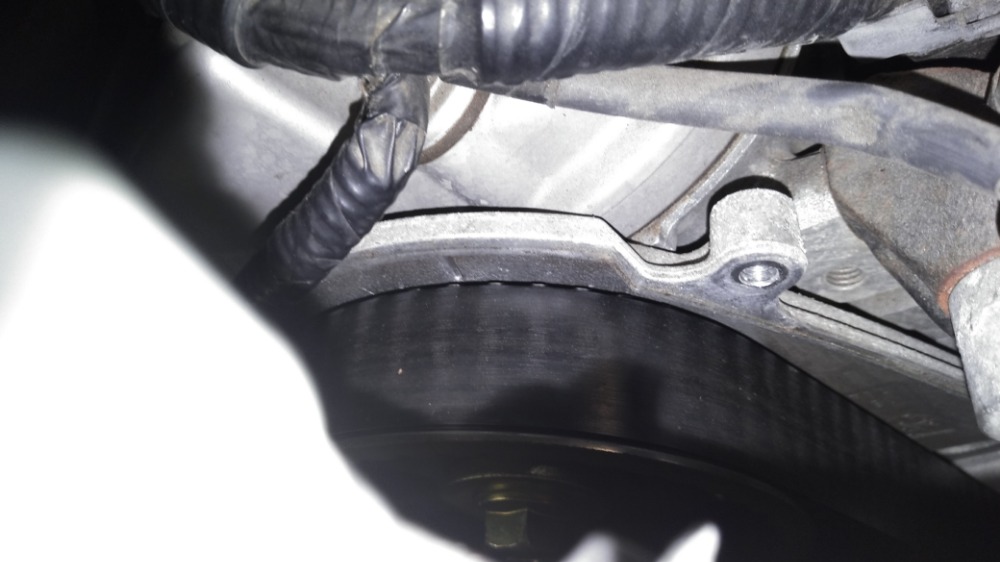

6 years 9 months ago #31842 by tim.smith1
Replied by tim.smith1 on topic 2001 ACURA CL 3.2 CRANKS/ NO START

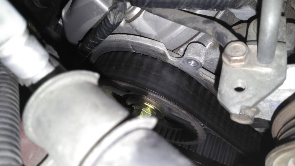

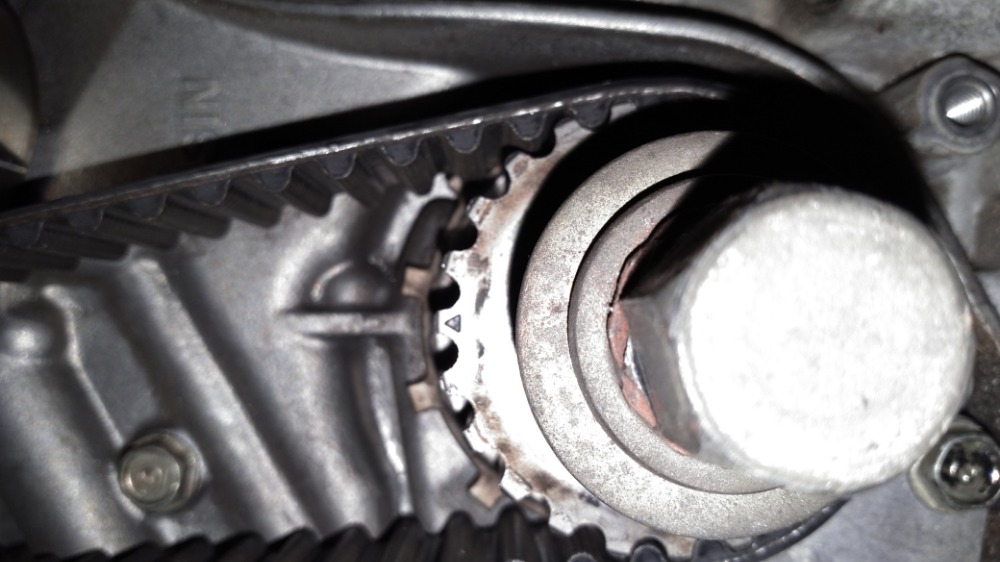

Okay so new information also picks of timing. We disconnected fuel pump and made sure plugs and cylinders were dry then plugged fuel pump back in we got this engine to run around 200 rpms one at a time I unplugged each coil hoping I could pin down what cylinders were working and what ones were not. After all coils were unplugged this car stay running no difference I would describe it as dieseling. The car finally shut off it took a few trys but eventually started back up.
I then decided to unplug the fuel pump and see if I could make the car only run on carb cleaner only with no fuel pump it did and quite well once I got the mixture right.

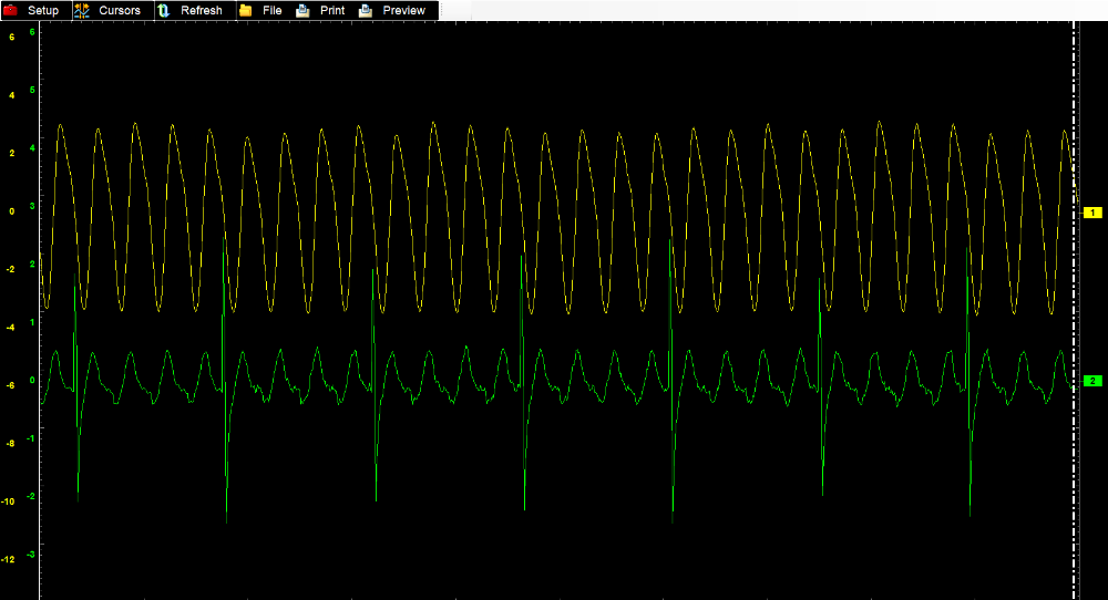

retook coil and injector test coil was yellow off control wire injector was looped into under fuse for main relay that powers injectors with green trace amp clamp was set on 1 mv/1ma looks like 1.2 amps?
6 years 9 months ago #31853 by jreardon
Replied by jreardon on topic 2001 ACURA CL 3.2 CRANKS/ NO START
guafa wrote: Guys, do we know anything about injectors?
How about a balance test? but all injectors at the same time?
cheers.
This ^
The ramps look fine now at ~1 amp each
