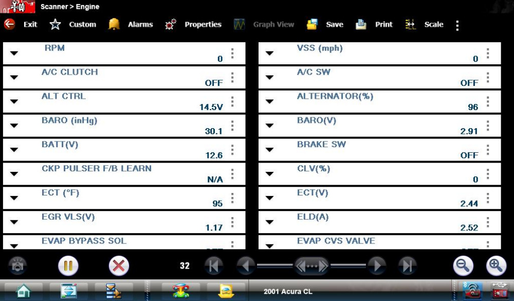

6 years 10 months ago #31372 by jreardon
Replied by jreardon on topic 2001 ACURA CL 3.2 CRANKS/ NO START
Is your key on barometric pressure reading correct?

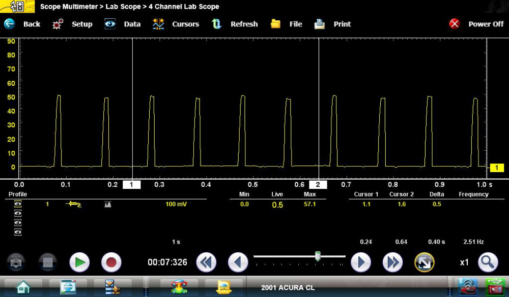

6 years 10 months ago #31427 by tim.smith1
Replied by tim.smith1 on topic 2001 ACURA CL 3.2 CRANKS/ NO START
this is a amp off battery and injector an coil off number 3 cylinder i hope it shows up. if i can improve image somehow please let me know

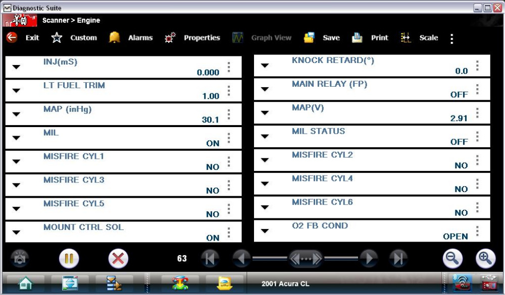

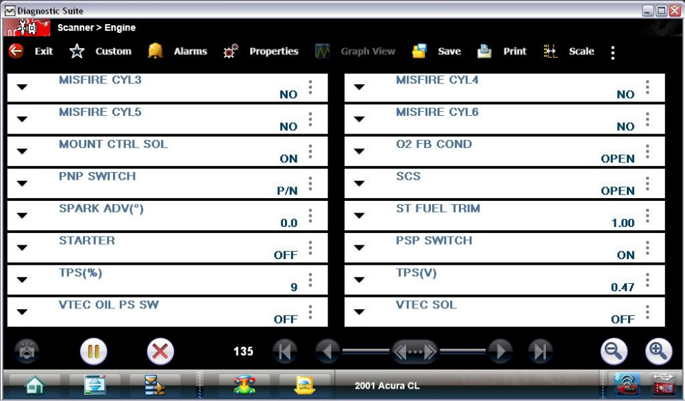

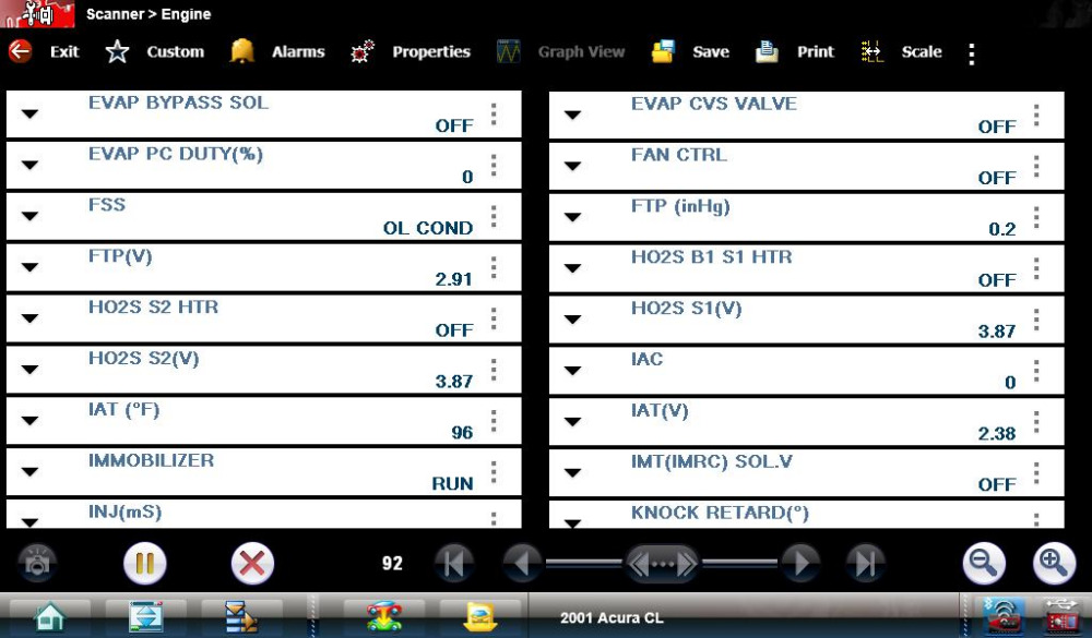

koeo pid screenshots

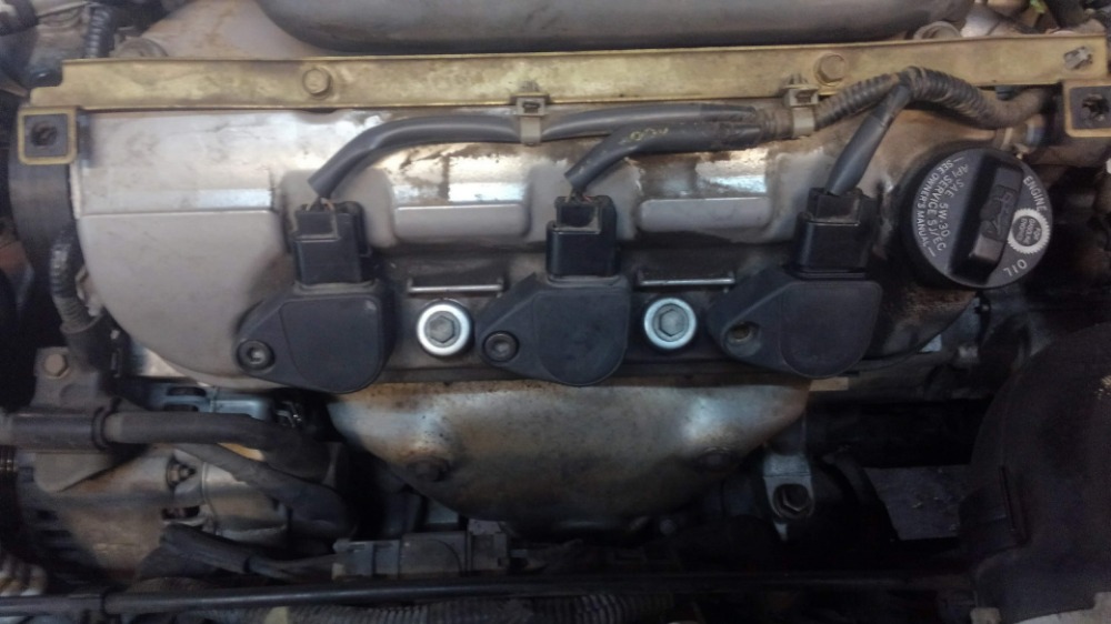

6 years 10 months ago - 6 years 10 months ago #31436 by tim.smith1
Checked control wires for coils they look good

6 years 10 months ago - 6 years 10 months ago #31445 by jreardon
graph your map(inHg), map(v), tps(v) rpm like this:
Code:
https://www.youtube.com/watch?v=noldvC_3qY0&feature=youtu.be&t=253
What we don't want to see is manifold pressure going above atmospheric during cranking, which indicates engine can't exhale.
If so, dry out the plugs and unscrew upstream o2 and see it'll start.
Check all injectors at common power feed with amp clamp and check that they're not shorted, they're opening, and they all look the same with proper ~1 amp ramp peaks. My thinking here is maybe the injectors are opening wetting the plugs slightly, but not opening enough due to weak magnetic field from shorted coil or power feed issue.
Also take a primary current ramp of all the ignition coils (power feed at fuse 11). It may jump gap in atmospheric conditions but it won't jump in a compression environment from weak magnetic field. This could explain why the plugs are wet. An inline spark tester here would suffice as well.

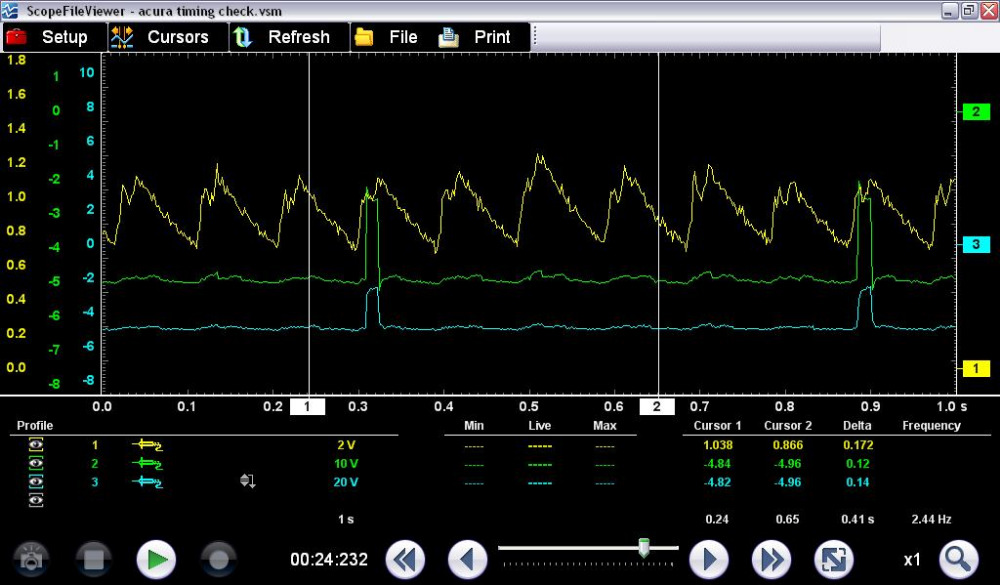

6 years 10 months ago #31531 by tim.smith1
amp probe off of coil fuse
  • tim.smith1
  • tim.smith1's Avatar Topic Author
6 years 10 months ago #31532 by tim.smith1
amp clamp off coil fuse
6 years 10 months ago #31533 by jreardon
Can you put in a second channel and sync it off like any coil IGT wire. I want to make sure all 6 coils are in there. What scale did you set you amp probe to? And a picture of one of the ramps zoomed in please, thanks.
