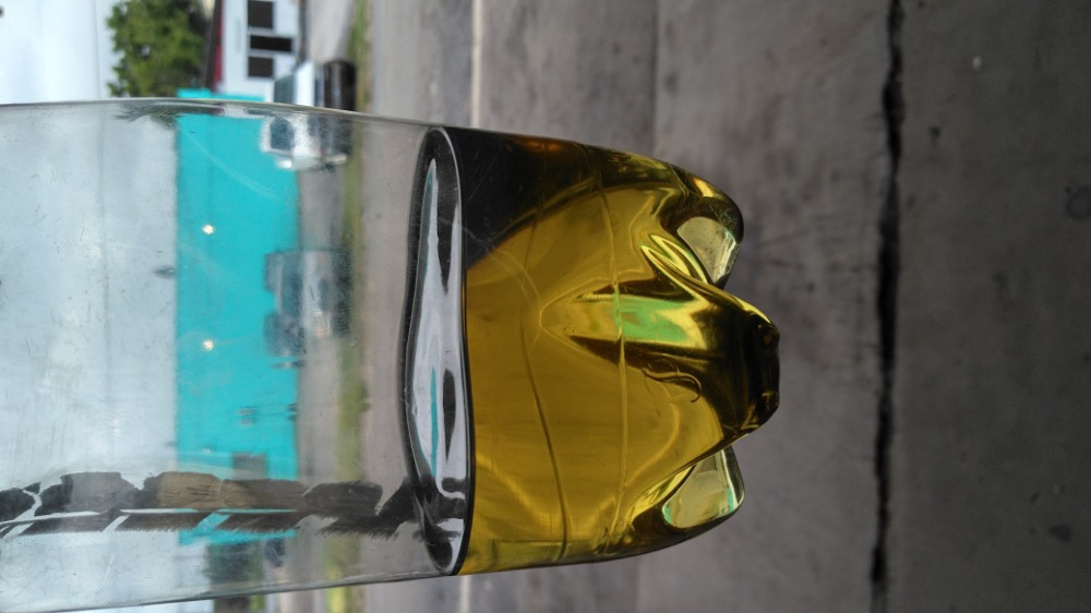

6 years 10 months ago #31648 by tim.smith1
Replied by tim.smith1 on topic 2001 ACURA CL 3.2 CRANKS/ NO START
@Noah reasons i am not looking back into fuel and just an fyi i have a r/c bottle with a fuel sample in it from this car at my shop is when we changed the fuel pump like idiots lol we noticed there was very little gas in the car so of course when the car would not start we put 5 gallons of gas that i ran up to circle k a big chain gas station and put it in the car. then someone questioned the gas so for that reason i did take a sample and i look at it everyday it has no separation i sure wish it would but it is not cooperating with me lol

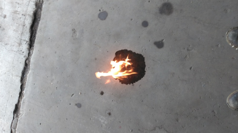

6 years 10 months ago #31659 by jreardon
Replied by jreardon on topic 2001 ACURA CL 3.2 CRANKS/ NO START
Take a fuel sample from the fuel rail and see if it will burn.

6 years 10 months ago #31662 by tim.smith1
Fuel

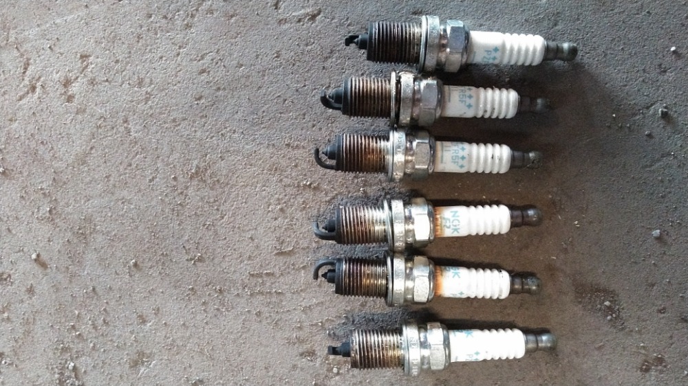

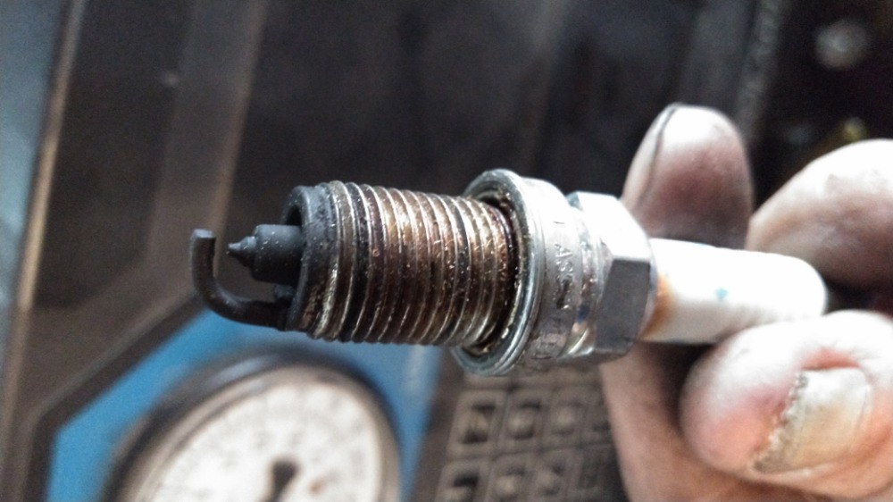

  • tim.smith1's Avatar Topic Author
6 years 10 months ago #31664 by tim.smith1
Just so you guys see what the plugs I took out look like

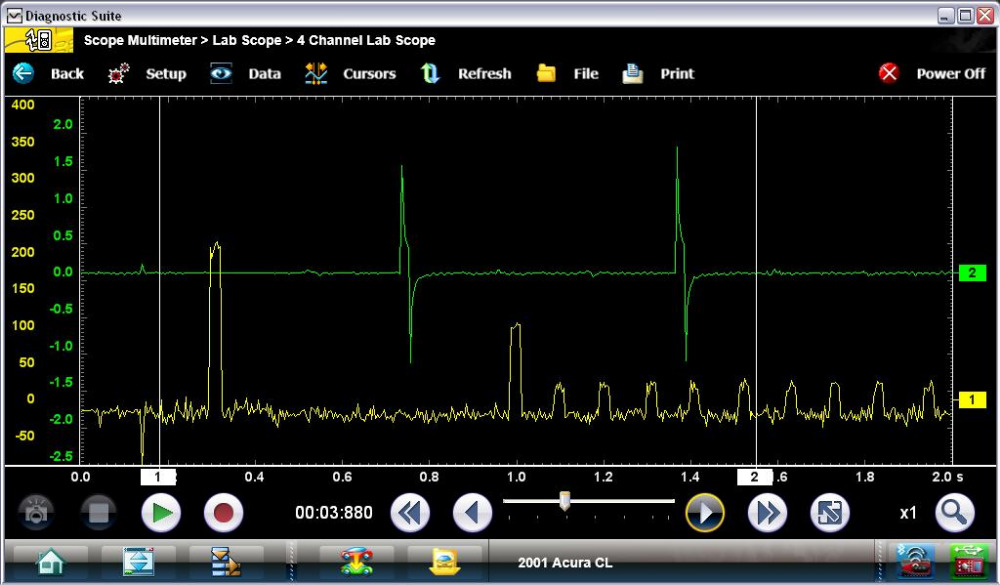

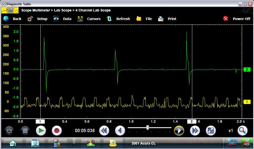

6 years 10 months ago - 6 years 10 months ago #31665 by jreardon
@ScannerDanner Are these ignition control signals to base of transistor supposed to look like that? I thought they'd be more squarish.
@tim.smith1 On the bottom pic where it's more square, you had the connector off cop correct?
It does look a little funny but I wouldn't be concerned with that as long as the coils are firing and they clearly are. The second picture, is that the same signal with the coil unplugged? That looks more like what we would expect but I definitely have seen the base circuit trigger signal be distorted by the current flow of the coil. So again, I don't think this is your problem. I think someone commented on inputs and timing and I would like to see this too. Maybe a relative compression test synced with the base circuit trigger signal on one of the coils to start with.

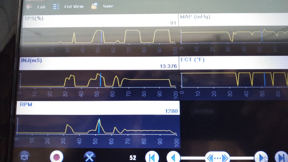

6 years 10 months ago #31666 by tim.smith1
Okay so cleaned off plugs again and dried out cylinders as you see in data pid where the blue trace is car started on its own for a second you will see that rpm is at 1280
how do i load a movie from a versus to the forum page. the two picks are green off the number four coil control wire and yello with amp probe set at 1mv/10ma and scope was set 50 mv seems that is way to low on amps for injectors. ohhh and it was off of fuse for the main relay that controls injectors.

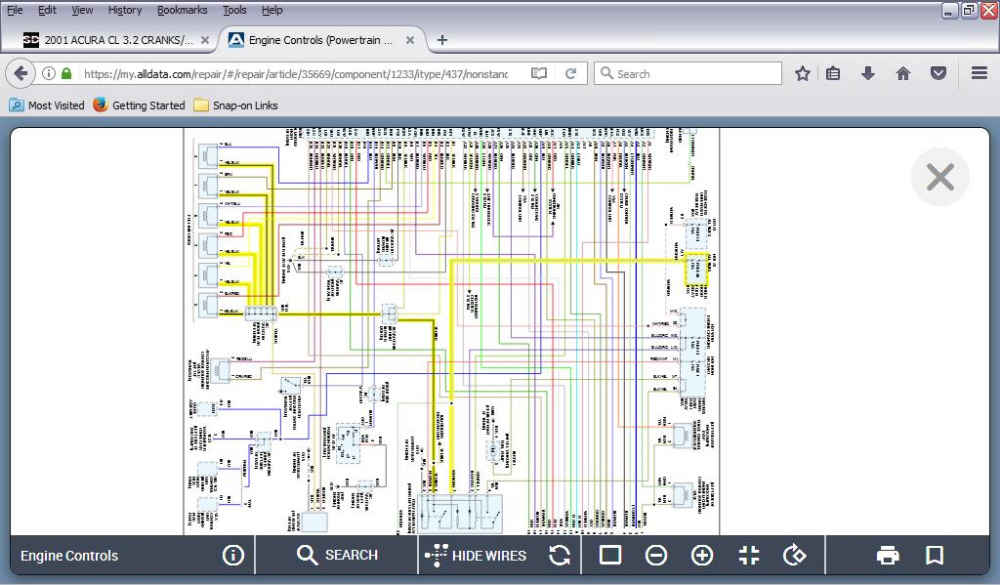

6 years 10 months ago #31669 by tim.smith1
showing the fuse

6 years 10 months ago - 6 years 10 months ago #31672 by jreardon
On second viewing I think those are the two initial igt signals. Maybe the 2.2 amps is all the injectors firing simultaneously. Maybe the missing ramps are normal? Are you missing any more ramps thereafter in a longer time frame?
If not, then that would mean there's a power or ground issue because ~250mA of current is too low for an injector. Or maybe your homemade fuse jumper has too much voltage drop, maybe the amp clamp is low on batteries, maybe you didn't zero out the probe... too many variables lol.
I could go either way on checking out the cam and crank signals or voltage drop testing a fuel injector feed. Seeing that peak amperage ramp at 2.2, yeah, just pick out a single power feed at the nearest injector, crank engine, and do voltage drop test on it.
EDIT: You know what would be easier to check power and ground to injector? Put on your attenuator and capture an injector voltage waveform.

6 years 10 months ago #31681 by guafa
Replied by guafa on topic 2001 ACURA CL 3.2 CRANKS/ NO START
Jreardon: Completely pertinent. 250mA is to low for me also (unlees tools were not fast enough to graph peaks)
Tim.smith: According to pictures of spark plugs, i was expecting totally wet ones.
I mean, wet without resistors and dry with resistors (if it's the case, we can conclude something).
did you notice any diference with and without resistors?
I can't still conclude wheter is lack or to much fuel
