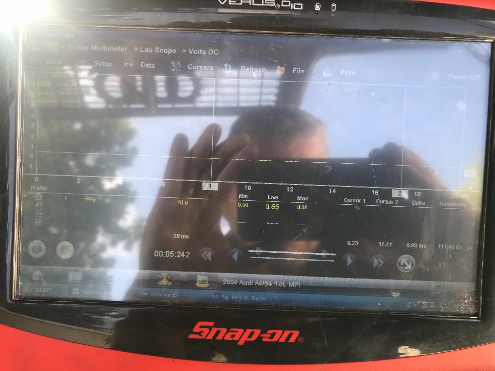

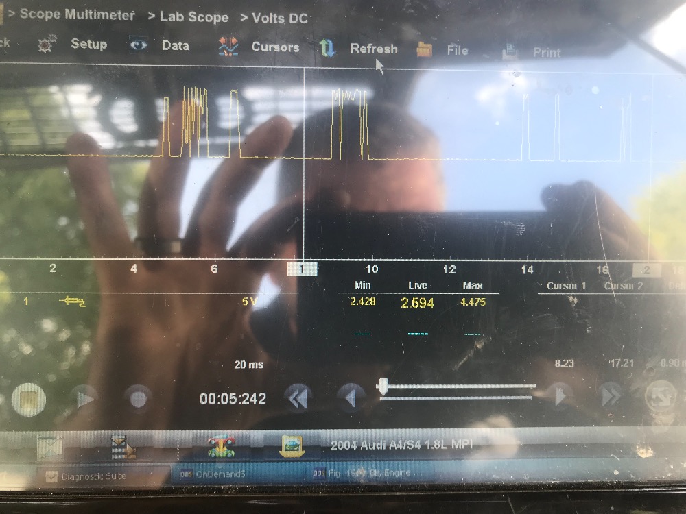

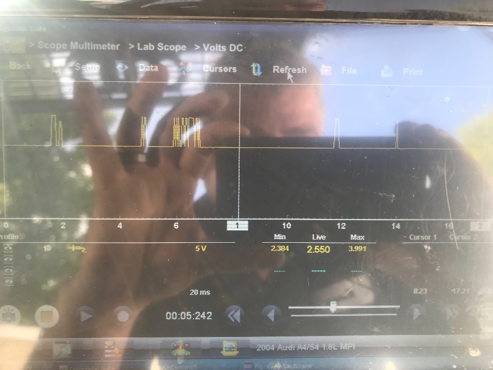

  • Nandor69
  • Nandor69's Avatar Topic Author
8 years 4 weeks ago #13101 by Nandor69
When I wrote that I think when I jumped the relay that also happened to be one of the times the ECM was actually communicating.
I am positive the relay is a pull down type relay. Right now I just jumped it and I get power on the 3 fuses and the fuel pump runs. So the only thing the relay isn’t getting is the ground from ecm But it won’t start because of no comm.
(I added pics for this next part)
Checking the comm wire on pin 60, with key off its at .55V.
Key on and ECM plugged in the comm maxes at 3.99V
Key on ecm unplugged the comm maxes at 4.457V
With the ecm unplugged or plugged in I can communicate with every other module on the car. I painstakingly with through each on that the car has. (It takes forever to connect to each one)
I don’t want to keep coming back to the ecm but I keep getting lead there(or leading myself there)
But what do you think of those comm voltages?
From what it looks like to me there are 2 powers and 2 grounds for ecm
Power all the time on pin 62
Power with key in start or run on pin 3
Grounds on pins 1 and 2
