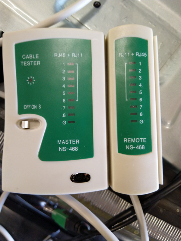

5 years 6 months ago #48776 by stevieturbo
Replied by stevieturbo on topic Rotkee vs. Pico
Sounds like it is getting power. Lack of lights thereafter is maybe just a sign of no comms. Would need to plug mine in to see.
Maybe worth testing if the LAN cable has continuity on the relevant pins ( it probably only uses 4 of them )
And of course...does your LAN port work on the computer ok ?
5 years 6 months ago #48778 by vb4me
Replied by vb4me on topic Rotkee vs. Pico
I would assume so. I have even tried a lan to usb adapter. I will check the cable in the morning though
5 years 6 months ago - 5 years 6 months ago #48779 by stevieturbo
LAN to USB may not work as it is not what the device and protocols are expecting.
And never assume it works, hook it up to a LAN device or network and verify.,
I bought a used laptop a few years ago and mucked about for ages with no connection, only to find out the port was broken.
Or plug the device into a home PC to test.
Last edit: 5 years 6 months ago by stevieturbo.
5 years 6 months ago #48804 by vb4me
Have tried another computer and lan cable . Same result. Looks like a faulty unit
5 years 6 months ago #48819 by stevieturbo
I'll test my cable later to see what pins are actually used.
Not sure if they use a straight or crossover setup
5 years 6 months ago - 5 years 6 months ago #48821 by stevieturbo
I tested with a cheapy RJ45 cable tester.
With this, it lights up as 1, 2, 6 and G as connected. Seems odd wiring. So I doubt a normal RJ45 lead would work ?
And yes, if the unit has 5v power the green LED on the LAN port is lit. The other must flash with comms

5 years 6 months ago #48843 by Matt T
Replied by Matt T on topic Rotkee vs. Pico
stevieturbo wrote: With this, it lights up as 1, 2, 6 and G as connected. Seems odd wiring. So I doubt a normal RJ45 lead would work ?
That's standard wiring but should also have continuity on 3. Since you're using an off brand cable tester might want to use a DMM to check whether the cable is straight or pass thru'.
