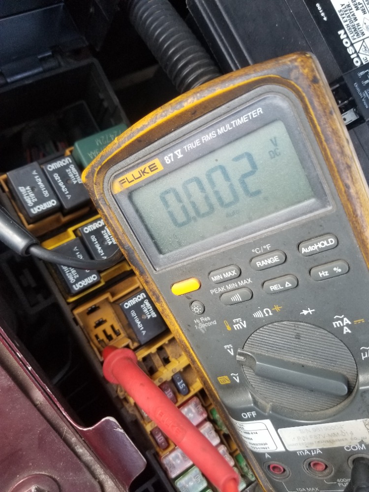

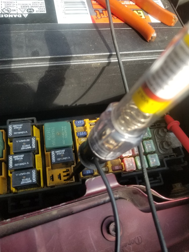

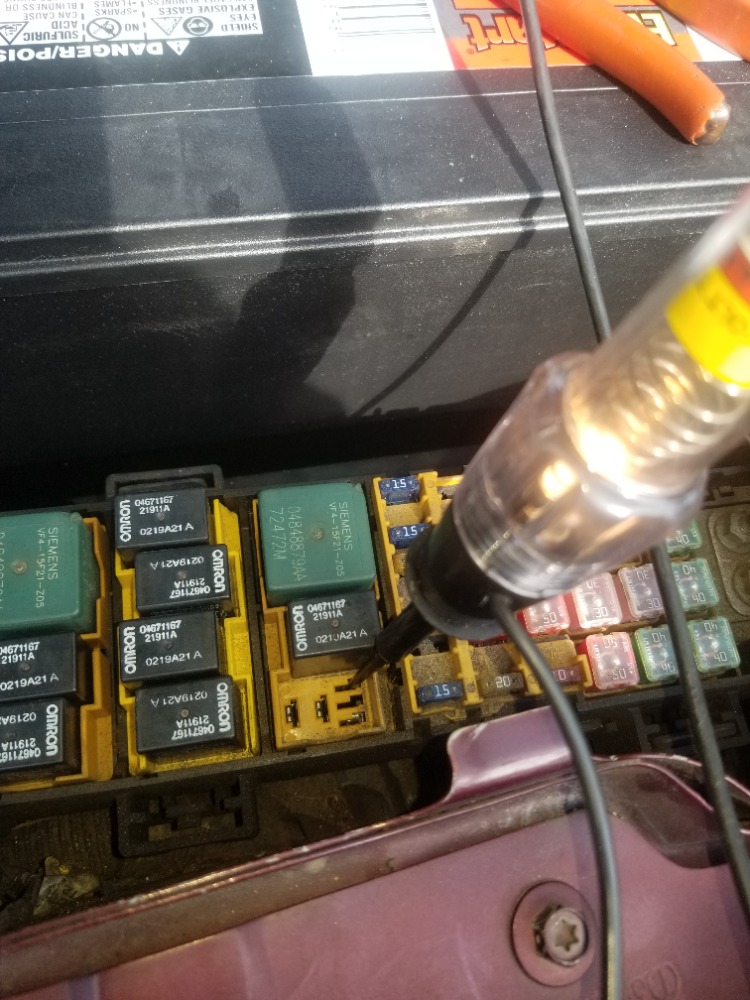

5 years 11 months ago #43620 by Hardtopdr2
Replied by Hardtopdr2 on topic Crank but no start

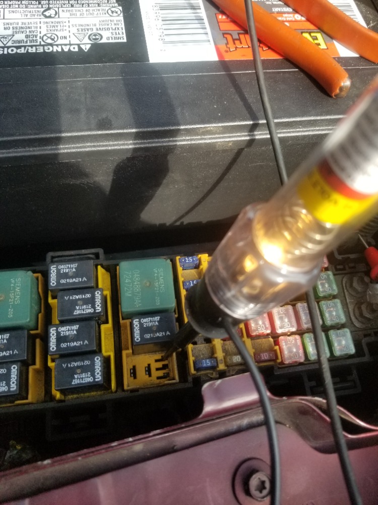

I think you didnt probe it right see photo this is a bottom view of relay diagram just flip the outer two of the group of three for the fuse box side to test powers

5 years 11 months ago - 5 years 11 months ago #43626 by Dukeh
Replied by Dukeh on topic Crank but no start
Hardtopdr2 wrote: I think you didnt probe it right see photo this is a bottom view of relay diagram just flip the outer two of the group of three for the fuse box side to test powers
ok thank you. If thats the case light comes on to 86 an 85 reads .002

5 years 11 months ago #43631 by Dukeh
Monde wrote: You should have power on pin 85 ( Test light to ground an tip on pin 85) and control on pun 86 (Test light to power and tip on pin 86). Have you tried another fuel source?
i have used starting fluid and it fires for a second.

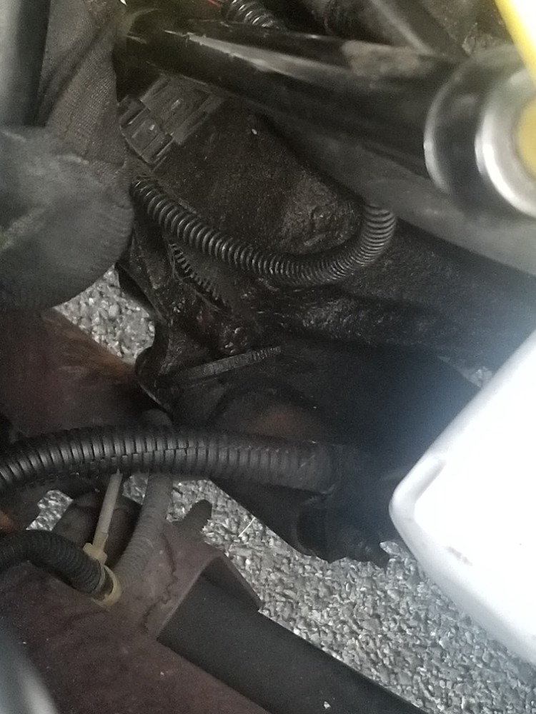

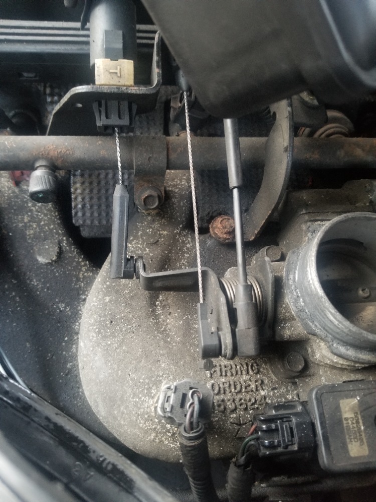

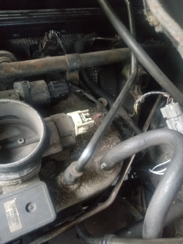

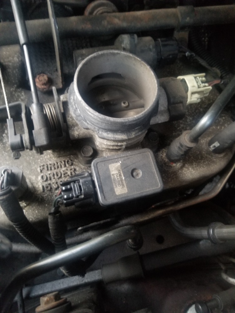

5 years 11 months ago #43669 by Dukeh

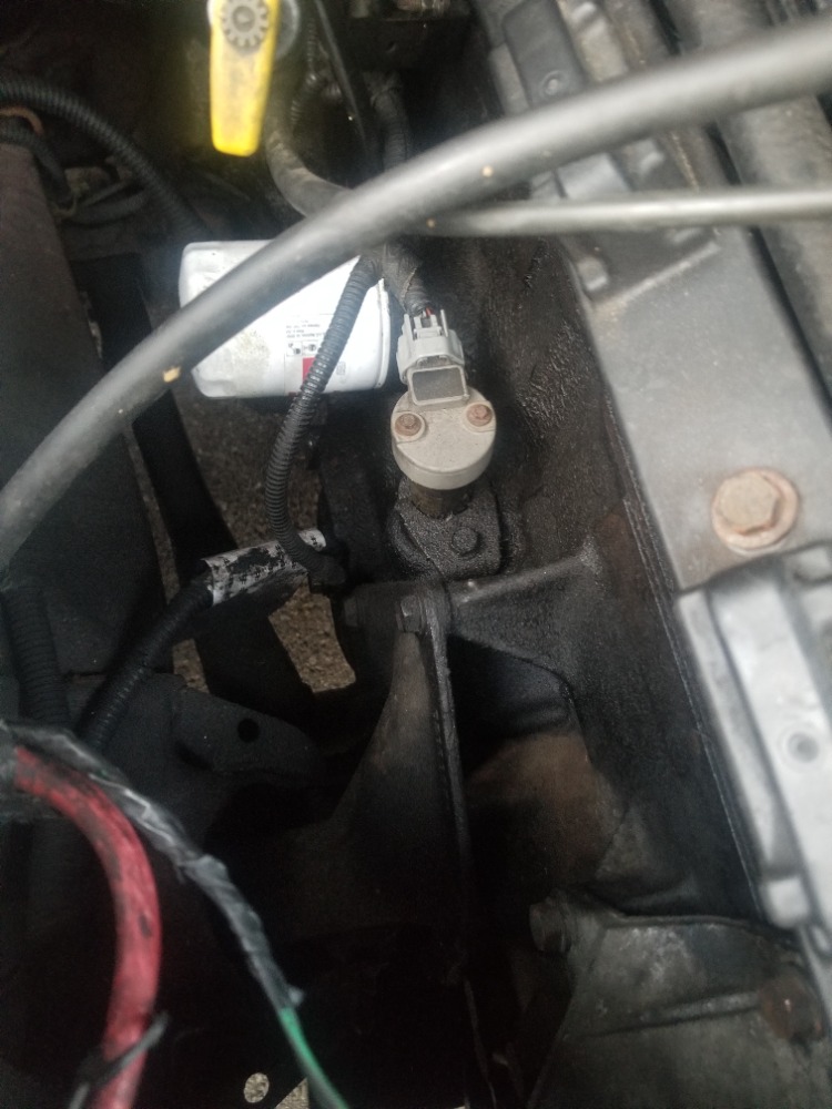

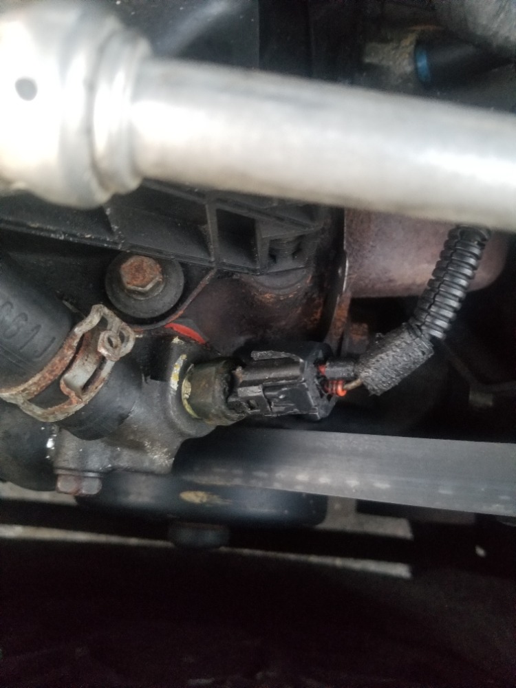

Monde wrote: Your Jeep is not equipped with a MAF. The sensors that you need to unplug are CRANK, CAM( inside of distributor) TPS, MAP, Engine oil pressure sensor. The vehicle speed sensor seems to have a different 5v ref. I may be wrong. You can unplug it as well. Just make sure you monitor one of them. Make sure the one you monitor remains plugged in. Hopefully, you can do that.
Sorry about that it was the MAP sensor. Pics of sensors i pulled. I am having trouble pulling the oil pressure sensor.

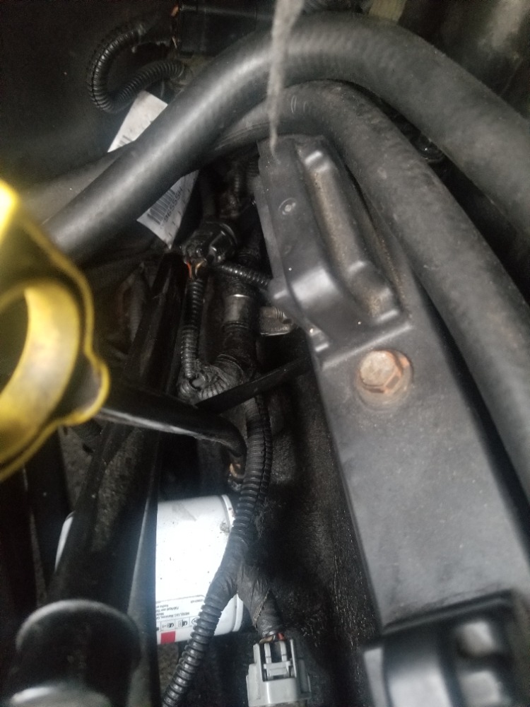

  • Dukeh
  • Dukeh's Avatar Topic Author
5 years 11 months ago #43693 by Dukeh
Sorry about that it was the MAP sensor. Pics of sensors i pulled. I am having trouble pulling the oil pressure sensor..
***update*** so i was able to pull oil pressure sensor and still no 5v reference.

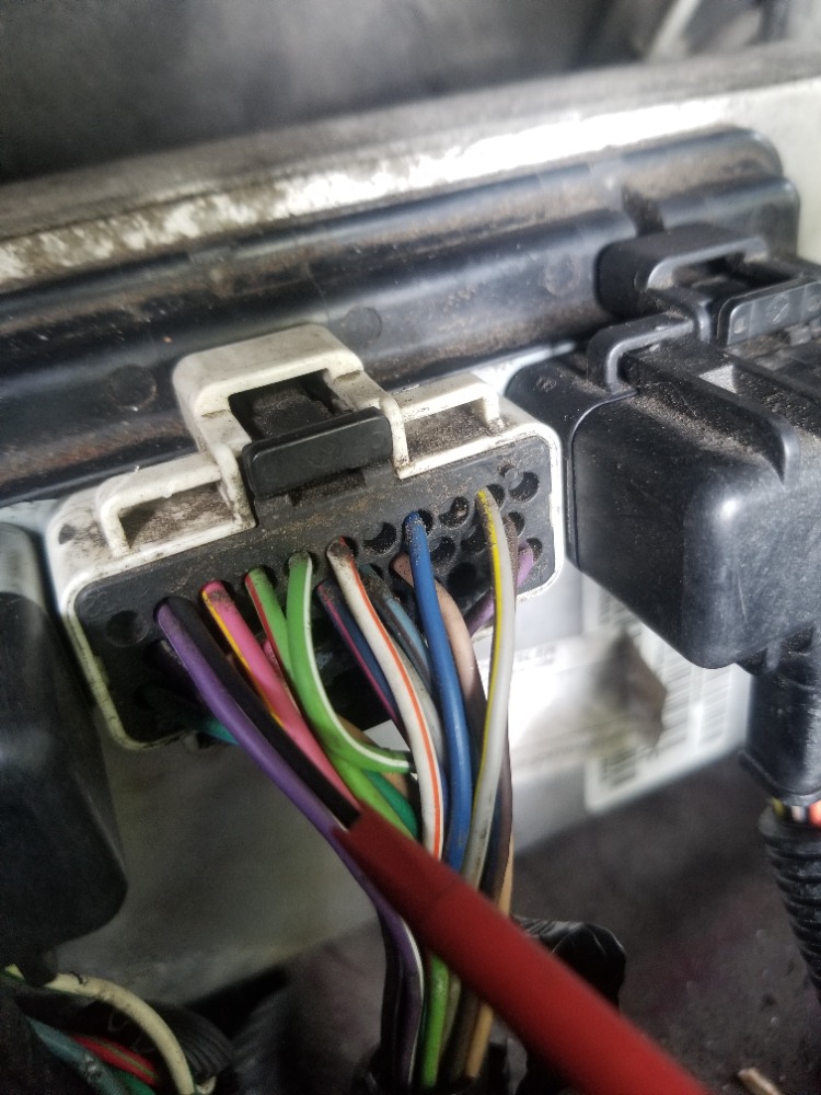

5 years 11 months ago - 5 years 11 months ago #43712 by Dukeh

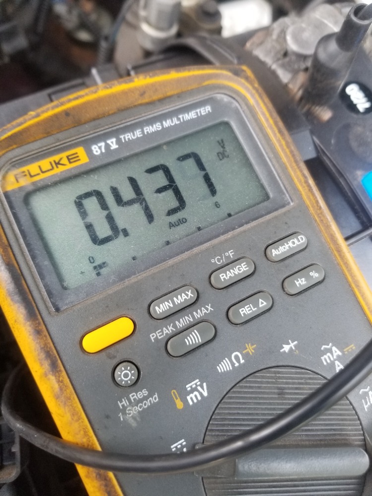

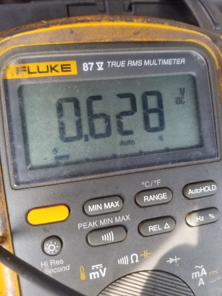

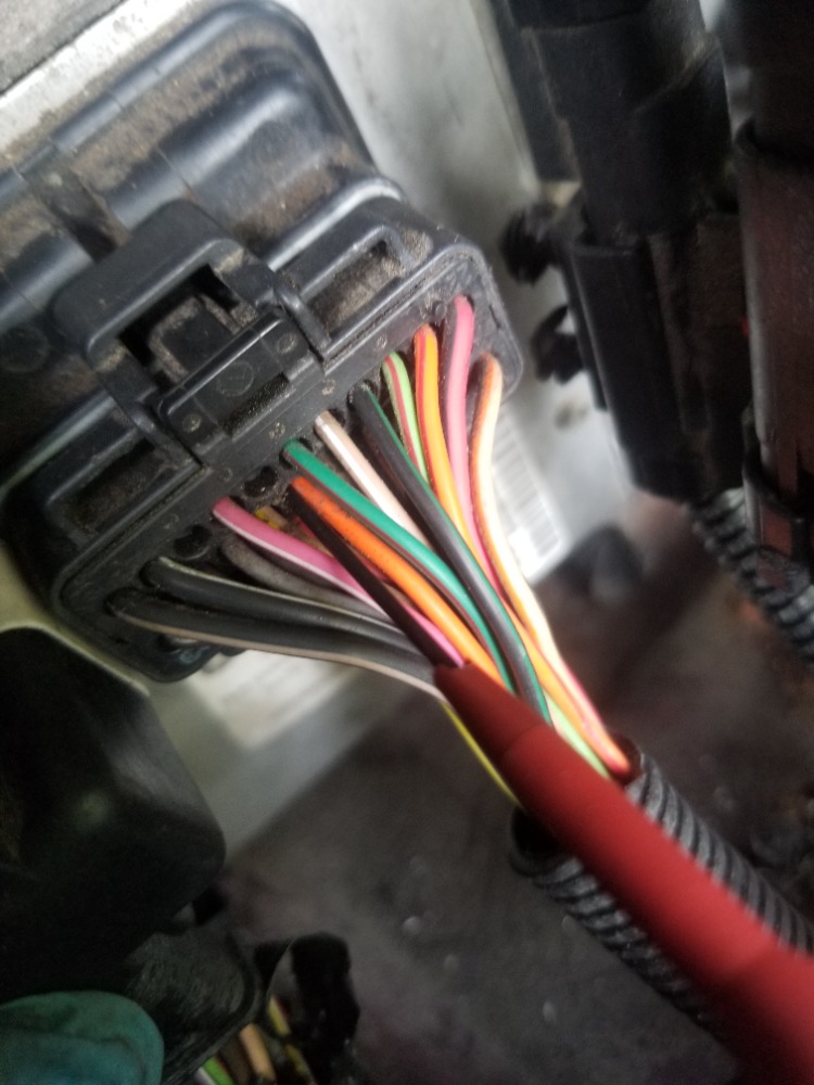

Monde wrote: Can you access pin A17 ( orange wire) at the pcm. Backprobe pin A17 at the Pcm, hook voltmeter to ground and tip to pin, see if you have 5v or close to 5v there. You can do the same for pin B31(violet/ Orange wire.
You don't have spark, right?
I back probed A17 and got .628. Back probed B31 and got .437. No spark from what i see i put a screwdriver in the boot wrapped with copper wire and placed the other end about 1/8 of an inch away from engine block and didn't see any spark.

  • Dukeh
5 years 11 months ago #43734 by Dukeh
Monde wrote: So with the key in the START or RUN position, you back probed A17 and B31 and you get.628 and.437v. This suggests that either one of the sensors or its circuitry is shorted or the pcm is not providing the 5v ref. If the 5v ref were open, you would get 5 or close to 5v at pin A7 and B31 unless you have a connector issue. With good powers and good grounds at the pcm, it should be able to provide the 5v ref to the sensors, but is not. We might be dealing with a pcm problem. Before we condemn the pcm, let's unplug the connector and touch A17 and B31 pins with voltmeter positive lead and negative lead to ground with key in the RUN or START position to look for the 5v ref. Also, you can put the voltmeter in ohm setting, unplug the connector, set the meter to the highest ohm scale, front probe pin A17 or B31 with black meter lead to ground( battery disconnected), acceptable reading OL. Make sure you don't damage the connector. Back probing it would be better, but slightly touching it is fine.A helper is needed because you need the vehicle in START or RUN position.
If everything fails, we might need to start looking at inputs ( CAM ann CRANK sensors, or antitheft issue)
A17 is at 1.461 B31 is at .156 and ohm reading at A17 was 3.856 and continuously rising B31 was at 185.4.
