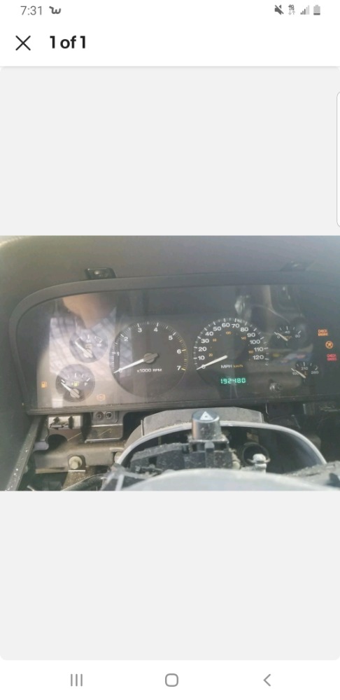

99 jeep grand Cherokee 4.0. I have a crank no start no communication. I pulled and light tested fuses swapped relays. I replaced PCM with 2 different pcms both identical and flashed to vin. Im not getting 5v to my sensors. No fuel to fuel rail. Pump doesn't turn on. Im absolutely lost. It will try to turn over with starting fluid. I added pic of my dash to show all lights that are on. Any feedback on this nightmare would be greatly appreciated. Thank you in advance.

Also gauges are not active. I do get very slight movement in my volt gauge. I pulled and cleaned all grounds i could find as well.

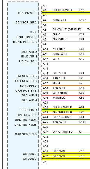

5 years 1 month ago - 5 years 1 month ago #43543 by Chad
Replied by Chad on topic Crank but no start
Check for battery voltage at all the points circled in RED. Start with the fuses.
Make sure there is LESS than 100mv ( 0.1 volt) on the Ground wires circled in BLACK.
Do this with the key in the "RUN" position.
Do you know how to "back-probe"?

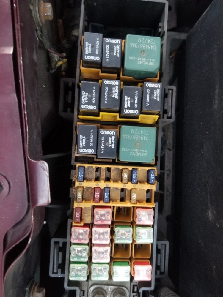

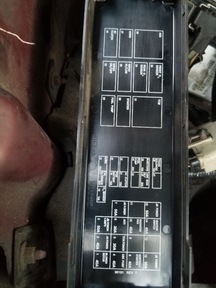

Ok.... my battery is dying i got a 9.76 reading off of it i need to recharge. On A2 back probe my reading was 9.68 on back probe of A22 my reading was .009. On back probe of A31 reading was .006. There was no fuse 22 15A in my relay box and fuse 11 20A was a reading of 9.68 it was my rear defroster. I added pics of fuse box and relay box for reference. Thanks again guys the help is greatly appreciated.

Dukeh wrote: There was no fuse 22 15A in my relay box and fuse 11 20A was a reading of 9.68 it was my rear defroster.
Hmm.:unsure:
It looks like we have some discrepancies. Do the wire colors for A2 and A22 match the diagram? (EDIT: Do all wire colors match the diagram?)

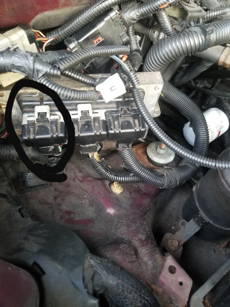

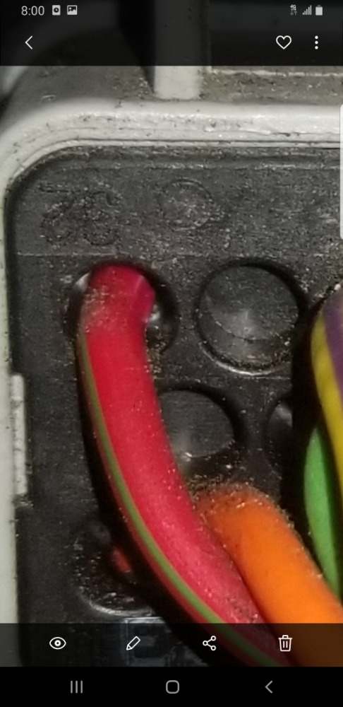

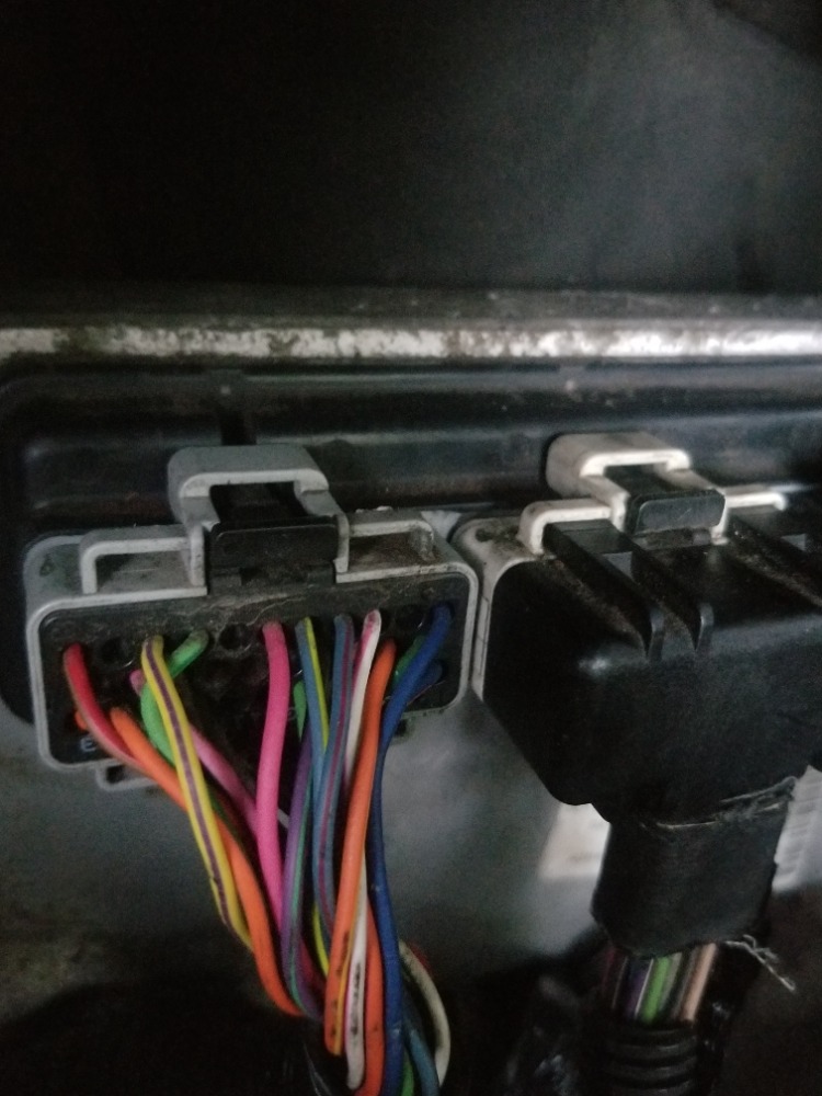

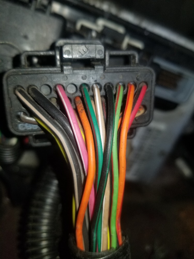

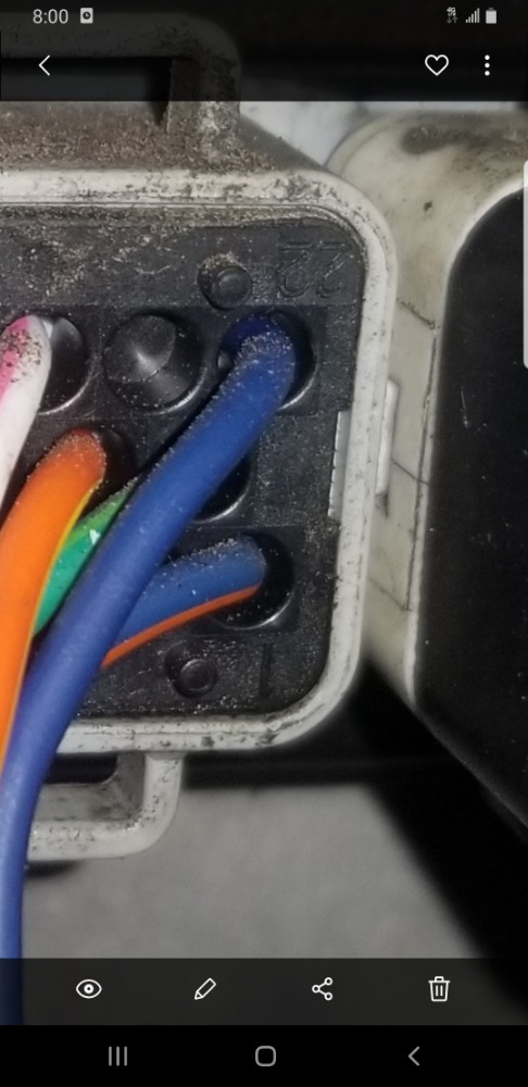

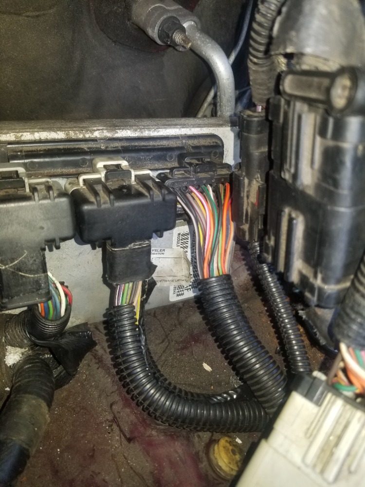

pics of 32, 1 and 22 wires. Also pic to show the back of the cluster going into the pcm to verify it was the right one.
5 years 4 weeks ago - 5 years 4 weeks ago #43582 by Chad
The connector you have pictured is connector #3, or "C". We want connector #1, or "A".
The color sequence should match this:
As for the fuses, it looks like there are two different fuse boxes. Look around for another one.

Chad wrote: The connector you have pictured is connector #3, or "C". We want connector #1, or "A".

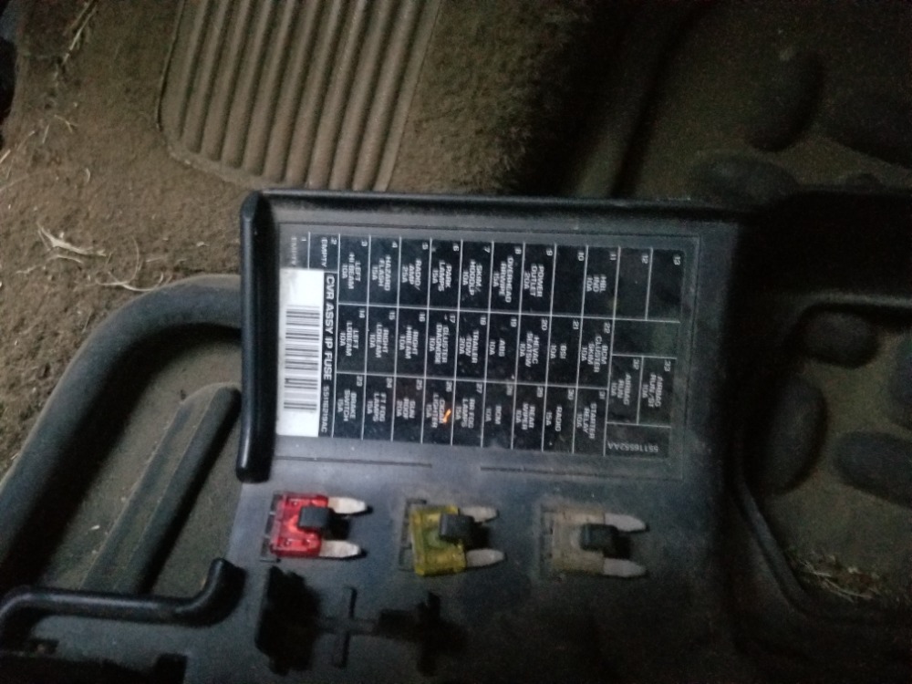

Ok sorry about that i will check the right one out tonight and relay the information. There is a smaller fuse box underneath the dash ill see if thats the one as well.

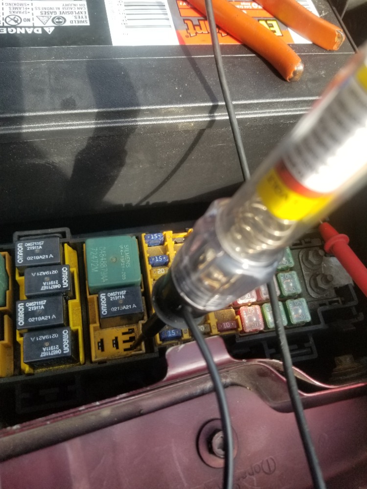

So i back probed the correct cluster i believe. A2 12.53 a22 12.69 a31 .007 a32 .007. I recharged my battery it 12.7. I checked pin 85 fuel pump relay it was 12.54. Light test pin 86 no light.
