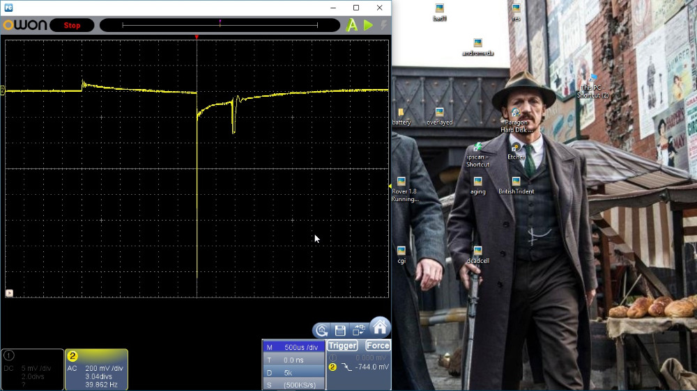

7 years 8 months ago - 7 years 8 months ago #27460
Replied by Andy.MacFadyen on topic Hantek DSO3064 / 6074BE Scopes
This capture is with a Hantek HT25 Plug Wire Probe It is upside down because it is from the negative spark side of a wasted spark system.
It only took a few seconds to setup
The only draw back to the Owon VDS1022i I have discovered is the channel invert option seems to be buggy.
Like most general purpose lab scopes The Owon lacks a dedicated probe scale setting for an x20 attenuator this isn't an issue as you can use the x10 setting and multiply the voltages by 2.
Alternatively as the upper voltage limit for the scope is 40v a x10 attenuator will provide sufficient protection for the scope an laptop.
