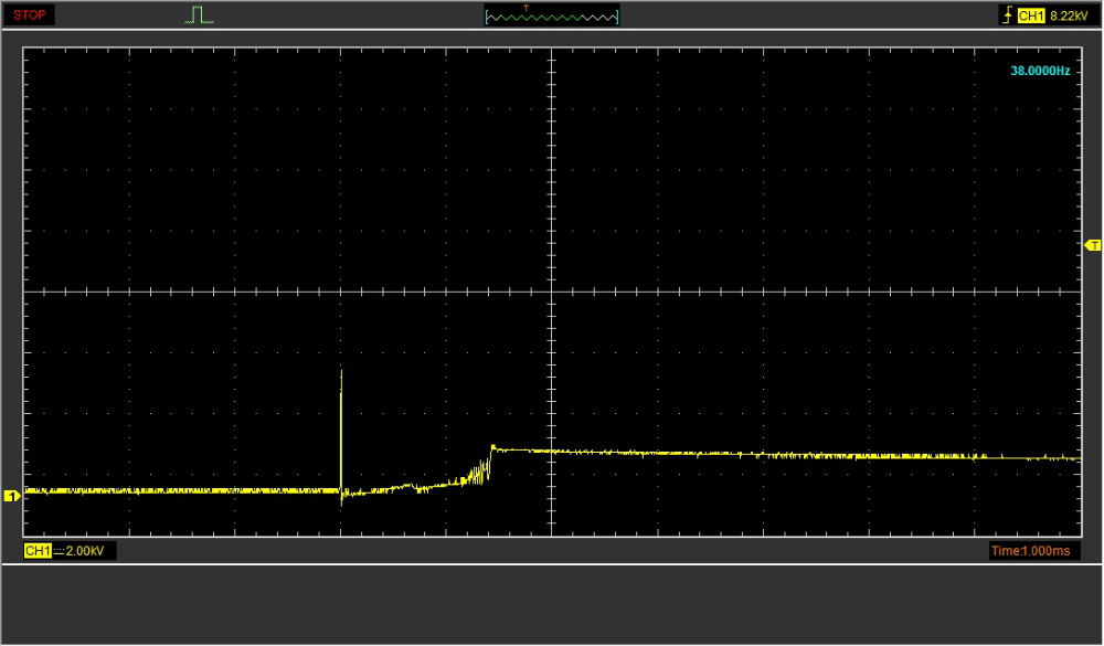

I did some primary vs secondary ignition waveform captures and posted the results in this other thread: www.scannerdanner.com/forum/post-your-re...n-a-distributor.html
I think the HT25 is probably just a crappy secondary pickup. I'd appreciate your feedback.

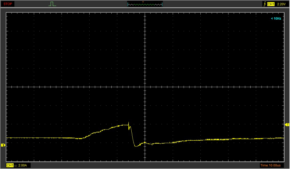

Here are some results looking at the primary ignition waveform and current ramp. The trick with the cc65 is that it accepts interference from the environment, so you have to hold or set the body of the cc65 as far away from the coil as possible to get a clean signal. Also, don't forget to let the scope warm up and run the calibration routine.

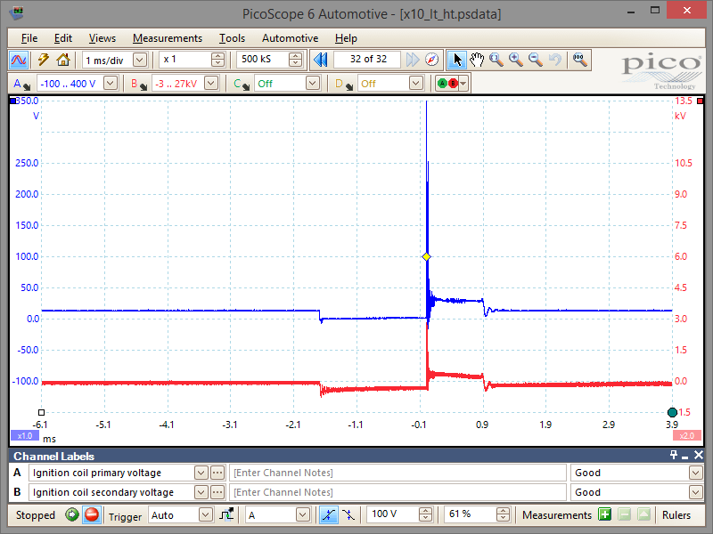

8 years 9 months ago - 8 years 9 months ago #17473 by SailorBob
Replied by SailorBob on topic Hantek DSO3064 / 6074BE Scopes
217oldtimer wrote: Hi, first time poster here. I bought the 6074be and thought some initial comments/waveforms might be helpful to others that are on the fence. I don't have enough experience with DSO's to make qualified judgments but my initial impression is I was hoping for more. I'll attach some of my first waveforms. They look to be kind of raw (unfiltered?) compared to even the AES Wave handheld dso used by Paul in a recent misfire video.
OK, I think I may have a lead ( no pun intended ) on what the problem is. I found these images of know good waveforms on the Picoscope website :
So in this picture, the Primary and Secondary are almost exactly mirrors of each other.
However in this waveform we see the same kind of strange degradation we've observed in our personal measurements with the Hantek scopes and HT25 leads. This makes me think there is some other variable here, not related directly to the scope and lead we're using, but I'm not sure what it is.
Also, I just ran across this post of mine from a little while back in which I had just got the scope and was playing around trying to get secondary ignition traces. What I noticed was that my waveforms were really clear and detailed. The difference was that I was just directly looking at the output of the HT25 pickup on a 50mV / div screen without using the 10,000x scaling. I think the software scaling may screw up the appearance of the waveform.
Maybe I'll post about this on iatn, and see if anyone can explain what's going on, or maybe I'll go out and see if turning of the 10,000x scaling and just reading directly in mV gives better results.
Last edit: 8 years 9 months ago by SailorBob.
