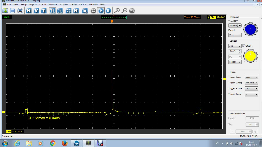

9 years 2 weeks ago - 9 years 2 weeks ago #13914 by SailorBob
Replied by SailorBob on topic Secondary ignition waveform
I'm having fun with my Hantek 1008C and tried it out on my ignition system today using the HT25 inductive clamp probe. My 98 Mazda 626 GF 2L uses a coil pack waste spark system with each coil firing two plugs simultaneously. I'm pretty new to scopes. Like really new.
I took a short one minute video and captured a few individual wave forms. Going over that video in slow motion I saw quite a variety of waveform shapes, however the fire lines were all about 2 milliseconds which is supposedly pretty good and close to the maximum possible. I don't think the scope was displaying every single spark event because I had the trigger set fairly high, however these two basic waveforms were the most common:
This seems pretty normal, but I was wondering why that second spike was so high? Just allot of energy to wring out?
This is the other common one, and I'm assuming this is the waste spark?
My odd numbered cylinders where upside down like this. I wanted to do the 10k X scaling for this probe, but couldn't get it to work, so I just left it in mV.
I mentioned that I saw a variety of waveforms on slow-mo in the linked video; how much do I care about the exact shape especially of regarding the shape of the burn line?

9 years 2 weeks ago #13915 by Andy.MacFadyen
Replied by Andy.MacFadyen on topic Secondary ignition waveform
A waste spark system is exactly that on any single cylinder every 2nd spark is wasted there isn't any point looking at wasted sparks. On a the the wasted sparks peak voltage is lower peak voltage and the spark line voltage is lower. As a result at the end of the spark energy is left over this causes the rising voltage forming the toe at the end of the spark.
When looking at ignition secondary traces on wasted spark systems the trigger level should be set high enough to trigger only ignition firing sparks not wasted sparks.
If you find a significant "toe" voltage at the end of an actually firing spark then it could point to a plug lead or plug shorted to ground or a spark plug gap set too narrow.
With a wasted spark system the companion cylinder can also affect the spark line on the cylinder you are looking at.

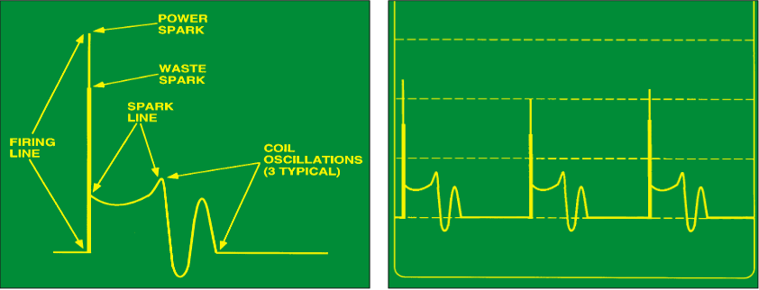

9 years 2 weeks ago #13929 by SailorBob
OK, so I was reading this article from Motor magazine and those are apparently both normal sparks, and in a waste spark system, the waste spark is superimposed on the firing spark and can be seen as the thick spot on the firing line:

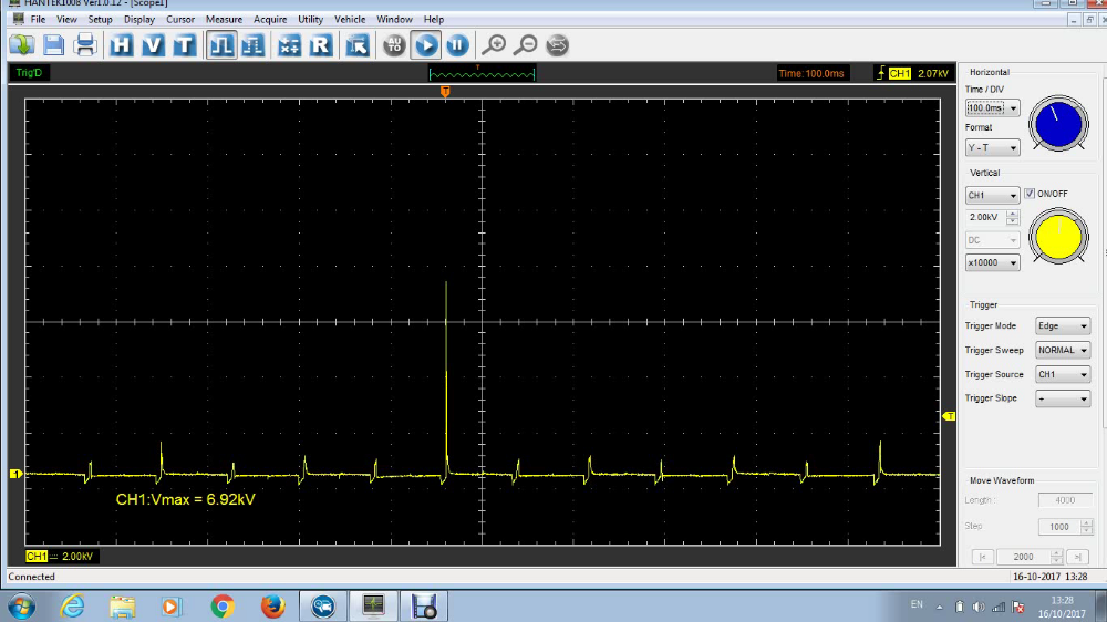

9 years 2 weeks ago - 9 years 2 weeks ago #13930 by SailorBob
I think I just realized that scopes translate time as well? When I was looking at the spark with my divs set to 2ms I could actively see the shape of the spark changing and updating. When I set it to 20ms I could still see the shape of the spark changing on the screen, but more slowly, and when I set it to 100ms I could only see static pictures, sometimes the screen would only update once every few seconds. That makes me wonder if maybe I messed something up in the settings or have a defective probe or scope.
I also saw some things I quite frankly didn't understand. When I set it to 20ms/2kv with a 5kv trigger I saw these shapes on both sides of the spark:
Then when I set it to 100ms/2kv with a 2kv trigger things got stranger:
What am I seeing? Is there something wrong with my scope or setup? I was using an HT25 inductive clamp probe attached to the plug wire and grounded to the engine.
Maybe I was picking up noise from other things because I grounded the probe to the engine ground and not the battery?
The engine was running about 750rpm here which translates to 6.25 hertz, which would give me a spark on that plug once every 1.5 seconds approximately.
Last edit: 9 years 2 weeks ago by SailorBob.
9 years 2 weeks ago #13932 by Andy.MacFadyen
The Hantek 1008 is a very limited scope if you expand the time per division the detail not only only disappears but it can totally destroy the detail and create "scope artifacts".
On a waste spark system with the Hantek you will only really to be one spark in useful detail.
The article and illustrations in Motor magazine are showing what you would see on a old style cathode ray oscilloscope, with a cathode ray tube the glow of the phosphor coating has persistence ie it continues to glow after the trace has moved on, you won't see the two traces superimposed on Hantek.
Also on modern ignition system because coils are smaller and spark plug gaps are wider there is less energy trapped in the coil when the spark dies out so the coil oscillations tend to be smaller so don't expect to see large oscillations as in the graphics.
