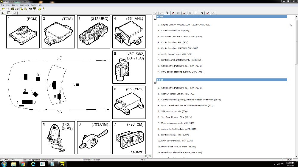

4 years 6 months ago #54671
by Smeter12
Replied by Smeter12 on topic CAN bus shorted - unplug modules or pull fuses?
Just wanted to update you guys on this post / question......
Here is what I thought was a shorted CAN bus. I attached my oscilloscope channels 1 and 2 to CAN high (i.e. #6 of DLC which was my Channel 1) and CAN low (i.e. #14 of the DLC which was my Channel 2). The wave form that I got for Channel 1 was a steady 2.45V as well as a steady 2.45V for Channel 2. So, based on the steady 2.5V waveform for Channels 1 and 2, I just assumed I was working with a shorted bus. After doing some research on the CAN topology of the 2012 Cayenne (i.e. I couldn't find any bus combs to work from), I decided the diagnostic approach I was going to use was "let's play unplugging the modules game!" The main problems with the 2012 Cayenne I was working on was (1) the ride height was not working and (2) the exterior lights did not illuminate. Unplugging a module in the RR related to the suspension got the vehicle to the proper ride height and the exterior lights worked once I unplugged the front BCM. However, after getting the suspension and the exterior lights working the oscilloscope still showed a shorted bus waveform at the DLC (i.e. 2.5V on both channels 1 and 2). I did some more module unplugging thinking that the job wasn't done until I had a proper CAN bus signal (i.e. 3.5V high and 1.5V low). Still nothing. Then I had a brainwave - the shop next door had a 2017 Porsche Macan as well as a 2016 Porsche Cayenne in for service. I scoped the CAN bus at the DLC (i.e. #6 and #14 of DLC) for both of these vehicle and had the same wave form (i.e. 2.5V for CAN high and CAN low). In other words, I had a 2012 Cayenne, 2016 Cayenne, and a 2017 Porsche Macan all giving me the same CAN bus waveform on pins #6 and #14 - 2.5V for both channels. When going to the wiring schematics for all 3 vehicles, you see that #6 and #14 of the DLC goes to the gateway module. So, how the heck do you get a CAN bus signal for these vehicles - go right to the module in question?
Again, thoughts appreciated and thanks in advance.

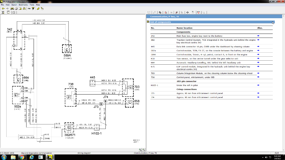

- Matt T
- Posts: 751
- Thank you received: 276
4 years 6 months ago #54748
by Matt T
Replied by Matt T on topic CAN bus shorted - unplug modules or pull fuses?
How a diagnostic CAN works isn't something porsche specific. The only thing you'll see on it is diagnostic traffic. If there ain't a scan tool connected and actively communicating it'll flatline. To see traffic on another vehicle network you have to connect to that network.
That CIM isn't drawn as a gateway. The "Instrument bus" is passing thru' it. Then passes thru' 736, hits a splice then goes to two other modules. To measure the "Instrument bus" you can 'scope anywhere on that network. DLC is the easiest for that particular network but at a module, or H102-1, would also work. Can even poke holes in the wires if you want.
382/671 is drawn as the gateway. "Instrument bus" and "powertrain bus" are connected by electronics in that module. Measurement of the "powertrain bus" can only be done on the wiring to the left side of that 382/671 module.
For example, a 2006 Saab 9-3 2.0T uses the CIM (pls see attached pic) as a gateway module to bus info between the "powertrain bus" as well as the "Instrument bus". On the 2006 Saab, you can obtain the CAN bus waveform at pins 6 and 14 of the DLC - not so on Porsche products.... OR... am I missing something??

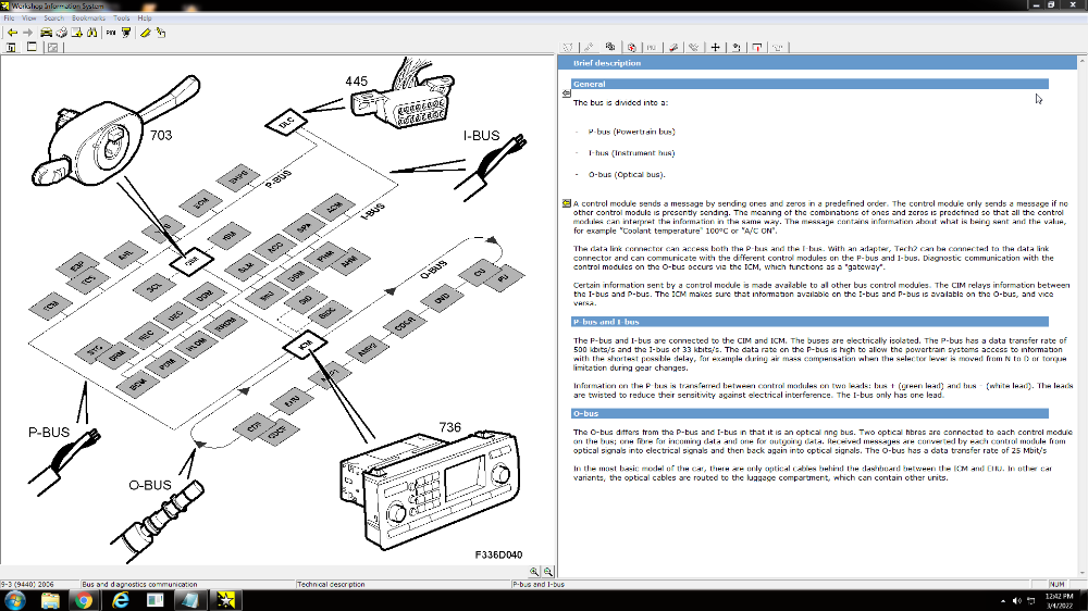

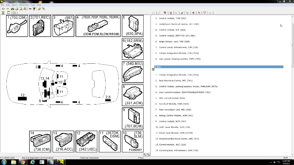

- Smeter12
- Posts: 58
- Thank you received: 4
4 years 6 months ago #54749
by Smeter12
Matt, I think the initial pic I posted (i.e. CAN bus wiring from DLC) was a little bit miss leading. Have a look at the next 3 pics - I think I made a mistake calling the CIM a gateway module. I now believe the ICM is the gateway module. Would you agree?

- Matt T
- Posts: 751
4 years 6 months ago #54753
by Matt T
I sure got misled!! After squinting at the first pic even harder it's just the powertrain network and the 382/671 module is drawn as pass thru'.
Reading the description on the last image you posted it appears the vehicle has three networks. HS-CAN P-Bus and a single wire I-Bus, which are both connected to the DLC, and a fiber optic O-Bus. The I-Bus might be GM SW-CAN??
Sounds like the ICM is one of two gateways on the vehicle. It handles P-Bus <> O-Bus and I-Bus <> O-Bus traffic. It also allows scan tools to communicate with the O-Bus via one of the wired networks.
The other gateway is the CIM which only carries P-Bus <> I-Bus traffic.
