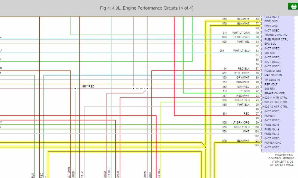

9 years 7 months ago #7242 by toadyboy1957
Replied by toadyboy1957 on topic Re:1996 Ford F 150 4.9 L6
i checked powers at the PCM all powers are good but no grounds AND the orange blue wire is dead inside the PCM
9 years 7 months ago #7245 by Ben
Replied by Ben on topic Re:1996 Ford F 150 4.9 L6
Are you saying you are missing grounds to pcm?
  • toadyboy1957
  • toadyboy1957's Avatar Topic Author
9 years 7 months ago #7246 by toadyboy1957
only 1 ground from battery negative to thr ground terminal to pin 104 oh PCM no operational grounds otherwise i have checked thus far all takes time as you know dont want to condemn PCM TILL IT HAS BEEN ALL CHECKED AND VERIFIED
  • toadyboy1957
9 years 7 months ago #7247 by toadyboy1957
I have no grounds to the 3 solenoids i was asking about earluer i have no grounds to the 3 heated o2 sensors no ground for this orange nlue fuel pump control wire i have ground to the PIP wire for the ignition and i have ground to the TPS IAC and the ground i have provided for the fuel pump relay to make iyt run all powers and grounds are good to all lighta and accessorues other than that

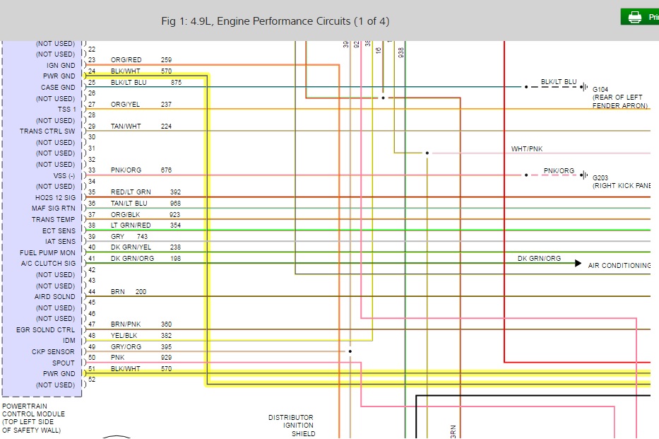

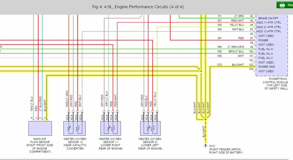

9 years 7 months ago #7264 by Ben
Here are the ground locations I'll get the ECM diagram shortly
9 years 7 months ago #7266 by Ben
Pin 25 blk/lt blue is g104 it looks like the rest of them ground at g101
9 years 7 months ago #7267 by Ben
What doesn't make sense is that pin 103 you do have ground but it grounds together with pin 76 ,77 ,51 and 24
9 years 7 months ago #7268 by Ben
Clean your g101 ground strap and maybe add a jumper to the battery ground just to be sure you have a good ground if you're in the rust belt like I am it wouldn't surprise me if the body ground was bad as well
