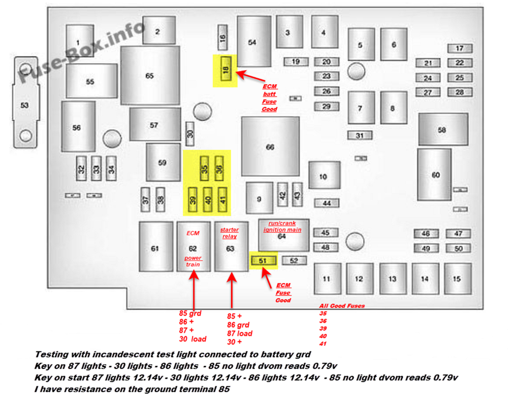

2010 chevey equinox 2.4 L, no crank, no start, U0100 P0615 P1682
  • stspringer
  • stspringer's Avatar Topic Author
5 years 3 months ago - 5 years 3 months ago #49717 by stspringer
I was testing relay 62 the ECM /Power train relay. I am trying to upload a larger photo
Last edit: 5 years 3 months ago by stspringer.

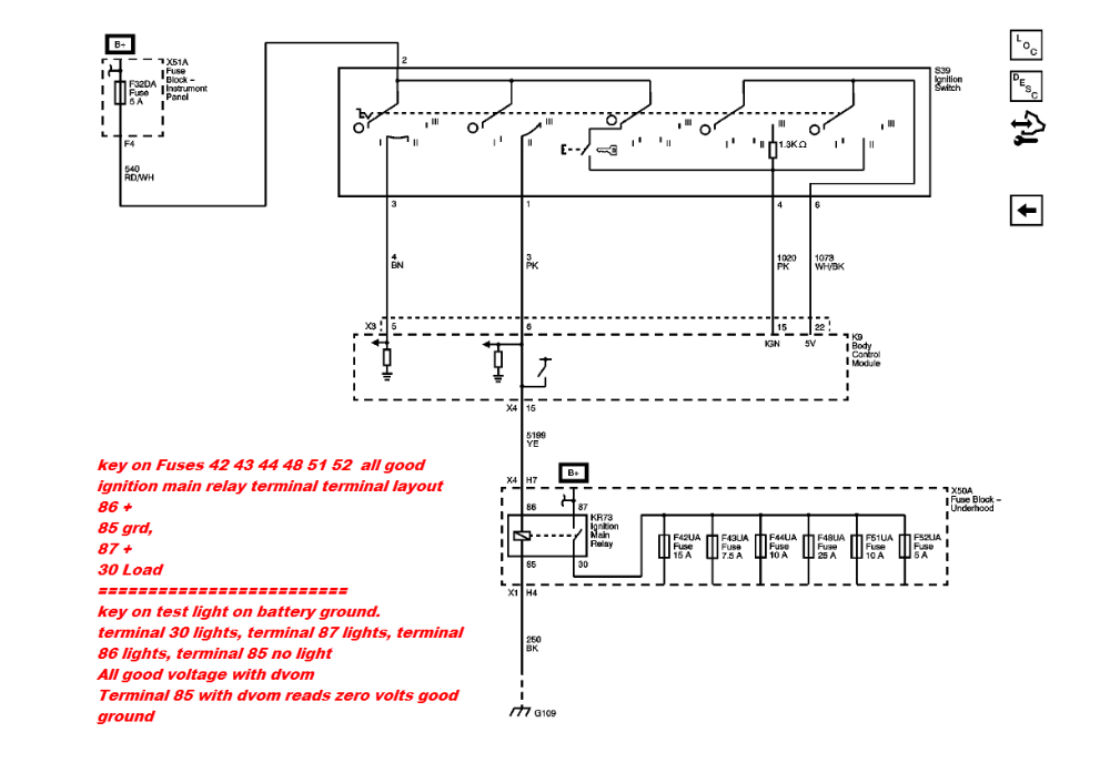

5 years 3 months ago - 5 years 3 months ago #49720 by stspringer
My tests on the ignition main relay #64 Please see attachment photo

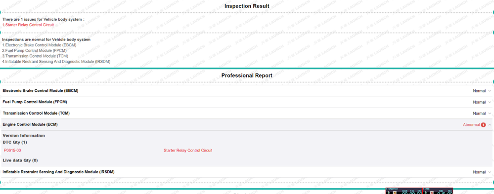

5 years 3 months ago - 5 years 3 months ago #49726 by stspringer
I cleared the codes and ran diags again and just got  P0165 back
5 years 3 months ago #49798 by Wightscope
go back to the starter relay and test voltage from Batt -ve to term 86 -whilst cranking with relay in.
If you have anything much more than 0v you have a bad earth.
