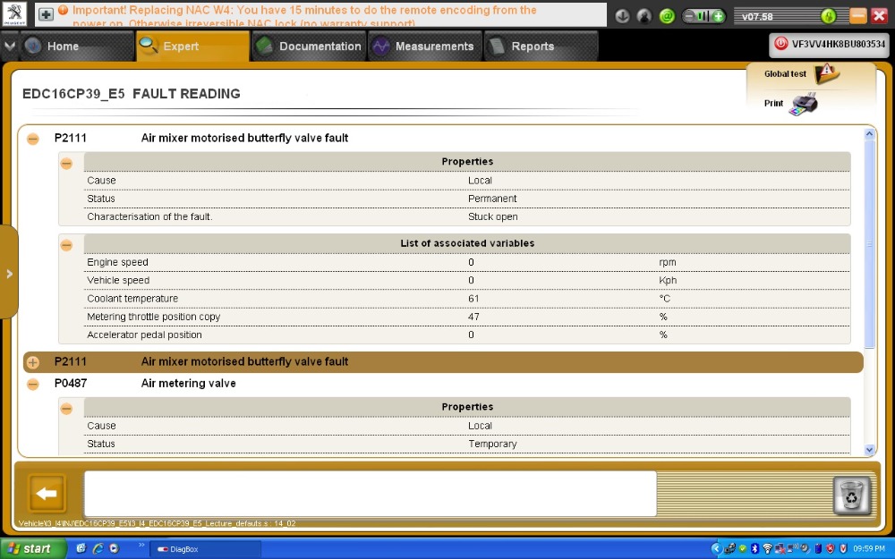

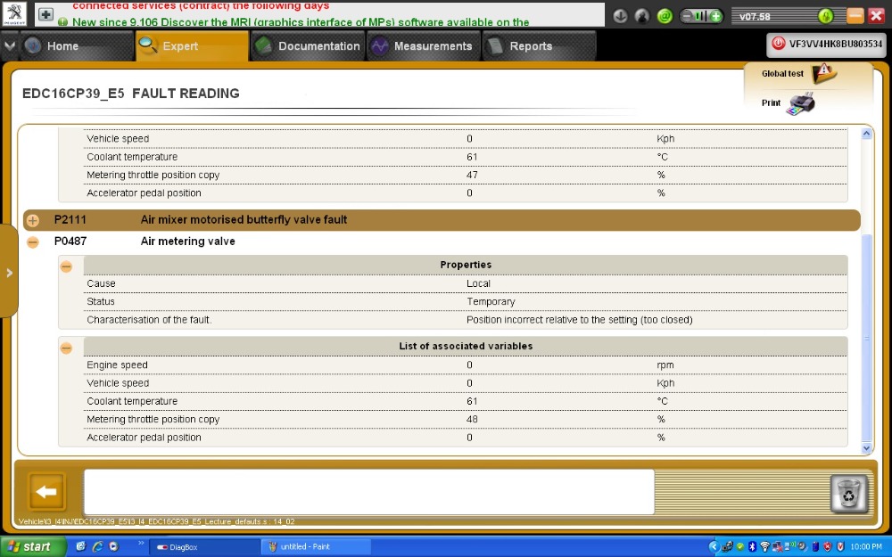

I have managed to spend some more time on the car this evening.
I checked the Resistance a pin 1 & 2 of the throttle body, unplugged at the component and i'm only getting 1.1 Ohms, AutoData quotas I should be seeing 3 Ohms.
I am seeing the voltages you describe on the pink and purple wires, Im not getting anything from Pin 1 (Green) other than slight voltage between .05 - .33 both with the ignition on and at idle.
I read the codes using DiagBox instead of the Verus Pro before taking any live data and the codes are as follows:
P2128 - Air Mixer butterfly valve position repeat fault
P0237 - Supercharging pressure sensor
P2111 - Air mixer motorised butterfly valve fault
P0488 - Air metering valve
I took a small video showing air flow and metering position readings using DiagBox:
I cleared the codes but have not checked them again following taking the video, I'll do that now and update the post.
Cheers
EDIT: DTC's Attached in screenshots

WellI I would say that as you are seeing the PWM signal come into the throttle/butterfly, the resistance measurement is out on the motor and the ECU is saying there is a fault with it, then there are strong odds that it is faulty.
I would just double check that the "Air Mixer butterfly valve" is the part you are looking at.

I know it’s been a while but thought I would provide an update. The delay in progressing with this was due to finances, or lack of, however, based on the data a collected and the readings from the butterfly motor, plus the trouble Code pointing to the throttle body/butterfly, I took the risk and purchased a new throttle body, fitted it this evening and took it for a drive, got it up to temp and all appears good. I’m going to give it a few days of driving before I draw a line under it but up to now it looks like it’s fixed.
Yeah, I’m mobile again.
Took a resistance reading from pins 1 & 2 of the new throttle body to compare and was getting 6.7 ohms, higher then Autodata said it should be but very different from the old one.
