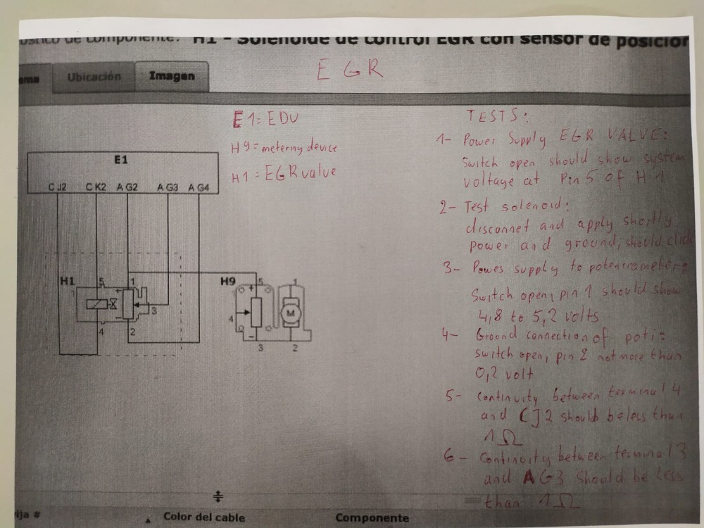

4 years 10 months ago - 4 years 10 months ago #49585 by juergen.scholl
Replied by juergen.scholl on topic Wiring Diagram Peugeot 4007
The picture shows the EGR circuits and some tests, hth.
Last edit: 4 years 10 months ago by juergen.scholl.
  • Nelixuk2003
  • Nelixuk2003's Avatar Topic Author
4 years 10 months ago #49606 by Nelixuk2003
Replied by Nelixuk2003 on topic Wiring Diagram Peugeot 4007
Wow, this is super helpful, I will get those test/checks ran over the next few days. Forgive my ignorance but can you clarify what you mean by EDU, I am not sure what this translates to or where it is unless you mean the ECU, if you meant the ECU I would expect to see more detailed diagram.
Thanks again for this and I will report back

4 years 10 months ago #49608 by juergen.scholl
EDU often is the name for Electronic Diesel Unit, it's the equivalent to an ECM on gasoline equipped engines.....
This is the EGR section of the EDU/ECM diagram. The whole diagram is broken into different sub-systems, I do not have an entire diagram with all the components in one drawing. Each component comes seperately.

Well, I've managed to have a little poke around and have managed to take some readings.
According to AutoData, I should be getting 5v with the IGN on at pin 1 of the throttle body, I should also be getting 5v at pin 1 while idling, I'm not even getting 1v with the IGN on and nothing at idle, I get 12v after switching the engine off.  See the linked Vid below.
With the throttle body unplugged I should get 3 Ohms between pin 1 & 2 (the motor), however I only get .9 ohms and even if I move the butterfly manually I only get a max of 1.5.
Are there any other checks I can perform before before committing to replacing the Throttle body?
4 years 10 months ago - 4 years 10 months ago #49691 by Wightscope
Replied by Wightscope on topic Wiring Diagram Peugeot 4007
Are you testing with the actuator unplugged or plugged in, what wires are you connected to ?
I think you might be misreading the data, it says 5v/div scope setting, not that you are expecting 5v.
The 12v pwm signal at the end is the shut down self clean. If it is ground side switched  it may have full ground when "at rest" ign on fully open  so you would see 0v on the ground side of the motor and 12v on the other side. Or vice versa if it is power side switched.
If you see a change in resistance when you move the butterfly you are not measuring the motor you are measuring the position sensor
Don't condemn the TB until you are certain it is getting all the correct inputs. - or more likely that it is not outputting it's position correctly.  I would scope the output voltage at the feedback sensor and make sure you are getting two smooth voltage curves on actuation.
