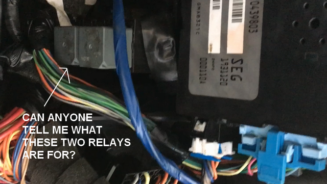

Possibly Solved....I need help identifying 2 breakers under passenger side of dash. When I flipped them after my test drive one of them was pretty hot. I think this could be involved in a 5v issue if they aren't plugged in correctly. Years ago, after the "electrical expert" had it, the module these two breakers was plugged into was hanging and I plugged it into the clips that hold the module in place. I also put black tape around the relays to keep them from coming loose. However, I never took them out and flipped them around until the other day and then I put them back the way they were because I figured I didn't solve the problem. Today I flipped them and my gauges did not go nuts since and I don't hear any fuel pump and relays and injectors flipping out while the key is in run. They did when I was shutting off before I flipped them.
I cleaned up and made grounds better through all of this but I do not think the grounds were my problem. I think my original problem its related to this. Thank you to everyone who has responded to my posts to help me think this through and not give up even though I was ready to throw in the towel.

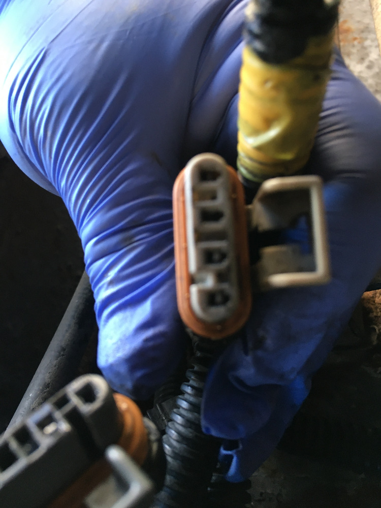

I feel that I need to crack open the PCM before I do anything else and try to do a video showing the two pins (inside one of the plugs not on the PCM) that I see are pushed back. I think one of them may actually be pin 1&2 that If I understand correctly is ground on this attachement. I feel like I need to correct those pins but I do not know how to get in to do that correctly without screwing up other pins. I am not sure pins are the correct term. If I remember correctly they are inside the clear terminal plug as there is a big terminal plug that is clear and one that is blue.
Last edit: 4 years 11 months ago by Sopey52.
4 years 11 months ago #48147 by 70monte
Replied by 70monte on topic Could this be root cause?
If those pins are pushed in, they are probably not making contact and will cause problems. Whether they are related to your running issues will be determined by which circuit those pins are for.

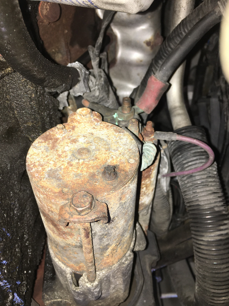

How old is your starter? You could have some internal electrical problems with it that could prevent the vehicle from starting.

Have you tested the power and grounds to and from the ignition switch? A bad one can cause intermittent start and dying problems.
Transmission range switch can also cause these problems.
At this point I highly doubt it's any of those grounds that you have continually messed with. You probably need to go away from that and focus on doing some testing at the components I mentioned. You need a good wiring diagram of the starting system.

4 years 10 months ago #48636 by Hardtopdr2
Replied by Hardtopdr2 on topic Could this be root cause?
That's a one way diode not a fuse (dark black fuse with arrow) fyi
The following user(s) said Thank You: Sopey52

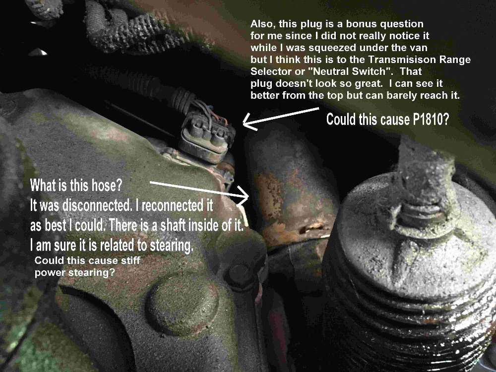

4 years 10 months ago - 4 years 10 months ago #48947 by Sopey52
FOLLOWING UP. I am in agreement with Matt T that the secondary air pump does not exist on my van. Even though the Haynes Manual says it is there, I got underneath the van and I cannot find the pump or the solenoid where the manual says it should be. Advanced Auto cannot get the part to show up for 2003 Chevy Venture FWD. If I search on Amazon, I either get the "this part does not fit your ______" or I get a part without "this part fits your ____". So I am going to ignore those codes.
What I need to resolve is P1810 which has come back and with some hard shifting. This seams to happen only if I run the van in D. If I run it in 3 the problem does not happen as far as hard shift but I still get a code. I found a video showing someone who had a Customer with a Cobalt who replaced his transmission due to that code and still had the problem and it ended up being shorted signal wires....he did not need a transmission. I hope I can find something like that again.
I also need to resolve my power steering pump issue where I may have created the problem myself by deciding to use a power steering pump from a Pontiac Montana (I took the PCM from it) because I did not want to spend over $100 for a pump if I was not going to be able to resurrect this van. Currently I have been bleeding the system and using the thick Lucas Power Steering Stop Leak. I do not believe I have a leak anymore but I am hoping this resolves the noise and stiff turning on slow turns and so far it seems to be working. I am making progress as the pump is getting quieter but slow turns are very stiff.
FINALLY, I have attached a photo of a hose that attaches over a connection behind a driver side tie rod. There is a shaft inside that hose and the hose was completely off. I took this photo after I did the best I could to put the end of the hose back onto where it is supposed to connect. The van was not on a lift when I did this. I was under the van after I drove it up a makeshift ramp of boards. I would like to know what this is called and if it has any relationship to my power steering issues. Is it a vacuum hose or just a dust cover for the shaft. I am not a mechanic so I do not know what everything is and just learn as I go. Thanks for your time.
Last edit: 4 years 10 months ago by Sopey52.
