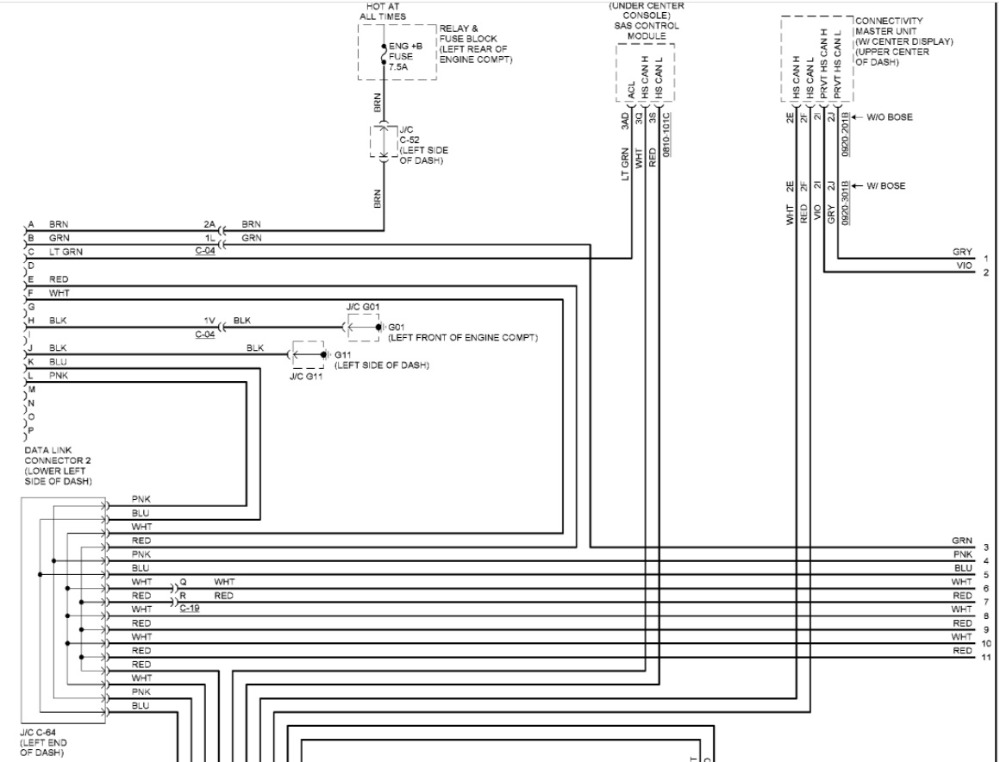

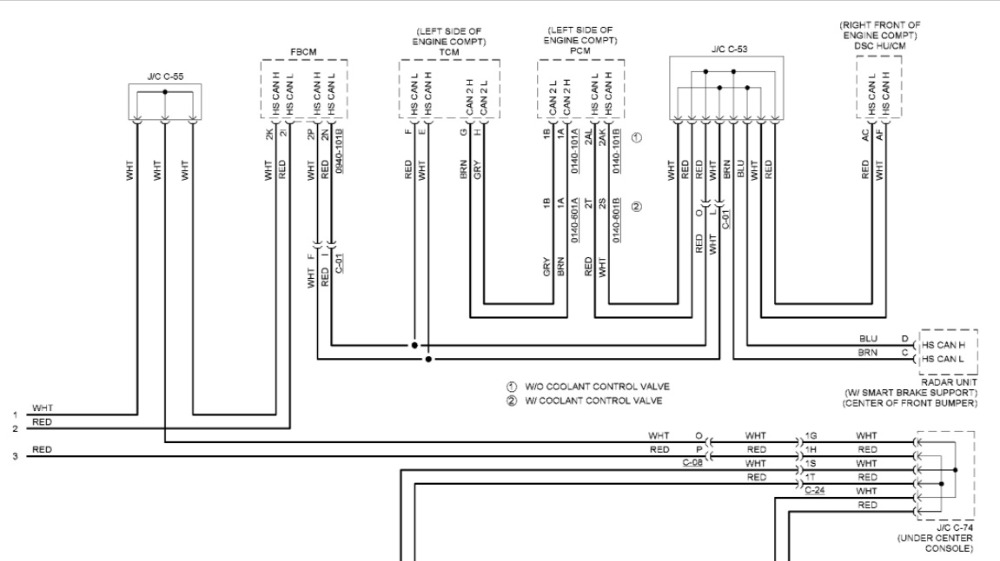

5 years 9 months ago #46004 by RJMARRA
Replied by RJMARRA on topic 2018 Mazda CX-5: no crank, no start
Did you try checking the MAF for 5V ref with it unplugged? Not sure on that model if it needs to be unplugged our not. Maybe even confirm 5v ref by checking it on the TPS?
  • RJMARRA
  • RJMARRA's Avatar
  • 2018 NAPA/ASE Parts Specialist of the Year
5 years 9 months ago #46005 by RJMARRA
also check your grounds at odb2 connector. Diagram attached.
The following user(s) said Thank You: vallis
  • RJMARRA
  • RJMARRA's Avatar
5 years 9 months ago #46007 by RJMARRA
also it doesn't appear that the pcm is the gateway
