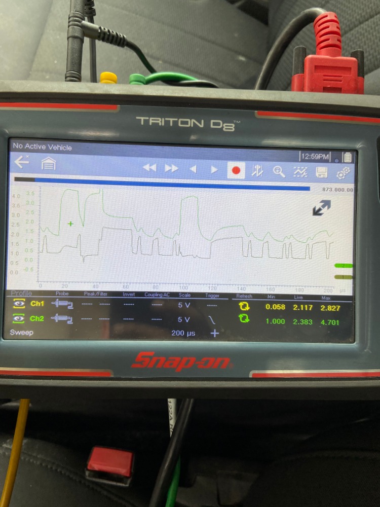

Quick update. Had about 30 seconds between jobs today to look at this.... with all modules plugged in using piercing probes inside the truck, battery unhooked- I have 119 ohms on can c. Attached is a quick pic of the waveform. Its ugly. As Chad suggested- I think its time to start checking grounds on every module. Would still love to know where these resistors are located. Not sure why they are not shown in any diagram I have yet to look at in shopkey.

It sounds like you are missing one of the modules that has a terminating resistor. Some service info digging on the can system might help find which modules have the resisters so you can start your tests there.

What changed? 60 Ω is a good measurement. 119 Ω (120 Ω), as Tutti57 pointed out, indicates a missing Termination Resistor.
According to SI, Termination Resistors are located in the Power Control Module (PCM) and the Wireless Control Module (WCM).

Pins 6 and 14 are the diag network . The can c network is my issue. Thanks for info. So- if I measure resistance on wcm unplugged I should have 120 ohms and 120ohms at the pcm?
