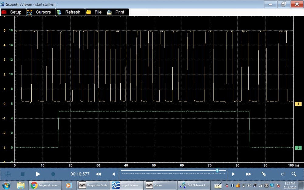

We replaced an engine in a 2014 dodge grand caravan for an overheating concern. once replaced the van will start/stall. after a bunch of start/stalls it finally will start but throws a p0335 DTC. data display shows crank signal is present but showed crank sync false so i performed a cam/crank re-learn. vehicle started fine after that, crank sync was ok and no more p0335. Next day... Same thing. start/stall with p0335. I scoped the crank signal and looks like nothing is wrong with it. Engine is a brand new Long Block from the dealership parts department. =/

I'd be very interested to see what the CKP waveform looks like during your start/stall. Grab one of the CMP's for reference.

6 years 1 week ago #43061 by ptebo1
how could i maybe send you a vsm file? is the ckp signal only drops to 0.2 volts. is that enough to create an issue you think?
  • ptebo1
  • ptebo1's Avatar Topic Author
6 years 1 week ago - 6 years 1 week ago #43062 by ptebo1
<<< the issue is actually present in this waveform,, if you count five of the lower dips over from the right you will see the smaller gapped wave....

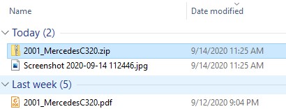

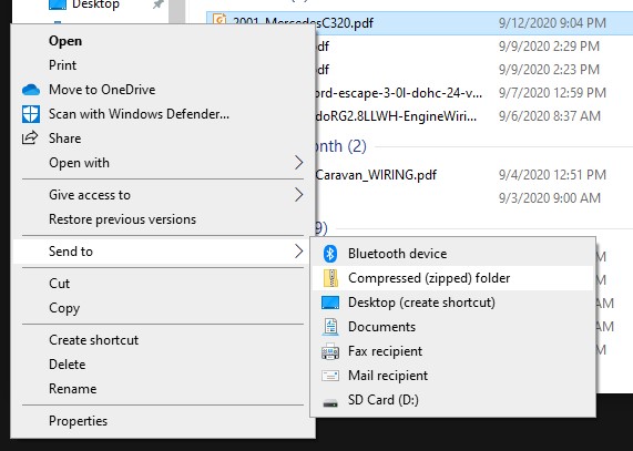

6 years 1 week ago #43072 by Matt T
ptebo1 wrote: how could i maybe send you a vsm file? is the ckp signal only drops to 0.2 volts. is that enough to create an issue you think?
There looks to be a lot of variation in your CKP pulse and dwell lengths. Kinda like rpm is moving up and down a lot. Is the engine cranking normally?
To attach a *.vsm file first off close it out in shopstream. Then go to the folder where the file is stored. Right click the file and that should bring up a menu with a "Send To" option. Expand it and click "Compressed Folder".
That will create a filename.zip folder which contains a copy of your filename.vsm file.
You can then attach that filename.zip to a post the same way as you would a picture. Only add it as a file. You don't need to insert it into your message.

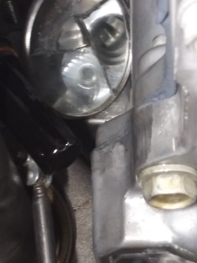

6 years 1 week ago - 6 years 1 week ago #43097 by ptebo1
so i sat down at my bench after hours today. studied the start stall waveform and noticed tooth 21 after the sync is shorter every single time. i pulled the ckp sensor, inspected tooth 21 and i seen a bent tooth on the flywheel. i took a pic the best i could. if you look close you can see the gap is smaller at the top of the 2 teeth... this thing came as a long block with no oil pan. i think the heavy line guy that installed the engine set it on the crank when he was getting it off the pallet. Made my life a living heck. Must be nice to install an engine and walk away from it when it doesent start...
<< you can actually see the issue in the waveform pic. if you count 5 dips over from the left you will see the smaller gapped wave...>>

6 years 1 week ago #43117 by Tyler
ptebo1 wrote: you can actually see the issue in the waveform pic. if you count 5 dips over from the left you will see the smaller gapped wave...>>
I see it. B) Well done, sir.

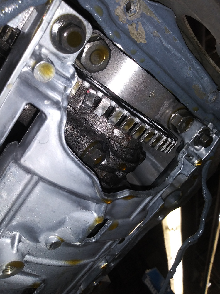

6 years 1 week ago - 6 years 4 days ago #43126 by ptebo1
Sorry the picture is so bad. Im replacing the engine in it tomorrow so once its off ill take a way better pic with the oil pan off since i have to swap them. It is actually the crankshaft, the teeth are part of the casting, which is literally thee reason i didnt inspect it earlier in the game. Wish it woulda broken it off instead of just bending it, I probably woulda seen that in the 1st scope shot i got of it.
Last edit: 6 years 4 days ago by ptebo1. Reason: upload photo of bent tone ring on crankshaft
6 years 1 week ago #43129 by Tyler
ptebo1 wrote: It is actually the crankshaft, the teeth are part of the casting, which is literally thee reason i didnt inspect it earlier in the game. Wish it woulda broken it off instead of just bending it, I probably woulda seen that in the 1st scope shot i got of it.
Heavy line guy has some explaining to do, IMO. :angry:
I suppose you could try just bending the tooth back? :silly: I'd try it if it were my Caravan, but it isn't.
