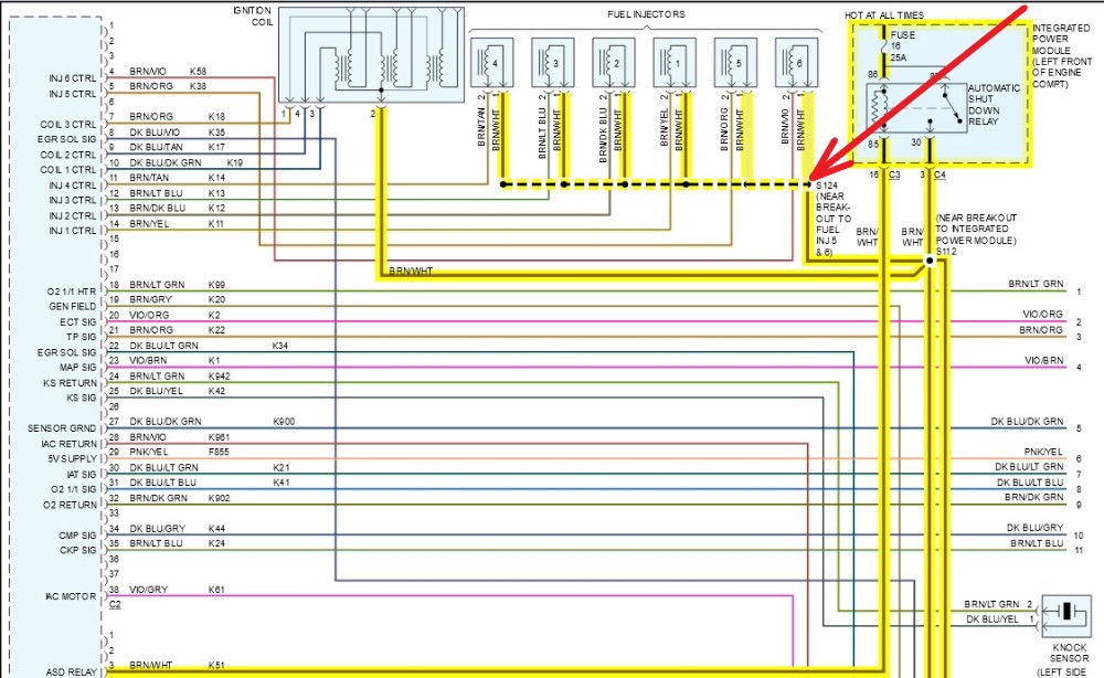

Awhile back you answered on my post , 05 dodge caravan SXT 3.3L . Crank , NO start, possible no power ta the injectors. I have been doing what I can , do to weather, health and ability... I hope i can explain where I am now good enough. OK .. I followed you advice and diagram you sent. I have also paid to use Mitchell DYI and bought a owner manual. With that being said, here we go.. I have checked for power at injector #6 and the is nothing. I have SPARK on the coil, but no power to injectors.. I pulled the fused and found that the test lights lites on 86 & 87 on 30 & 85 I have nothing... this is how it's laid out.. 86 30
87 87a 85
I have tested the BR/WT wires at the PCM.. Natural/White connector: PINS 3,19 & 28 the test light pulse/ lites at 19 & 28. I didn't really test pin 3 cause It connects to the 86/87 side of the ADS relay which lites the test light.. I'm a little unsure what or where to go know. This is my thinking...There is a Splice ( S112) that pin 19 & 28 connect and feed the relay, injectors and coil.. Well, If my thinking is correct. the my problems lies somewhere in that SPLICE, between the ADS relay and the injector weed wire, cause the feed wire from that splice gives power to the coil for the SPARK and I have that.. If that above is correct , this is where I get confused...Pin 3 is K51 (PCM) and it connects to Pin 16 (IPM/ ECM)C3 . which give juice to the 86 & 87 ok , but K342 Pin 19 & 28 (PCM) SPLICE into (ONE)? BR/ WT wire and it goes into C4 BLUE PIN 3 (IPM/ECM) ? ??? NOW confused again... I have put a connector to the back of C4 BLUE and the test light lites... IS THIS MY PROBLEM?? DO I HAVE A BROKEN WIRE SOMEWHERE ?? I have looked up wire diagrams and things trying to understand all of this.. I would truly like to know if and what to do next.. Or even if my thought process is right.. I have pulled the connector from ICP/ECM out and looked just for problems . To a untrained eye they look good to me.... ONE STEP CLOSER Thank you for your help and sorry it's taken so long to get back to you on this.. Have a BLESSED DAY !!
Last edit: 5 years 11 months ago by Peaches. Reason: missed something
5 years 11 months ago #43579 by Matt T
Peaches wrote: There is a Splice ( S112) that pin 19 & 28 connect and feed the relay, injectors and coil.. Well, If my thinking is correct. the my problems lies somewhere in that SPLICE, between the ADS relay and the injector weed wire, cause the feed wire from that splice gives power to the coil for the SPARK and I have that.
It sounds like your problem is either S112, S124 or the wire running between them. Just based on the description of S124s location that might be the easiest point to test first.

I'm not finding S124.. either my diagram are not as good as yours or I'm blind.. I will look more I know I have seen it somewhere. Thank you for confirming my diagnoses... This is all very new to me.. Will up date soon..
5 years 11 months ago #43581 by Matt T
S124 is shown on the diagram Chad posted. Sounds like it'll be located close to where the harness splits off to each bank of injectors.

DUH... LOL I knew I seen that number somewhere.. Thank you.. So I can.t find it on a wire diagram but I guessing it lives very close to the injectors on the back side of the motor. Thanks again Matt T...

Peaches wrote: Good morning EVERYONE,
87 87a 85
The ASD control (pin 3) on the PCM provides ground to the relay coil not voltage. The relay itself is fed directly from the fuse box and fuse 16. Unplug connector C102 at the fuel rail and check for corrosion or damage. That would be the quickest and easiest check but keep in mind not all caravans are built with this connector.
