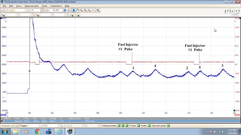

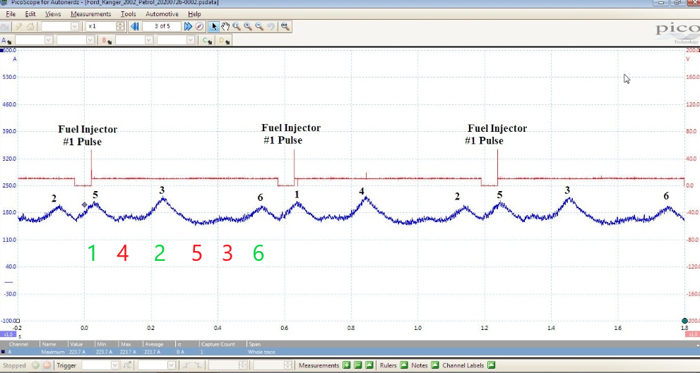

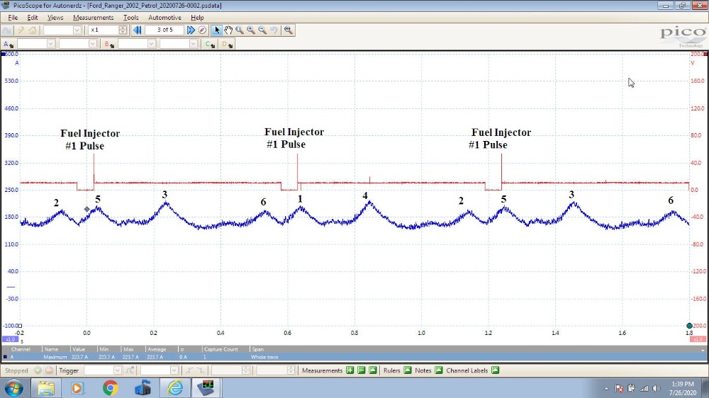

6 years 3 months ago #41707 by Smeter12

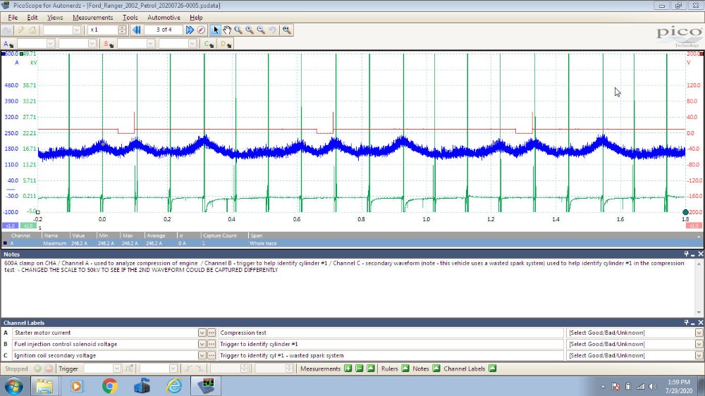

Following up on Tyler's suggestion of "use mode 06 and check Test ID $53" to see how bad the misfires are - logged into mode 06 through the Ford IDS and found it really wasn't helpful for misfire counting while the IDS was hooked up through my laptop. Then I tried the good old Scanner Danner water test - sprayed the intake system [i.e. MAF area; intake piping; upper plenum; and lower plenum (as much as I could get at it with no hoist)] down thoroughly and could not hear any water being sucked in.
As for the VE test - I wasn't really confident that I was getting good numbers from my MacMentor noting how the VE test showed 99.6% while being logged into Global OBDII. At idle, while being logged into Global OBDII, the MacMentor should a VE of 51%. Thus, I used my VERUS to challenge the VE test. I logged into manufacturer specific (on my VERUS) and logged the PIDS RPM, MAF (g/s); IAT; and Baro (in Hg). Once I did a wide open throttle in 2nd gear, I plugged the respective numbers into a VE calculator and got a VE test result of about 82%. Considering how my engine was running, this was a more plausible result. Nonetheless, with a 82% result you are in a grey area - does the engine indeed have a breathing problem or is there a MAF, intake plumbing, and/or valve train issue.
In an effort to check compression (i.e. eliminate a potential valve train issue), I performed a relative compression test with my Picoscope. The result of this test are attached in 4 pics. Here are my questions from attached 4 Picoscope pics:
A few things to keep in mind while looking at the 4 attached pics:
- firing order is 1-4-2-5-3-6
- when looking at the 4 attached pics, I am assuming that have I labelled the peaks (i.e. power stroke / fuel spraying) properly. Please remember, the fuel strategy of the Ford 3.0 V6 PCM sprays the fuel injector 2x every crankshaft rotation while cranking (i.e. when engine speed is lower then idle)
Again, here are my questions:
1) Is compression on all 6 cylinders good (note - mileage on vehicle is about 162,000 miles)? I think it is, however I am not sure. The peaks of cylinder #2 and cylinder #5 are lower then the rest. During the compression test, battery strength was good, however, the starter motor was "okay" (vs excellent) for delivering turning power. Am I just dealing with a starter motor issue then rather then a compression issue in cylinders #2 and #5?
2) why is the amperage low for so long between cylinders #4 and #2 as well as #3 and #6 while cranking? Again, is the "okay" starter motor in this truck to blame for that part of the wave form?

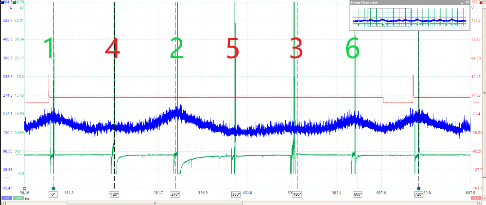

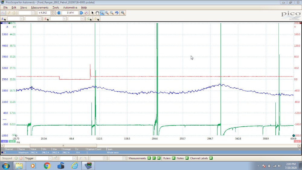

3) in pic 4, it seems the timing is off as the compression peaks of the cylinder no longer line up with the timing of injector #1 spraying. Again, is this the starter motor / battery dying off because I may have been cranking to long.
As always - thanks in advance for whatever the heck you want to share from that thing in between your two ears!
6 years 3 months ago #41710 by Matt T

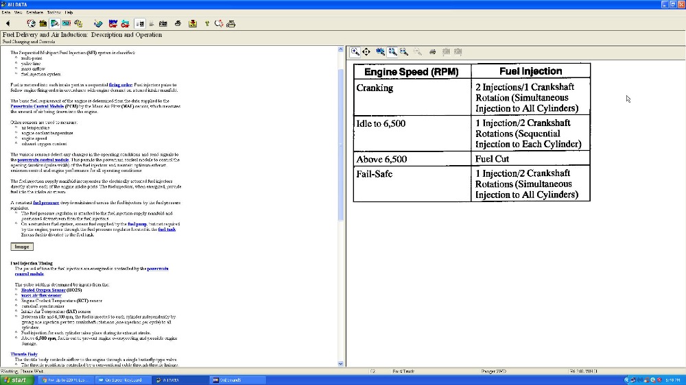

Smeter12 wrote: Please remember, the fuel strategy of the Ford 3.0 V6 PCM sprays the fuel injector 2x every crankshaft rotation while cranking (i.e. when engine speed is lower then idle)
If you're correct it'd be once per crank revolution not twice. But are you 110% sure about that cranking strategy? I'd be 'scoping the CKP, or a plug wire, to get a 2nd opinion on that one. If that injector pulse really is once per crank rev you're only cranking at 100 rpm. And I think I can see a couple weak compression attempts between the humps.....
Smeter12 wrote: 3) in pic 4, it seems the timing is off as the compression peaks of the cylinder no longer line up with the timing of injector #1 spraying. Again, is this the starter motor / battery dying off because I may have been cranking to long.!
That one looks mislabeled to me.
6 years 3 months ago #41711 by Tyler
Smeter12 wrote: Following up on Tyler's suggestion of "use mode 06 and check Test ID $53" to see how bad the misfires are - logged into mode 06 through the Ford IDS and found it really wasn't helpful for misfire counting while the IDS was hooked up through my laptop.
Sorry that didn't work. :( Do you recall what the values were for TID $53? If they're all zeros, then it's possible the crankshaft learning procedure hasn't been completed yet.
Did the IDS allow you to do the Cylinder Balance test?
82% out of a OHV engine is pretty good, IMO. :cheer: I wouldn't sweat that result at all.

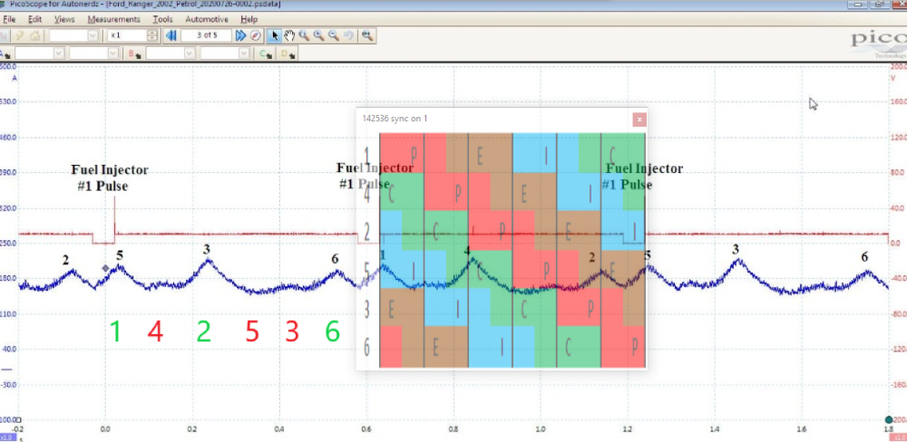

There's definitely a compression problem here. More than one. I don't know which injector you chose for a sync, but assuming injector #1, this is what I'm seeing:
I added in my own notations on the left, and a timing overlay on the right. I hesitate to get too scientific about this waveform, since I don't know which injector we're syncing off of. Using injectors for a relative compression sync is tricky, since injectors can fire at just about any time during the compression or power stroke, and not necessarily at TDC.
Speaking of injectors, how did you disable starting while you were taking this waveform?
I mean no offense here, but are you sure about that? :huh: Because I couldn't find anything about that in the Theory and Operation for this model year.
6 years 3 months ago #41713 by Hardtopdr2
I have to agree that cranking compression test looks like poo... to sync it properly i would use the cyl 1 ignition wave form rather than injector in this case. Because of the timing diference and with the injectors start to spray during intake stroke not during compression. So to properly identify the the cylinders repeat the test with ignition cyl 1 waveform. Then use the chart setup tyler is showing.
From the looks of it you have a valve issue going on weather it be valve lash issue or a few cam lobes wiped out.

6 years 3 months ago #41717 by Smeter12
Matt T,

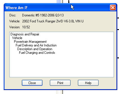

Yeah, you are right. I described the PCM's pulsing strategy of the fuel injectors incorrectly. Please see the attached pics to see the path I used in Alldata to find it as well as the description in Alldata. Thanks for pointing out that mistake.
Considering both your post and Hardtop2dr's post - I screwed things up in pic 4. Will take another kick at the can and repost my findings.

I would like to redo the relative compression test by sync the ignition system with cylinder #1 firing, but I am not sure how to do that on a wasted spark system on the primary side. If memory serves me right, there are only 4 wires at the ignition coil. Do I probe wire 1 (tn/wh) of the 4 pin connector to show when cylinder #1 is being pulsed on the primary side?
I disabled starting by pulling the fuel pump relay and then cranked the engine. There is now a little voice inside of me that says I screwed that up too - did I?

6 years 3 months ago #41730 by Tyler
Smeter12 wrote: I would like to redo the relative compression test by sync the ignition system with cylinder #1 firing, but I am not sure how to do that on a wasted spark system on the primary side. If memory serves me right, there are only 4 wires at the ignition coil. Do I probe wire 1 (tn/wh) of the 4 pin connector to show when cylinder #1 is being pulsed on the primary side?
That'd work. Unfortunately, being a waste spark system, that coil will get fired at #1 TDC compression AND exhaust. That means you won't be able to tell the difference between cylinder #1 and #5. :silly: That's what these kinds of sync probes are for:
www.aeswave.com/Trigger-Pickup-Inductive...antagePRO-p8662.html
If you have a secondary ignition pickup for your Pico, you can also use one of those on the spark plug wire for #1. You'll be able to tell the difference between #1 and #5 based on the height of the spark firing line.
Nah, that's fine. :cheer: I was concerned you had eliminated spark, and still had fuel spraying into the cylinders, causing your own compression issue.
If possible, a clear flood crank would be easier/faster. That'd eliminate injector pulse and possibly result in higher compression humps due to the throttle going wide open.

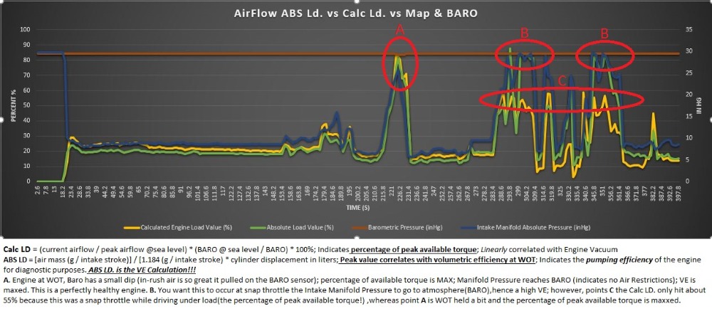

Awesome threads folks, I just want to clarify the airflow Pids for Smeter12.
Calc LD is not to be confused with VE. It is a measure of the Percentage of Peak available Torque.
ABS LD. Peak value correlates with volumetric efficiency at WOT; it indicates the pumping efficiency of the engine for diagnostic purposes.
ABS LD. is the VE.
For example, you perform a WOT run and the ABS LD doesn't MAX out, there is an air restriction. Also at WOT,. the Intake Manifold Pressure should rise to meet the BARO which is Atmospheric pressure. Makes Sense? The throttle plate is wide open, the pressure should equalize to BARO as fast as possible. So if your BARO is 29.92 InHg and on a WOT test you can't achieve more the 20 InHg, you've got an Air Restriction that needs to be diagnosed, whether its an Intake Restriction, Valve Issue Restriction, or an Exhaust Restriction.
I hope this helps you.

Weycraze wrote: So if your BARO is 29.92 InHg and on a WOT test you can't achieve more the 20 InHg, you've got an Air Restriction that needs to be diagnosed, whether its an Intake Restriction, Valve Issue Restriction, or an Exhaust Restriction.
l
An exhaust restriction will make the MAP reading go....HIGH!
6 years 3 months ago #41776 by Paul P.
Good thing someone is paying attention!
jeurgen.scholl you are absolutely correct! Thank you very much, I should have been more clear on this instead of listening to my train of thought while typing.
When there is an exhaust restriction, the MAP value will equal atmospheric value as soon as the throttle plate is opened and the engine fails to accelerate.
My description is misleading in dealing with known good.
Again, thank-you for the clarification.

6 years 3 months ago #41778 by Matt T
Smeter12 wrote: But again, the 2 injections per 1 crankshaft rotation seems to be good info.
Alldata is obviously wrong on this one. That injector definitely ain't firing every 180*. The way you numbered the relative compression traces is with the injector firing once per crankshaft revolution. That makes it look like you have some compression on all 6 cylinders.
What the rest of us are seeing is a normal SFI injector pulse once every two crank revolutions on an engine with serious mechanical problems.

6 years 3 months ago #41797 by Smeter12
Tyler,
I did take a capture of my secondary waveform from cylinder #1. Please see the attached 2 pics as well as the actual PSdata file from Picoscope.
I haven't got a clue at what I am looking at as I am new to wasted spark as well as Picoscope. I am assuming the secondary waveform capture is proper. If so, Tyler, can you give a few comments as to what I am looking at?

Matt T wrote: "That injector definitely ain't firing every 180*".
Not sure I understand. It is not unreasonable for a manufacturer to spray all injectors every half turn of the camshaft (i.e. one full turn of the crankshaft) when trying to get the vehicle started.... respectively.... am I missing something?
6 years 3 months ago #41800 by Tyler
Anyone else is welcome to call me out on my BS, but this is what I see in your waveform:
It's tough to say which cylinder is which based on the secondary waveform, because the 50kV scaling cuts off the peaks of the firing lines. It's the peaks of the firing lines that helps us determine if the spark plug is firing on compression or exhaust. Compression in the cylinder or not.
I borrowed this page from Paul's book for reference:
At this point, I think you have enough evidence to justify pulling plugs and manually testing compression/leak down on every cylinder. And that's coming from someone that hates manual gauge testing. :( But sometimes there's no substitute.
