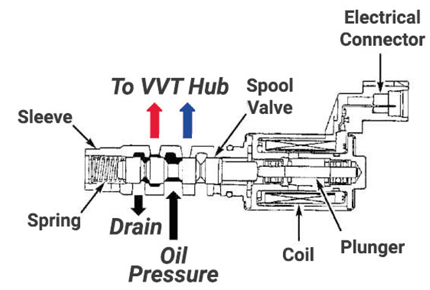

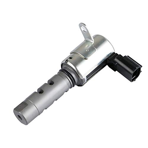

Is your scan tool bidirectional? If so perform an actuator test for the VVT. I'd like to know if it stalls. You can also unplug your OCV see what it does. Normally nothing. I've seen maybe 1 of these engines that throw a P1349 and eventually changed the valve or cam phaser. These can stick. But don't change anything so far.

OCV is the oil control valve that regulates the oil flow to the cam phaser on the intake.
