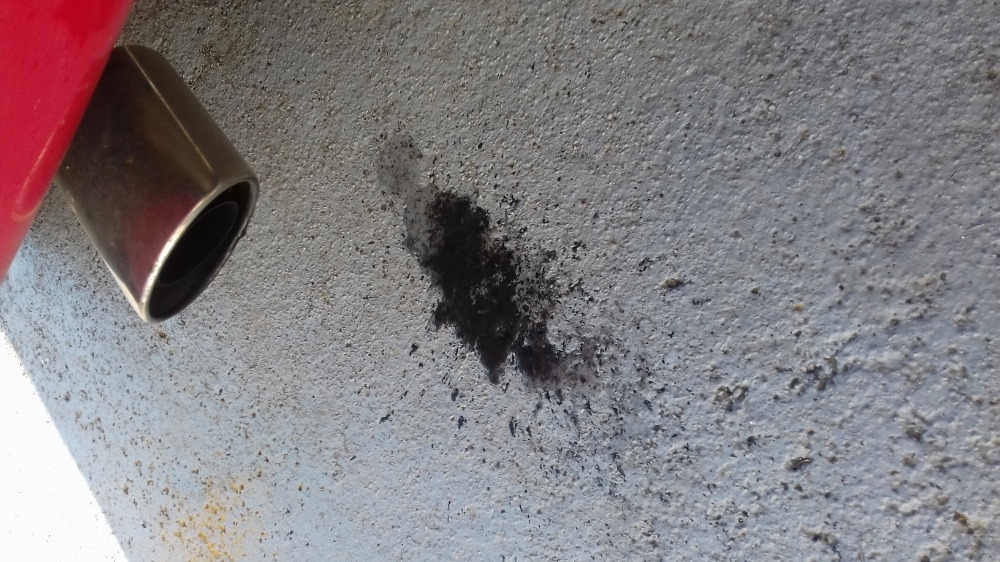

5 years 6 months ago #38546 by kamiwolf0893

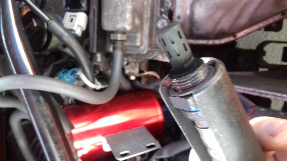

Hi, I've uploaded some images of the scan data you asked for. I will be adding some more pictures soon of the o2 sensor in the manifold and the vacuum gauge reading. Also some black looking liquid appears to have come out the cat.

5 years 6 months ago #38549 by Tutti57
You can try pulling the front o2s out of the exhaust when it is acting up to see if it runs better. that would indicate a plugged exhaust.
Nissan Technician

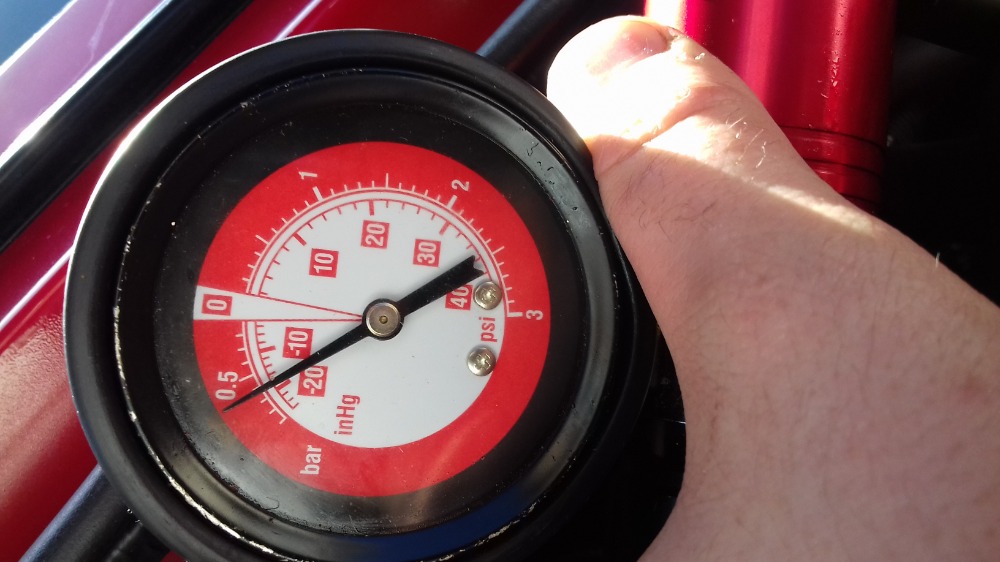

5 years 6 months ago #38550 by John Curtis
kamiwolf0893 wrote: Hi, I've uploaded some images of the scan data you asked for. I will be adding some more pictures soon of the o2 sensor in the manifold and the vacuum gauge reading. Also some black looking liquid appears to have come out the cat.
imgur.com/a/HWfr677
Adam
If the needle is steady then you’re in good shape. If you have the gauge hooked up and hold throttle steady to 2500 or 3000 rpms and see a slow decrease in vacuum over the course of 10 to 20 seconds you have a restriction. It should jump back really quick and hold steady if there is not a restriction.

  • kamiwolf0893
  • kamiwolf0893's Avatar Topic Author
5 years 6 months ago #38551 by kamiwolf0893
Hi, thanks for the reply. Ive just tried it without the o2s and misfire had gone. Its come back now but given the o2s are unplugged thats probably due to a rich condition now?

5 years 6 months ago #38552 by kamiwolf0893
The guage stays steady even holding at higher rpms. Will give it a test drive now without the o2s.

Have just reinstalled sensors and initially its idling smooth. Roughening up now
5 years 6 months ago #38560 by Tutti57
you have the o2 sensors actually unscrewed from the exhaust and not just unplugged, right?

5 years 6 months ago #38561 by kamiwolf0893
Correct, I unplugged and removed them from the manifold and felt the car was running better initially, turned the engine off and plugged them back in, screwed them back into the manifold. The misfires disappeared for about 20 seconds. It seems like a restriction.
5 years 6 months ago #38605 by kamiwolf0893
So i ran a backpressure test with the correct tool. 0 psi backpressure, all connections were tight and secure and the guage moves under snap throttle but not very high. I have however just pulled an ignition coil and plugged it into a spark tester (dont know the right name), the spark was wispy thin and mostly orange in colour. Could this be a weak spark?
5 years 6 months ago #38611 by Tutti57
