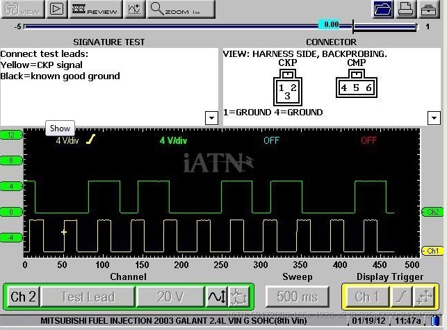

Thanks for all the help. Where do you guys find you known good waveforms? I would love to have access to IATN but I'm not a professional so I'm pretty sure that's out of the question
9 years 9 months ago #5057 by Tyler
Replied by Tyler on topic 2003 Mitsubishi Galant no start
I use iATN, but it's down for maintenance at the moment. :( I know Pico offers a database for use when you own a Pico scope, and Autonerdz has their Picogroup membership, as well.

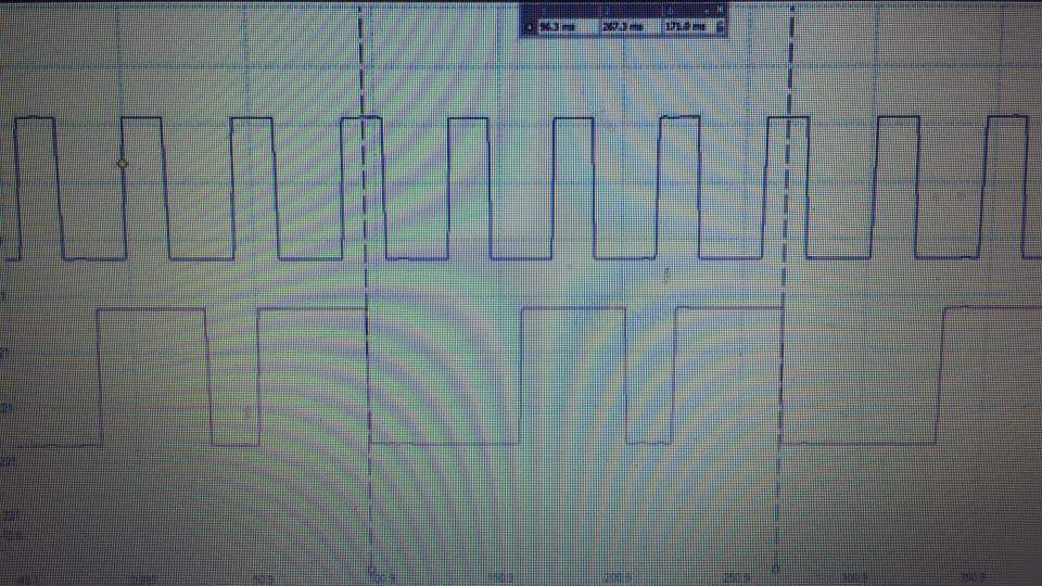

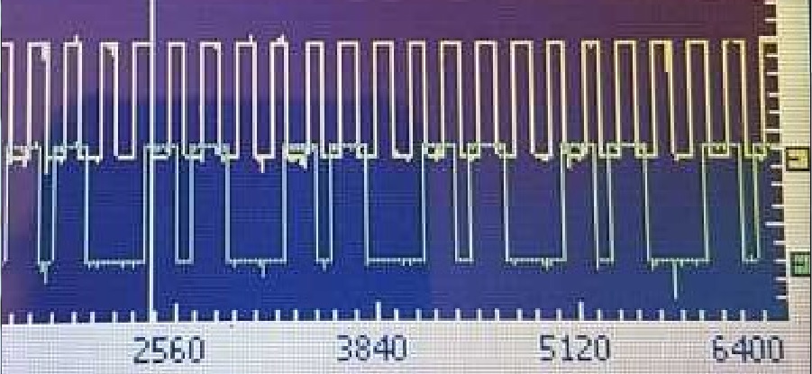

Found a known good:
For reference, here's your capture, zoomed in:
In the known good, it looks to me like the first 5V pulse of the CMP is supposed to bracket a 5V CKP pulse, and the second CMP pulse is supposed to intersect two CKP pulses. Your capture is definitely off. The first CMP pulse intersects two CKP pulses, and the second CMP pulse brackets a CKP pulse.
Did that make sense? I can clarify further if needed. Anyway, I'd say you've got enough evidence to pull the timing covers and inspect the tone wheels. The belt timing marks may line up, but the tone wheels aren't. :blink: Nice job getting the cam/crank waveform!
Last edit: 9 years 9 months ago by Tyler.
