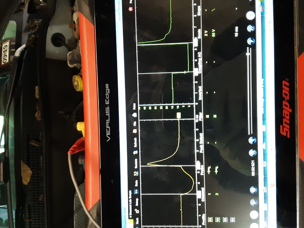

07 mazda6 v6
Runs Rough and stalls . Bogs down no throttle response
Injector signal
All injectors are similar in the signal test but where is the pintel hump ??

6 years 6 months ago #34282 by Cheryl
Replied by Cheryl on topic Rough !!!
That looked like ignition testing not injectors. Also try unplugging coils to do a power balance test

its the fuel injector connector. 3 front coils are firing but the 3 rear is under the manifold cant do any removal test
6 years 6 months ago #34288 by Noah
Replied by Noah on topic Rough !!!
The green trace on the right is a fuel injector voltage waveform. The little bump near the end of the slope after the spike is the pintle movement.
Like Cheryl said, your pattern looks like an ignition waveform. I'm curious to know how you obtained that pattern from a fuel injector.

6 years 6 months ago - 6 years 6 months ago #34303 by Carstuff
Replied by Carstuff on topic Rough !!! odd issue
which vehicle did you get that injector pattern from ? Im use to seeing that pattern on other vehicles however this mazda6 fuel injector waveform is different. which is odd. even the waveform snapon is displaying is just like what you just posted in the green. its the fuel injector not a ignition coil. im backprobing the wires that the snap-on scanner is telling me to. in the video you could see at the top saying saying fuel injector channel 1 signal and black to ground .
