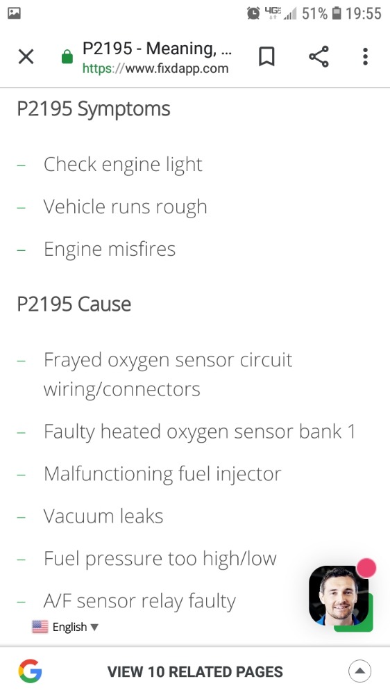

7 years 2 months ago #32656 by Andy_
Ok, I'll try to explain what I'm seeing here.
First, the definition for P2195 isn't exactly how it sounds, and not really what that picture you posted says.
Ford says, "Description
A HEGO sensor indicating lean at the end of a test is trying to correct for an over-rich condition. The test fails when the fuel control system no longer detects switching for a calibrated amount of time. "
FYI, HEGO is Ford language for an O2 sensor.
Read that description closely. It doesn't say the engine is running lean. It says an O2 is indicating lean because it's trying to correct an overly RICH condition.
You could also say the engine is running rich because one of the sensors is stuck or biased lean.
In other words, you may a sensor that is lying to you.

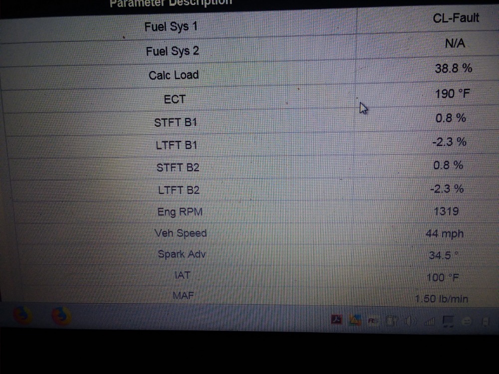

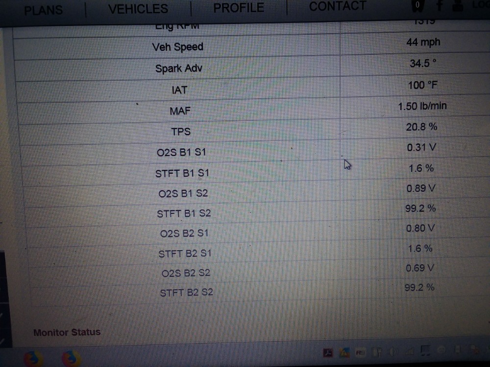

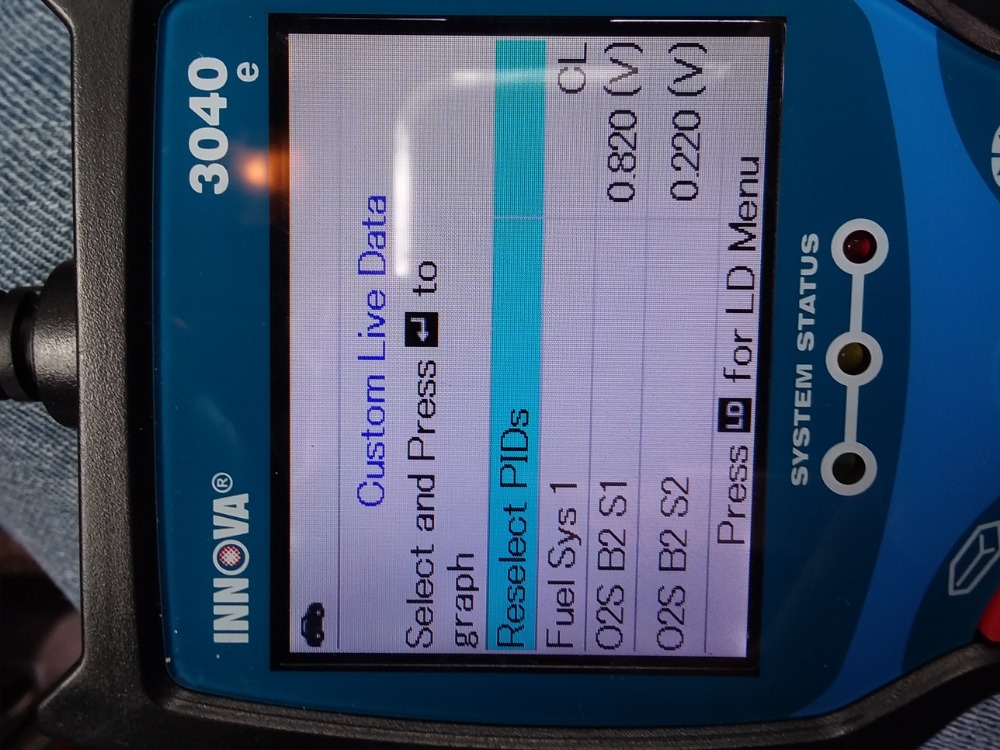

7 years 2 months ago #32657 by Andy_
Ok, go back and look at the third picture you posted. From what you've given us, that's the one with the most evidence.
Look at your short term fuel trim, it's at 42%. So the PCM is trying to add fuel, but look at your bank 1 sensor 2 O2. It's almost maxed out, it's over 950mv. These two things don't agree. If you are already the rich, why is the PCM adding fuel?
From what you've given us, I'd say that you PROBABLY have a bad bank 1 O2 sensor. This is hard to say from snapshots of data. Longer amounts of graphed out data would be better, but I don't know how capable your scan tool is of this.
You can see in the picture that the b1s1 O2 is at 365mv. Again, this is just one moment of time, so it's impossible to say, but like someone mentioned earlier, it seems like the B1S1 O2 was never going very high.
Let me know if you have questions. I can try to explain better if you are struggling to understand what I'm trying to say

7 years 2 months ago #32700 by Andy_
Did you change the sensor yet?
2 at a time is okay, all 4 would be better, but we can make that work.
Take the vehicle out, preferably when it's doing the problem. Graph both pre-cat O2's while flooring the vehicle, let it go to redline and through a shift if you can.
Do this on the road, under a load. Don't just snap the throttle in your driveway.

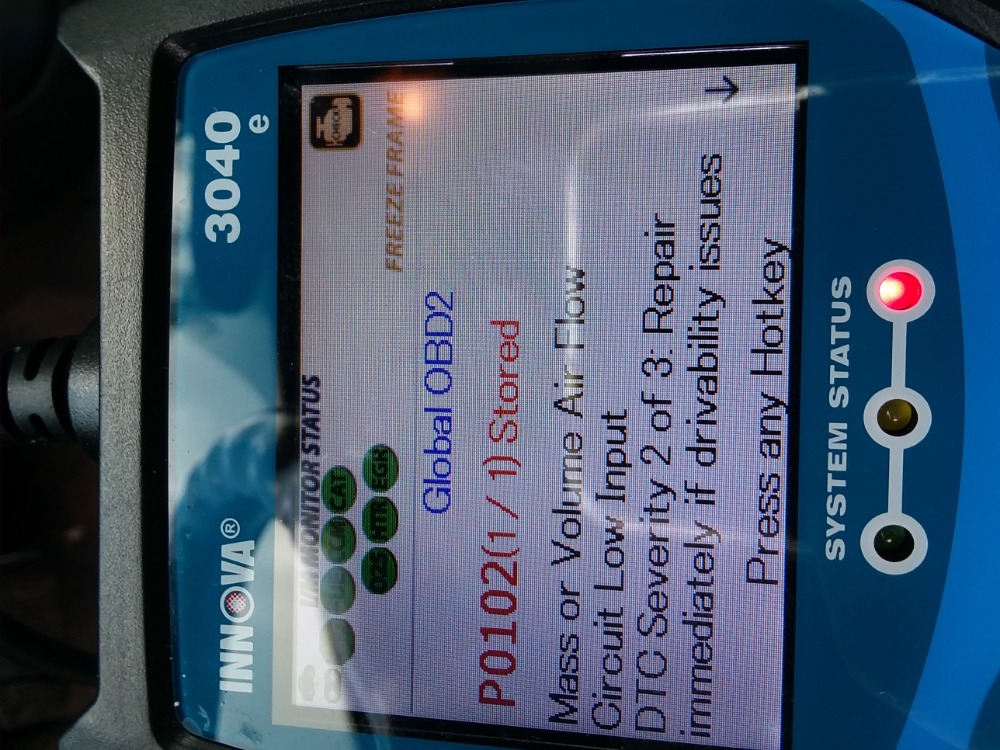

7 years 2 months ago #32704 by Floridaexplorer
I changed b1s1 o2 sensor today. I have better acceleration but still feels like bucking n jerking.
Yesterday fuel filter was changed. And I was advised to clean throttle body again with B12 which I did and it triggered a code. (P0102)

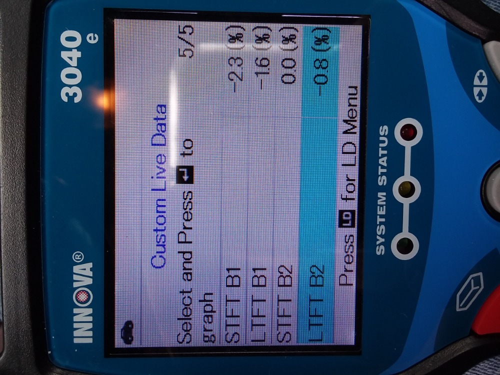

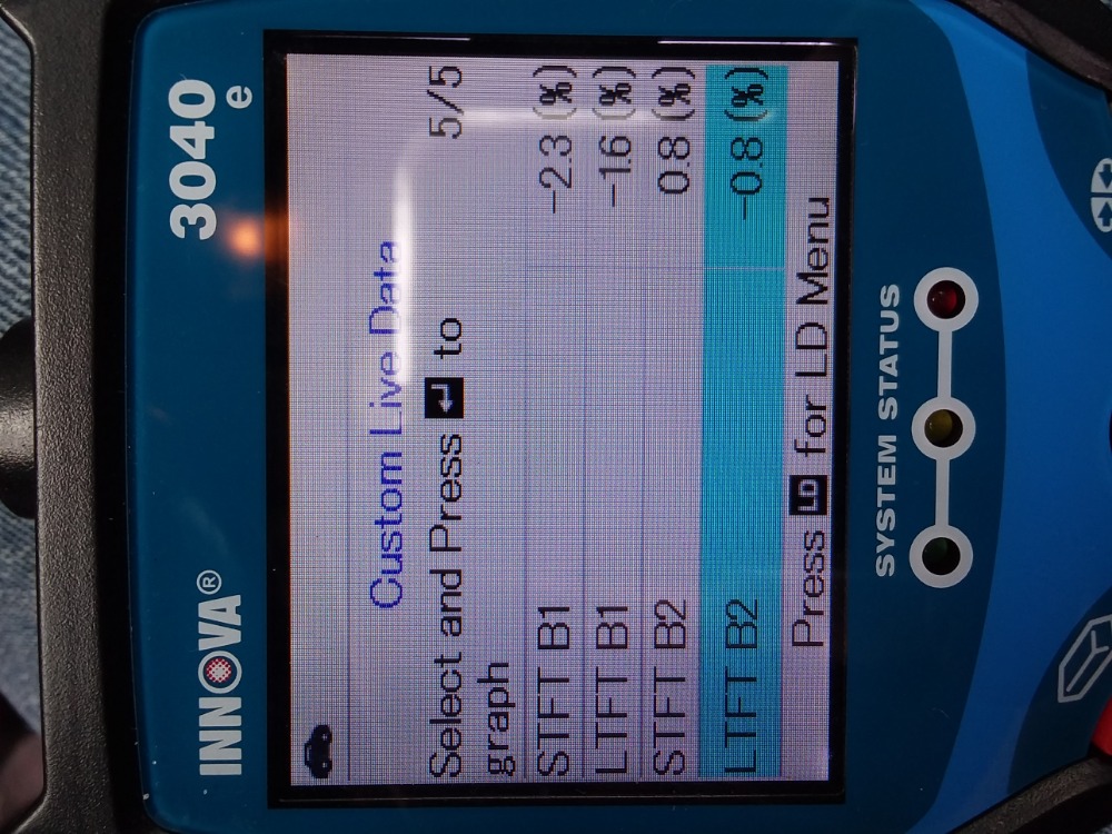

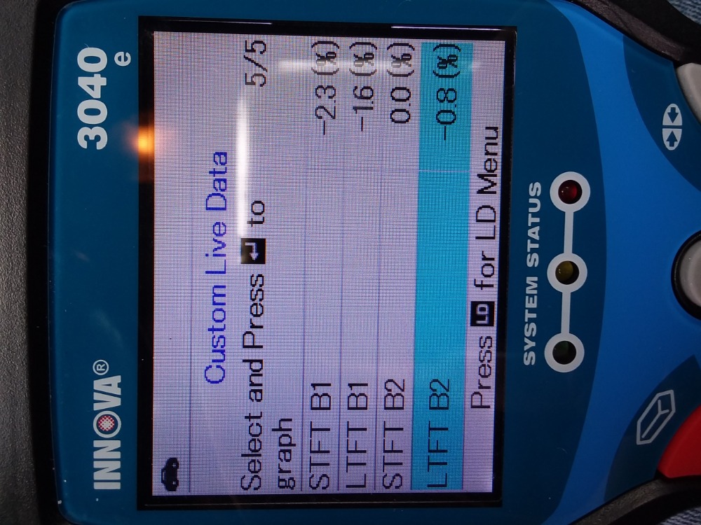

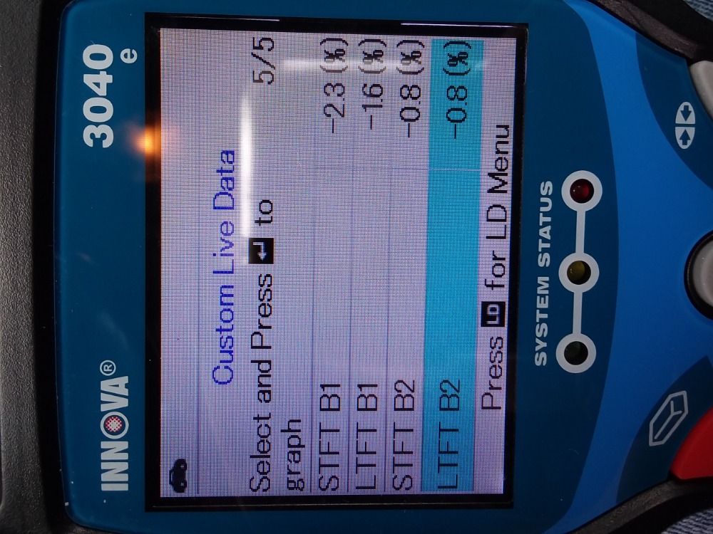

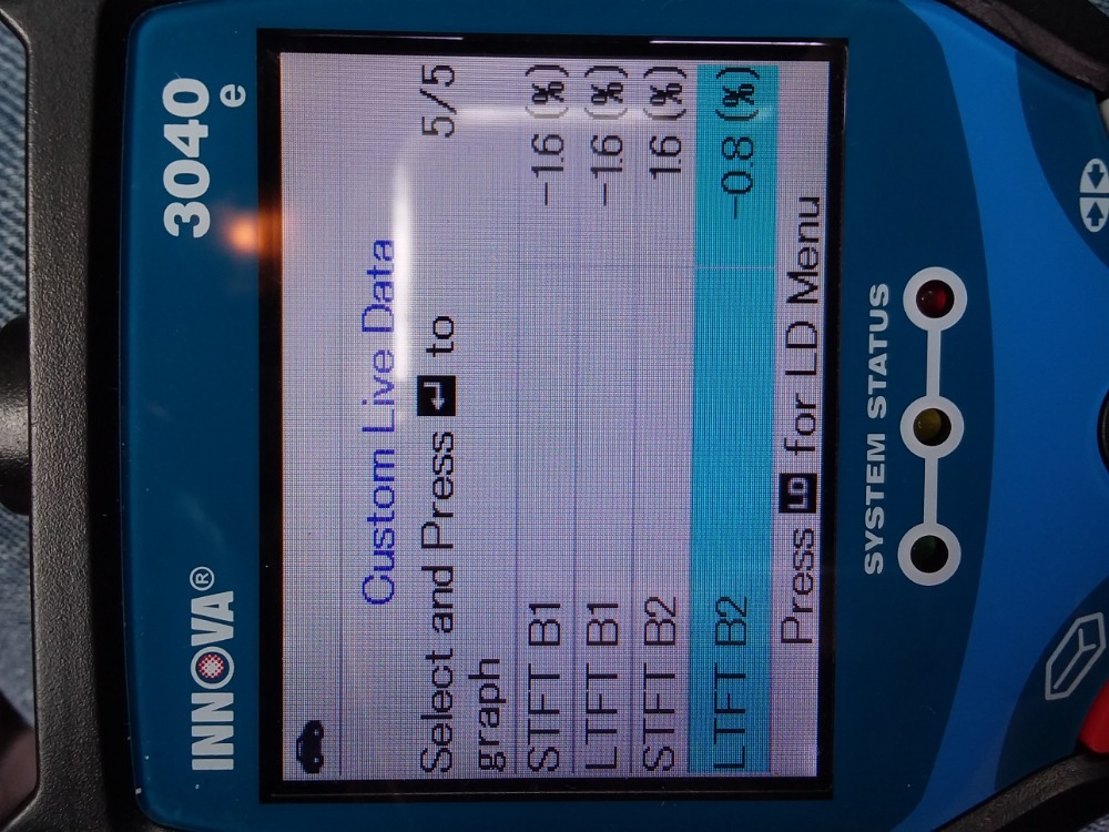

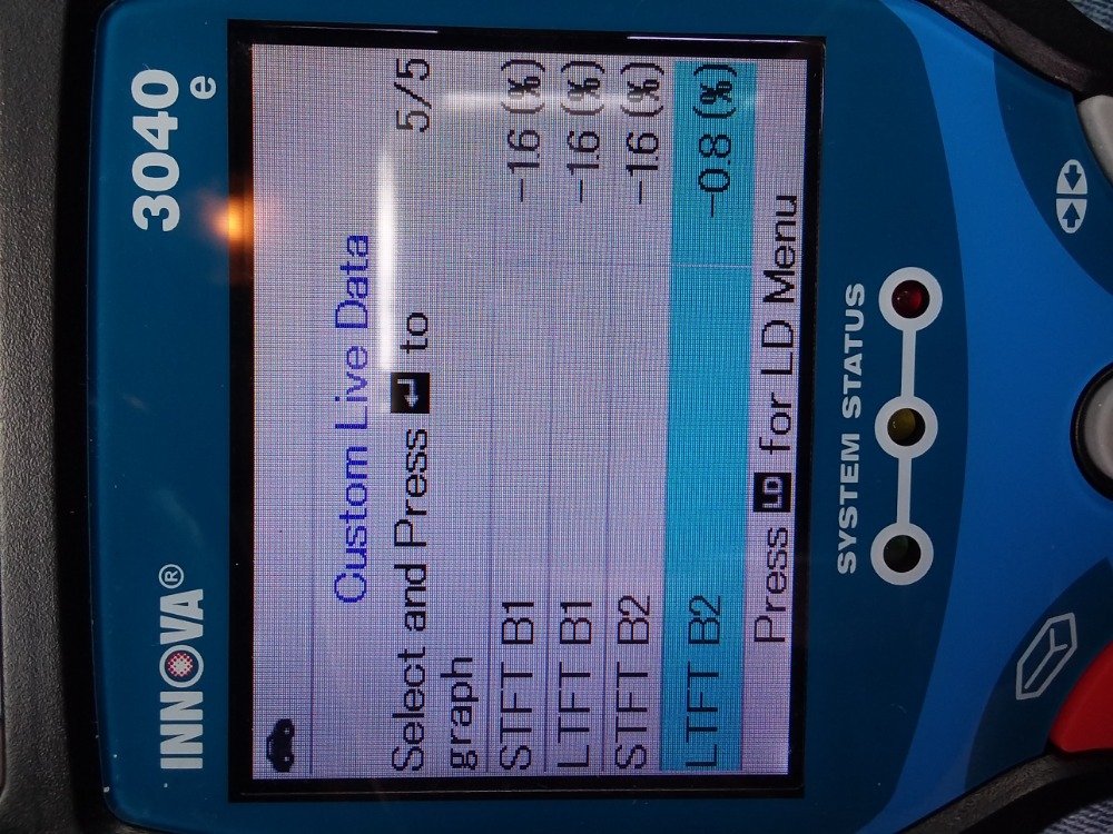

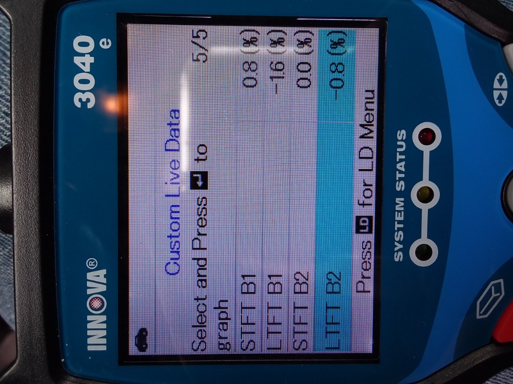

7 years 2 months ago #32706 by Floridaexplorer

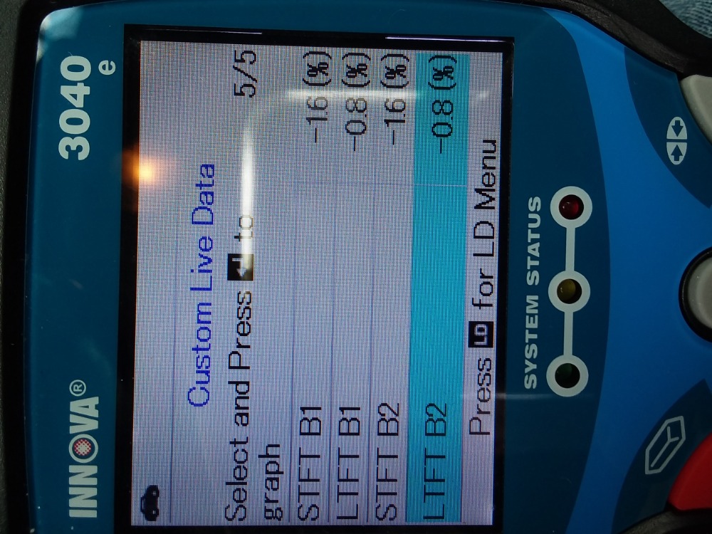

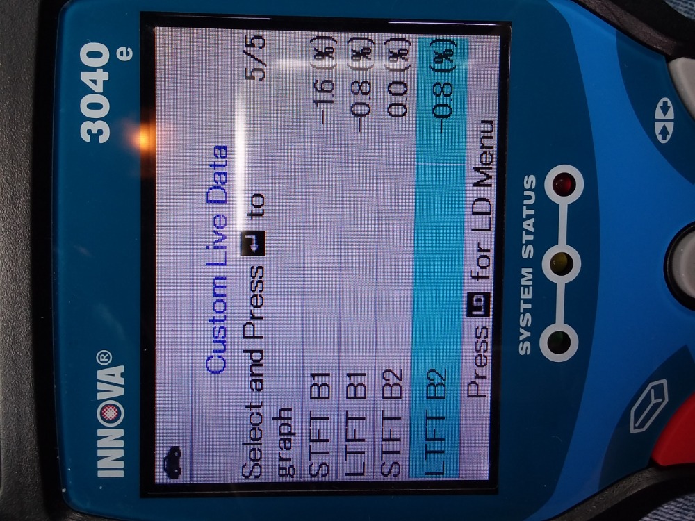

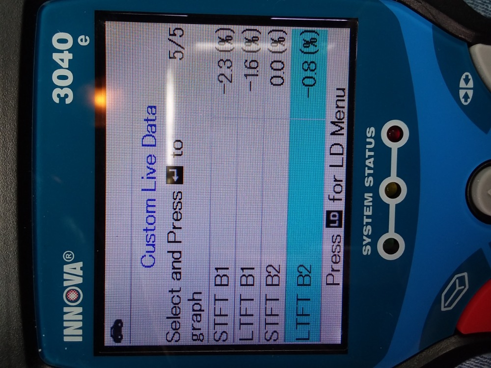

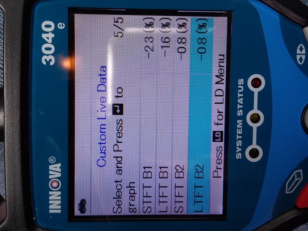

Fuel trims
  • Floridaexplorer
  • Floridaexplorer's Avatar Topic Author

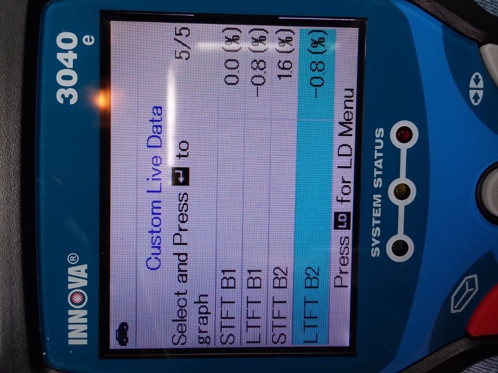

7 years 2 months ago #32710 by Floridaexplorer
When p2195 was triggered
  • Floridaexplorer
7 years 2 months ago #32711 by Floridaexplorer
When p2195 was triggered. (2)

I believe some of my fuel trims are negative.
7 years 2 months ago #32723 by Andy_
I don't think you need to go changing the other upstream O2 sensor. The fuel trims the you've posted lately look pretty good. A decent range is 0, +/-10%, and you were right there from what I've seen.
Can you check to see if your scanner has the option of looking at something called mode$06 data? It can help you identify which cylinder is misfiring.
