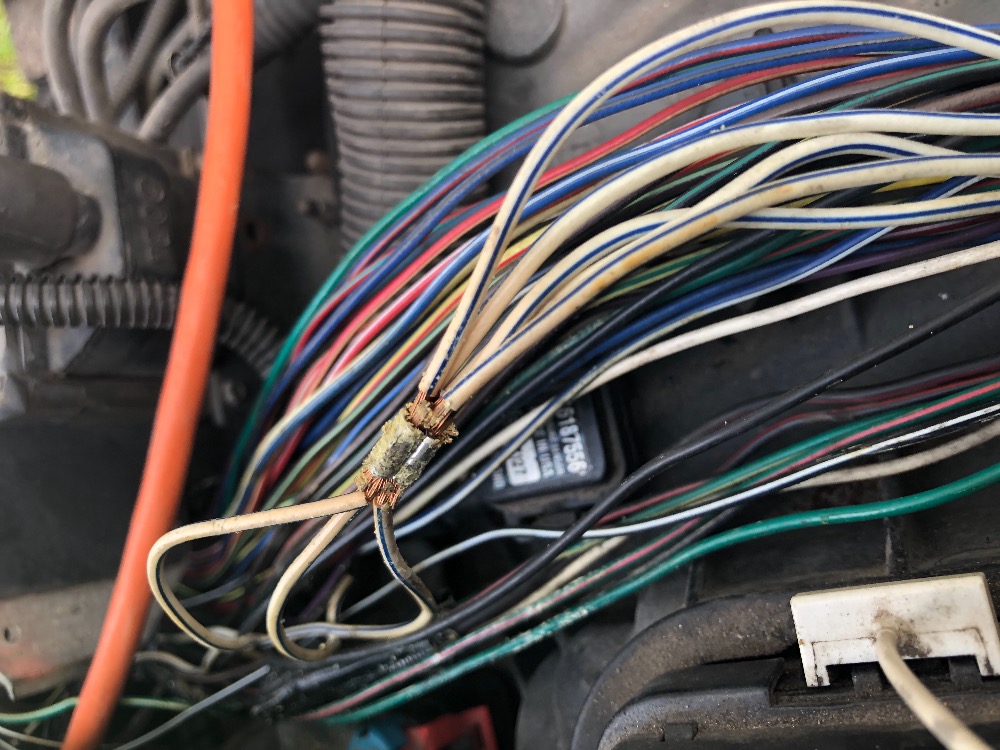

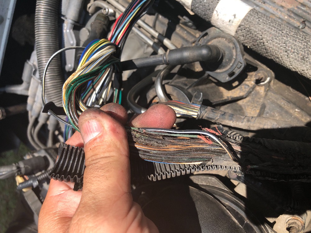

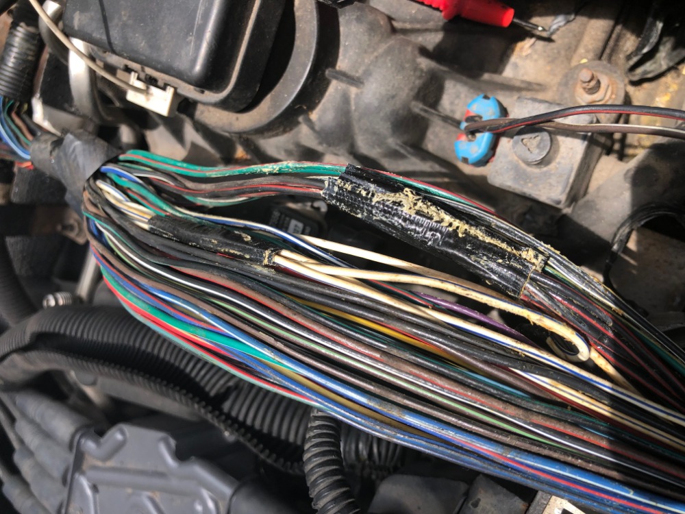

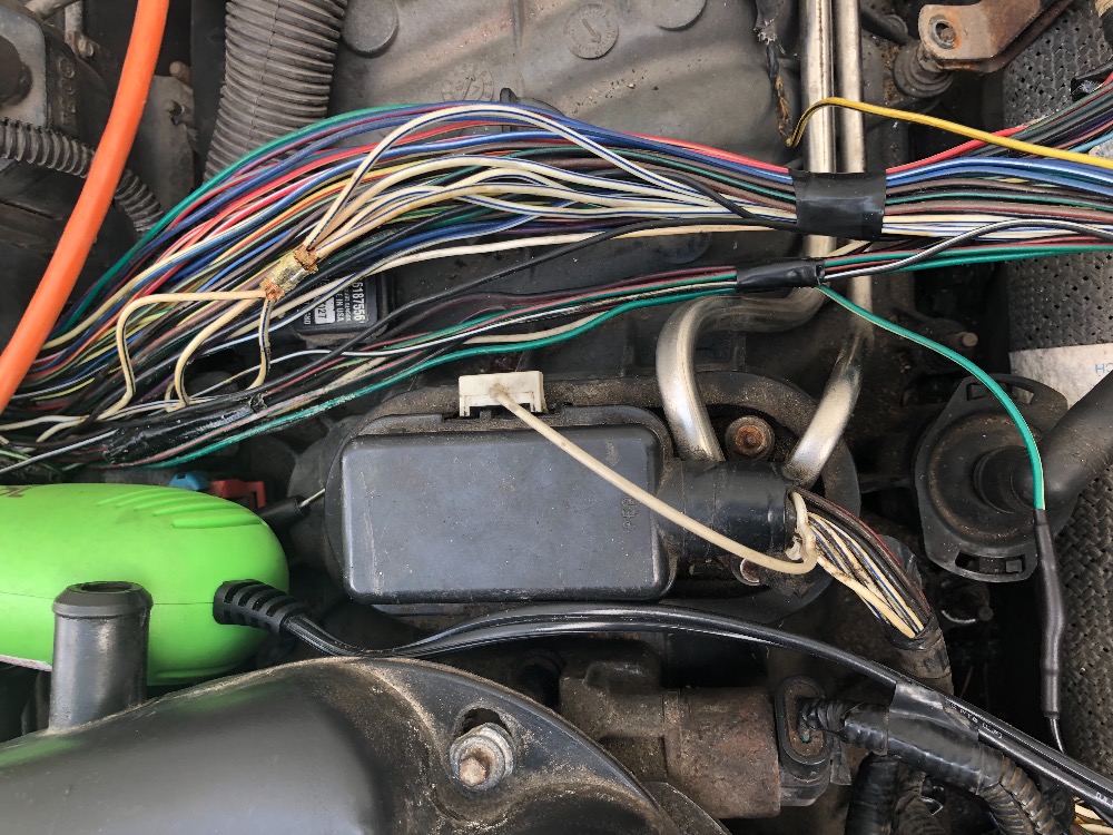

Well, this has taken an interesting turn. I checked continuity from the EGR pin to the negative battery post and nothing. I did the same thing with the map sensor and I got continuity to the negative battery cable. I am in the process of looking at the harness, and had to take a minute to take some pictures to show what I have found. See attached pictures. This is in my opinion a total mess.
Still trying to find the wire as it seems to have been re-routed a different way. Will be back with an update later.

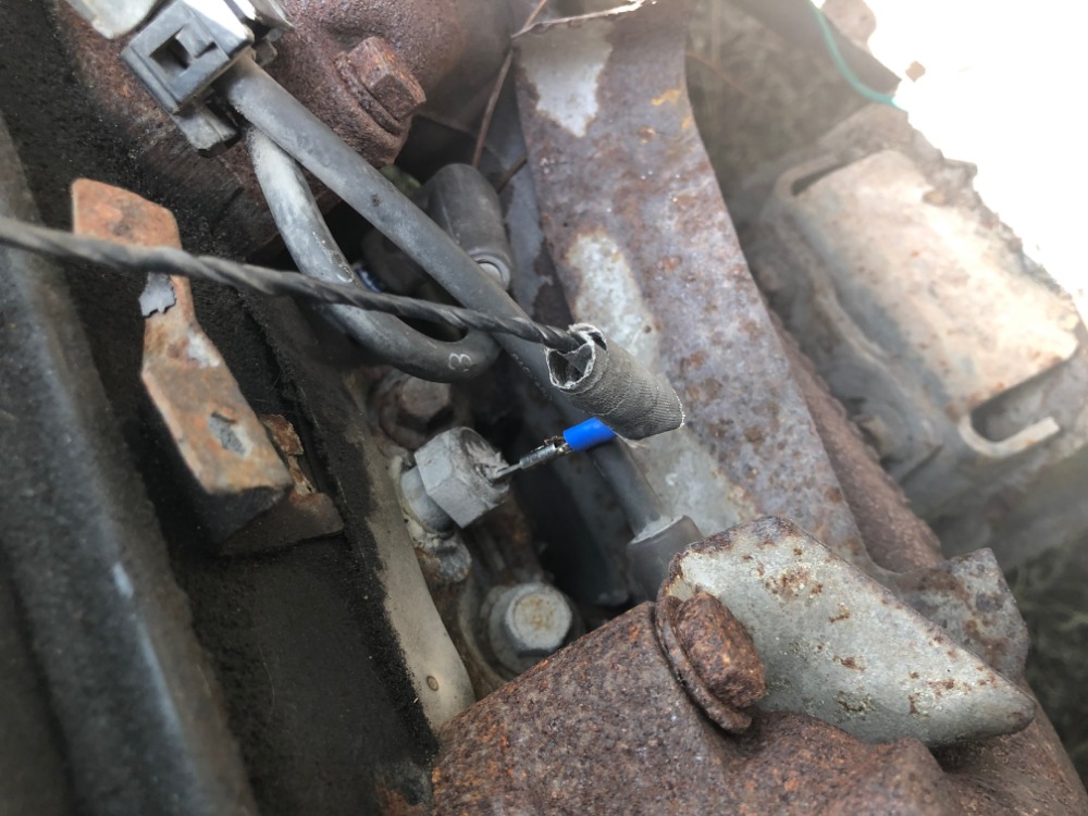

And finally, the mother load!
See attached.
See attached.

Awesome! I would have run a new line cause i'm lazy.

Thanks for all the help, I really appreciate it. Of course things get a little more exciting. I found 5 white and blue wires joined into a single line. They were wrapped with duct tape which looks pretty bad. Further down there are 5 white and blue crimped with another 3 white and blue lines. I have no clue what they did to this truck.
Some more pics attached.

Both codes P1406 and P0121 are and gone and check engine light is off after repairing the open in the ground wire.
Thanks for your help and guidance on this repair.
