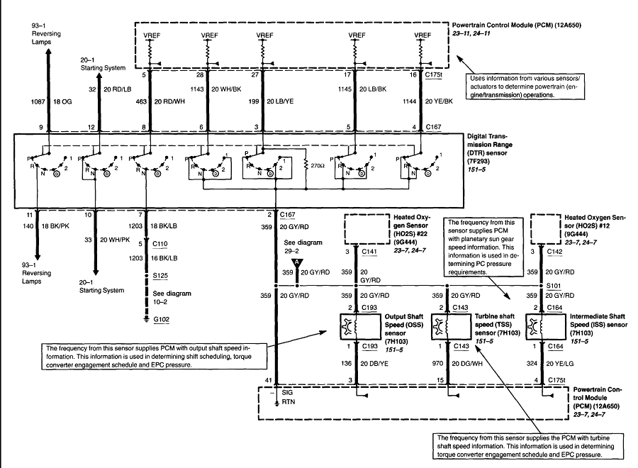

2004 Ford Explorer 4.6L 4WD with 5R55S. Came in needing a tranny. We opted to replace it with an exchange trans from our wholesale rebuilder. When done installing we could not get the transmission range sensor to line up. It would allow a start when in reverse. We've had this problem before but it's quite rare. I think the last one was 5 years ago and many, many trannies ago. We even tried ordering a new aftermarket range sensor but same thing. We had to grind out the holes to allow for that little extra adjustment. We ended up putting the new aftermarket sensor in.
A month later we get a call from the guy. The transmission works great. Shifts like a dream. The only problem is he has no manual third. It just goes into second. Boss-Man is very mechanical and hands on so he thinks right away that they messed up on the internal shifter linkage so he gets them to send a new rooster comb, manual shift valve, linkage rod and a few other goodies. It wouldn't be the first time a rebuilt unit had an issue.
So the vehicle comes in. Initial thoughts are the rooster is fine. When I move the shift lever it's not physically missing any of the detents and each detent perfectly matches the display in the dash. This guy is a PRND321. When I hook up the Verus and watch the Gear PID KOEO as I shift through the gears I get P-R-N-D-Man2-Man1-Man1. Immediately I start thinking range sensor. There are no codes and otherwise the transmission works excellently.
Boss-Man wants to look at internals. He remembers how much of a pain we had lining up the range switch initially. So I pull it in and drop the pan so we can compare roosters. Low and behold they are totally different!
Picture of both detent levers
Cue the celebrations and "I told you" from Boss-Man. The replacement one they shipped us had one less detent than the one installed. But wait a minute... That doesn't make sense. I can physically move it through each gear. If we installed a detent lever with one less notch then I wouldn't be able to hit manual 1st...
Here's where I start getting an indication of how much of a headache this thing is going to be... We call the dealer with all the part numbers and start figuring out what's supposed to be in here. The detent lever installed in the tranny is correct. The detent lever our wholesaler sent us is incorrect. It's out of a 5R55E out of an Explorer Sport Trac. Our transmission is a 5R55S. The Sport Trac just has a PRND21 and the regular Explorer has a PRND321. At this point I hadn't yet realized that the Sport Trac did not have a manual 3rd.
Boss-Man still totally thinks it's a mechanical issue. He's used to the older trannies where when you select manual gears it bypasses all the electrical and everything's applied hydraulically purely by the manual shift valve. But it was a slow day and he had to run on some errands so he let me have at it. Just make sure it's ready to go at the end of the day. The internals looked alright and we didn't have time to rip apart the valve body so I decided to go after the range switch. Do whatever I could to try and get the scanner to say Man3. After all... it makes sense. If the range sensor thinks you're calling for 2nd when you select 3rd then it's going to tell the tranny to go into 2nd. The pointer in the instrument cluster is purely a mechanical device and there's no sensor on the shift lever itself so the vehicle has no idea there's a problem and happily gives you 2nd thinking it's a good boy.
So I pull the sensor off the transmission and manually move it in my hand without any kind of linkage attached to it. No matter what I do I cannot get the Verus to say Man3. I get a little nervous when I graph the PID as the vertical axis does not have a Man3 label. It just has P/N - Rev - O/D - Man2 - Man1. I think there was another label at the bottom that either said "???" or "----". This makes me nervous because it wouldn't be the first time a scanner misinterpreted a signal. Holy hell that'll throw you for a loop if you're not prepared for it!!
Now, when we did the tranny swap we opted to put the aftermarket range sensor in. Fast forward to today and I got hopeful that the original sensor was still lying around but it must have been thrown out as I couldn't find it. Keep in mind, I have no idea if manual 3rd ever worked. So I got Boss-Man to order another aftermarket sensor. Again, in my hand manually moving it I couldn't get the scantool to say Man3. I then installed it into the vehicle and same thing. It was weird that I was able to get the aftermarket sensor to lineup without grinding it. Before we couldn't get either the original or the new aftermarket sensor to line up so we had to grind one. This one that I got was the same part from the same supplier as the one before so I would have thought I wouldn't be able to get it to lineup...? Weird, but it's still not saying Man3 so sideline that thought.
At this point I start looking at wiring diagrams so I can backprobe it. Check to see what's ACTUALLY coming out of the range sensor and what kind of interactions it has before it gets to my scantool. Here's where the headache really comes in and where I start throwing obscenities at Ford Motor Company!!! How are you supposed to diagnose things if you can't get good information!!! I checked Mitchell, Alldata and Identifix and none of their wiring diagrams showed a range sensor with a contact for manual 3rd!!! The only one that did was an ATSG book but it was for the older tranny that used slightly different colors that went to slightly different pins on the ECU. The good news is all the pertinent gear sensor wires go directly to the ECU. The only thing inside the transmission is a solenoid pack and it does not interact directly with the range sensor. Different harness all together.
This range sensor has 7 internal switches but there are only 4 that I care about. TR1, TR2, TR3A and TR4. So I backprobe each of these wires at the computer to see what I'm getting in each gear. This is with the new aftermarket sensor in. I didn't have time to compare it with the old aftermarket sensor. The results I got would match perfectly if the sensor was setup only for PRND21. None of the wiring diagrams that match this car list a 3rd position but each information source had a chart comparing the different switch states for each gear. That chart did list a manual 3rd and each chart for each source was the same so at least I could combine the two for something I feel fairly confident in.

The range sensor connector is the exact same for the Sport Trac. The switch chart is the same too except it doesn't list an entry for manual 3rd. All other gears switch the same. The Sport Trac wiring diagram shows the exact same colors, pins and internal structure as the regular Explorer for the range sensor. It just shows different pin locations on the ECU.

I'm thoroughly annoyed that my Verus only gave me a PID for the voltage on TR3A and a PID that said what gear I selected. The gear PID is processed data through. The only way you can verify that is you need to compare TR3A with TR1, TR2 and TR3. Why the heck don't I have PIDS for those?? Why do I have to manually check it myself?? My Snapon rep is going to get an earful the next time he comes around! :P
So I run out of time and have to throw it together. I put the old aftermarket sensor back in as the new one didn't make any difference. Recheck with the Verus and can't get a Man3 reading. I then hook up my little Autel scanner to confirm and same thing. No Man3. HOWEVER!!! MY FREAKIN $300 AUTEL SCANNER THAT I BOUGHT 7 YEARS AGO GAVE ME LIVE DATA FOR TR1, TR2 AND TR4 THAT MY EXPENSIVE SNAPON VERUS DOES NOT!!!!!! :angry: :angry: :angry: Oh man it was a good thing my rep wasn't there!! At this point it's well after hours, the customer is there and I have to let it go. Research time.
Tech Old-Timer was the one who did the transmission swap. He still can't get over the fact that he couldn't get the range sensor to line up. Keeps going off that it's the wrong tranny. Tell the rebuilder to ship a new one. But the tranny works perfectly for everything except manual 3rd... Again... if the tranny thinks you're selecting 2nd when you're at 3rd then you'll never get manual 3rd and it'll never think there's a problem. If that's the cause then you can replace the transmission and still have the same problem! There are huge consequences here... This transmission is UNPLEASANT to replace. Not to mention it's REALLY easy to have one minor mistake when rebuilding a transmission that throws everything out. Imagine if the replacement is a bad rebuild!! Imagine spending a day replacing the transmission only to find out that not only does it not fix the problem but the replacement has a problem and you have to spend another day putting the previous one back in and you're still back at the same issue! It's VERY easy to waste a ton of time here!
Boss-Man's still convinced it's mechanical. He calls up one of his buddies that's also in the transmission rebuilding business. He agrees that it should be mechanical and that hitting the manual gears bypasses electrical controls. So he pulls out one of his transmission repair manuals (ATSG). He goes to the component application chart and finds an Intermediate Band that only applies in manual 3rd. So he thinks there's an issue with that. That when you select 3rd it fails to apply that band and then slips into 2nd instead. How would it do that though? If the band fails then you're most likely going to have a neutral condition in manual 3rd. We don't have that. When you put it in 3rd it drives just fine except you get 2nd instead. If it were capable of realizing that it failed to apply that band then it would have to switch other components in order to apply 2nd. You would have a code for that. As well you should feel some kind of hiccup before you got 2nd. Not the case. Totally smooth when you select 3rd. And if that were the case you'd still get 2nd when you select 2nd. This vehicle gives you 1st when you select 2nd. If it tried giving you 3rd but then switched to 2nd you'd get: P-R-N-D-2-2-1. Not the case. This vehicle gives you P-R-N-D-2-1-1.
After Boss-Man left I noticed that the manual he grabbed was for the 5R55N. This vehicle is a 5R55S. I found a manual for the 5R55W/S. In the W and S models that band is also applied in third gear when you are driving in D. Everything works perfectly in D so that can't be an issue. We have to be left with some kind of control issue.
I then did some parts research. I went to the dealership but it was Saturday and they only had lube techs on so I couldn't get any service info but was able to get parts info. Including OE part numbers for the range sensor for the Explorer and Sport Tracs. They are different which makes sense. That switch state chart I attached is the same for the Explorer and the Sport Trac except the Explorer has an entry for manual 3rd. If they were the same part then how could they have the same switch state for Man2 when the Explorer has another gear physically in between D and Man2..? The only way that could happen is if the detent lever for the Sport Trac had an extended portion between those two detents. It would have to be able to physically move the range sensor further to get it to the same spot as the Explorer for Man2. But in the photo comparing the two I can see that's not the case.
The OE part for this Explorer is from 02-10 and 07-10 for the Sport Tracs but 02-06 Sport Tracs have a different part number even though the pin layout of the sensor is the same. At this point I looked to see what was ordered. That's when I noticed that the new one Boss-Man ordered for me was the exact same part as what was ordered previously. The suppliers interchange for this part listed both OE part numbers. I can't see one sensor working for two different shifters... So I think the problem is we're getting sensors for the Sport Trac. I think we're going to have to order a sensor from the dealer.
The only thing I can think of doing is to try manually supplying a signal for 3rd. The wiring diagram in the ATSG book I found does show a Man3 position inside the switch. The wire colors are slightly different than my vehicle and they go to different pins on the ECU but the internals of the switch appear to be the same. Just with the addition of contacts for Man3. So I should be able to unplug the sensor, jumper a few wires and then have the scantool read Man3...
But ya... everyone's ready to throw another tranny in this and I don't think that'll make any difference... :S

So vehicle came back and the no manual 3rd problem was caused by getting the wrong part from the parts store. The weird thing is that if I look at both of our main suppliers I have access to 3 or 4 sensors made by different aftermarket companies. Yet ALL of them list BOTH OE Ford part numbers in their interchanges... It's crazy that they would all list the wrong sensor. Physically they look identical and internally they are very similar. If a customer came in needing a replacement sensor and you replaced it you probably wouldn't realize it was the wrong part. P, R, N and D would all work perfectly. It would start only in P and N. It would feel totally fine. Most customers wouldn't even realize they had man2 instead of man3 for a long time.
Before I installed the new OE Ford sensor I manually checked it. For man3 it connects pins 3 and 4 to sensor ground (pin 2). Sure enough, I found a position for that. I then went to the vehicle, unplugged the sensor and jumpered all those wires together with backprobes. Sure enough my scantool read man3 for the data PID. At this point I knew it would work.
When I installed it I was back to the original problem of not being able to get it to fully line up. It was off by one gear through the full range. I had to grind the heck out of this sensor to get it to lineup. Way more than the previous one. Which makes sense because the previous one had one less gear selection. I managed to get it in and get everything to lineup. All gears perfectly lineup with the PRND321 display in the dash as well as the gear data PID on the scantool.
I think the problem with this tranny build is with the shift lever shaft. The shift cable connects to a small lever on the outside of the trans. That lever connects to a round shaft that goes through the range sensor and into the tranny. It's fastened to the shift detent lever which has a pin that moves the manual shift valve inside the valve body.
Not the best picture for demonstrating which part I'm talking about but it's the only one I have :P The shaft I'm talking about is the part I'm holding.
The only thing that makes sense is if that intermediate shaft in the shifter linkage is slightly different between these two versions of this transmission. That wouldn't affect the detents so you could still get it to match perfectly with the display in the cluster but it would throw off the range sensor a bit making it hard to line that up. This tranny was built by a wholesale rebuilder that probably builds a couple hundred trannies a month. When you're doing that many and you're going to have that many bins of hard parts it would be so easy to accidentally grab a small part for a 5R55E and put it in a 5R55S... Internally these trannies are so similar that they probably just have a bin marked 5R55N/W/S/E. :dry:
All in all we made it work. Good riddance to that thing!
