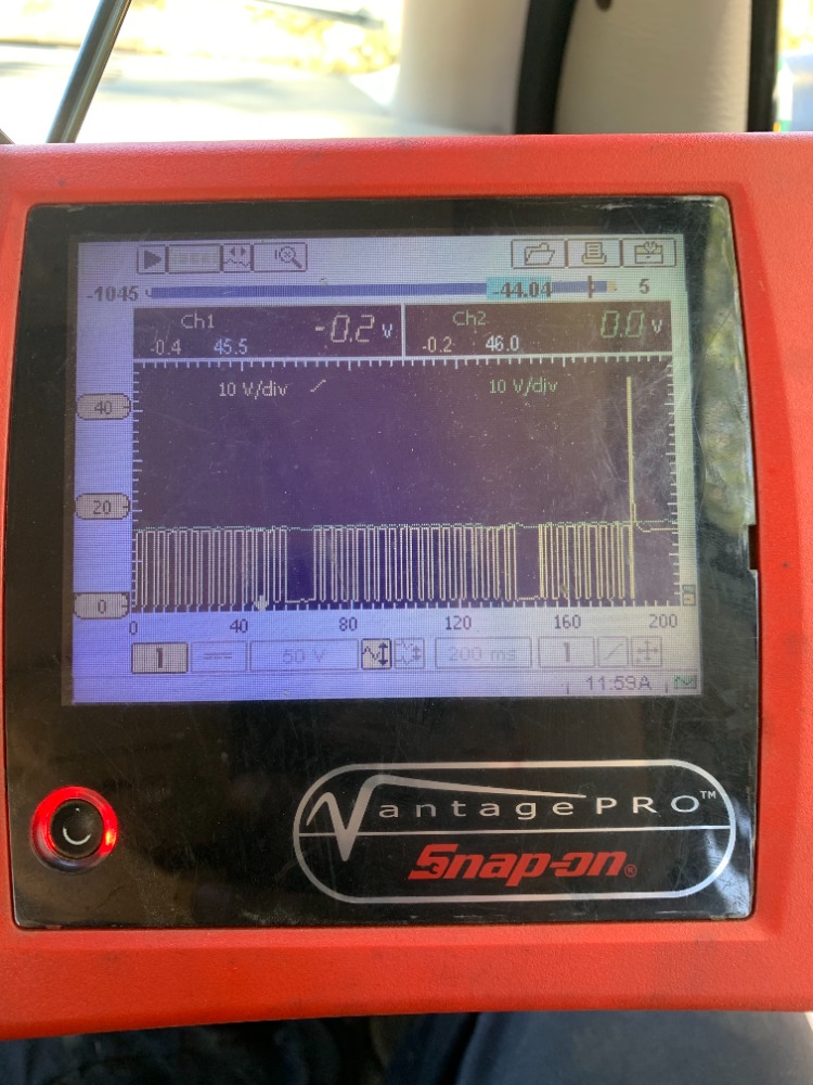

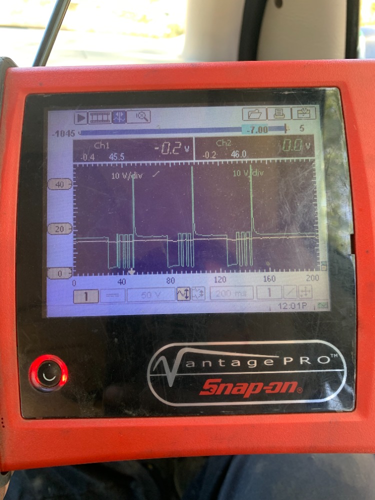

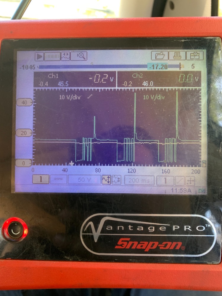

2008 DODGE 6.7 68RFE TRANS CODE P0770-4C SOLENOID CIRCUIT
  • Ecadenas
  • Ecadenas's Avatar Topic Author
3 months 4 weeks ago - 3 months 4 weeks ago #93065 by Ecadenas
HELLO EVERYONE I AM TRYING TO DIAGNOSE THIS TRUCK. IT IS GOING INTO LIMP MODE I HAVE A COUPLE SCOPE CAPTURES OF THE 4C SOL CTRL AND THE UD SOL CTRL TO COMPARE IT SEEMS I AM LOSING THE GROUND FROM THE TCM. I AM BACKPROBED AT THE TCM USING A VANTAGE PRO CH 1 IS THE 4C CH 2 IS THE UD SOL. I AM SORRY IA M VERY NEW AT USING A SCOPE I HAVE DONE AMP DRAW TESTS AND CHECKED RESISTANCE AND SOLENOIDS ARE TESTING OK. I CAN PROVIDE MORE INFO AS NEEDED TO NOT MAKE THIS POST TOO LONG. THANK YOU IN ADVANCE

3 months 2 weeks ago #93079 by Ecadenas
Just posting the resolution ended up being a bad TCM. I swapped the pins for the 4C and the 2C solenoid let it idle in park and would continue to set the same code.
