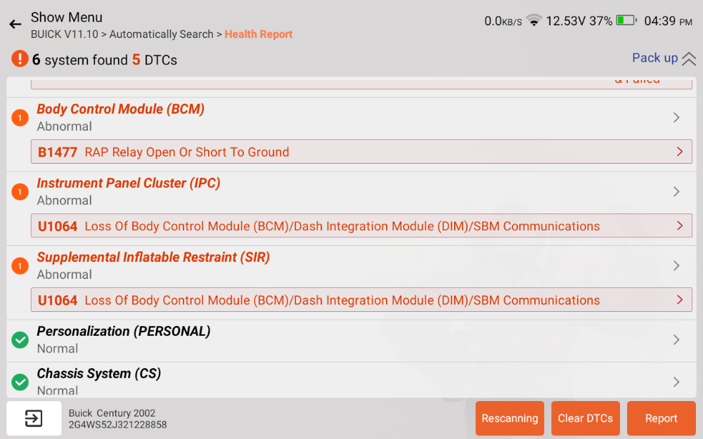

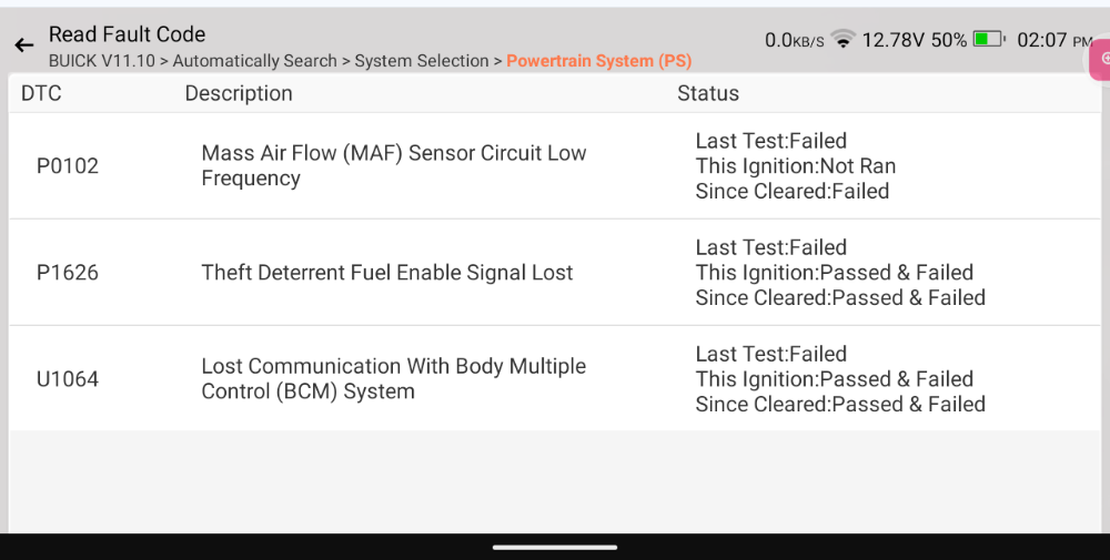

8 months 1 day ago - 7 months 3 weeks ago #92055 by StepSide88
Part1: www.scannerdanner.com/forum/post-your-re...-no-start.html#91994
Back at this pia.. I finally got the missing spark located and sorted out and it fired right up and it will run for 30sec or so before shutting off.
So now it'll throw a code or two.
Current:
PCM codes: p0102. MAF (was disconnected for ECU access)
p1626 BCM theft deterrent
u1064 loss of a class 2 module communication.
The one that comes back after clearing them that has me totally confused is B1477 a missing RAP (or Retained power) relay communication.
I had to look for a while before finding it hiding behind the glove box and that's when I got lost.
The data shows it's location but that location is empty... An empty slot on the metal relay mounting bracket but no wiring harness, connector or relay to be found.
I have ordered a new one and an Rlink J2534 to program it with but don't really want to open either package if I can find a way to prove it's not* the BCM wanting to talk with a relay that's not even present on the car.
Any suggestions would be helpful.. hopefully.

The p1626 refers to the fuel enable status for the theft deterrent system.
Like Tyler suggested in your previous repair question topic, it would be wise to watch to fuel enable and theft status PIDs during the stall.

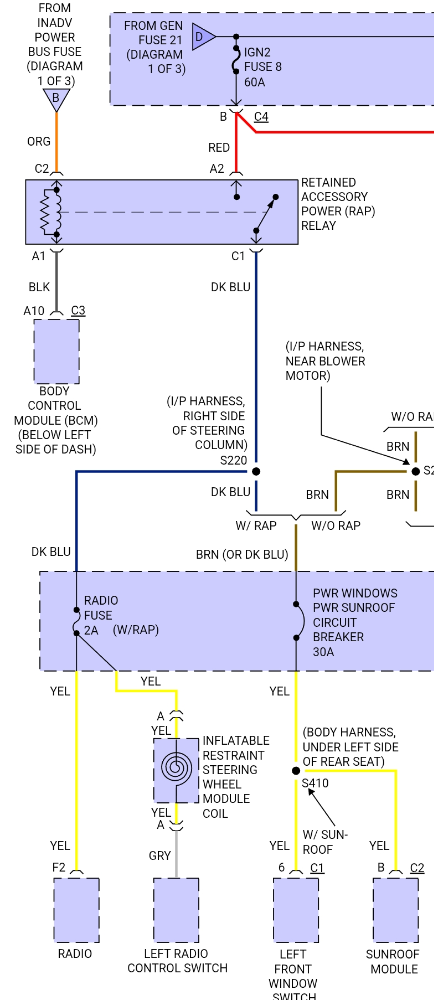

B1477 refers to RAP or Retained Accessory Power. This is when you turn the ignition off after a drive and can continue to use the radio and power windows before you exit the vehicle.
Most likely not related to the issue at hand.

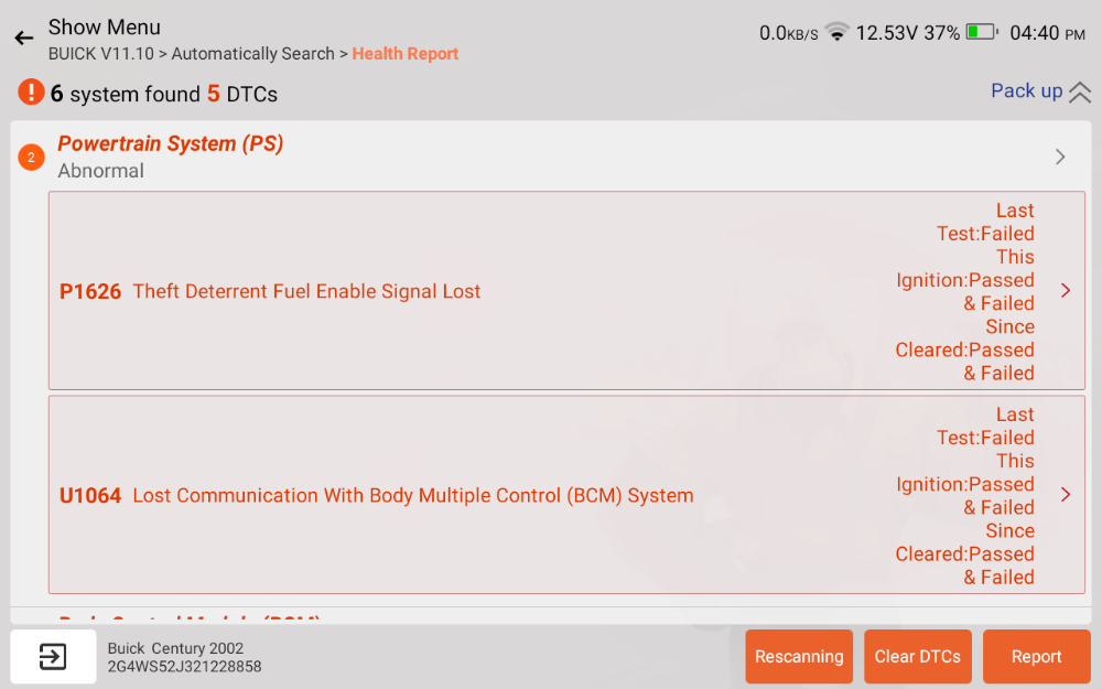

The Class 2 DTC check shows dtc's present in all the modules connections except
PCM/BCM
BCM/BFC/DIM/SBM/TBC
IPC
ABS/TCS
and the supplimental inflatable restraints.
The IPCluster shows a U1064 loss of comms with BCM/DIM/SBM
The Chassis has lost comms with the PCM and reports the class 2 malfunction
It sure seems the BCM is the common denominator to me but I'd love to be wrong about it. Any more suggestions?

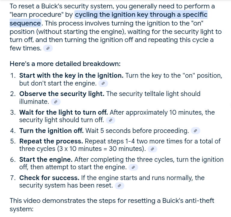

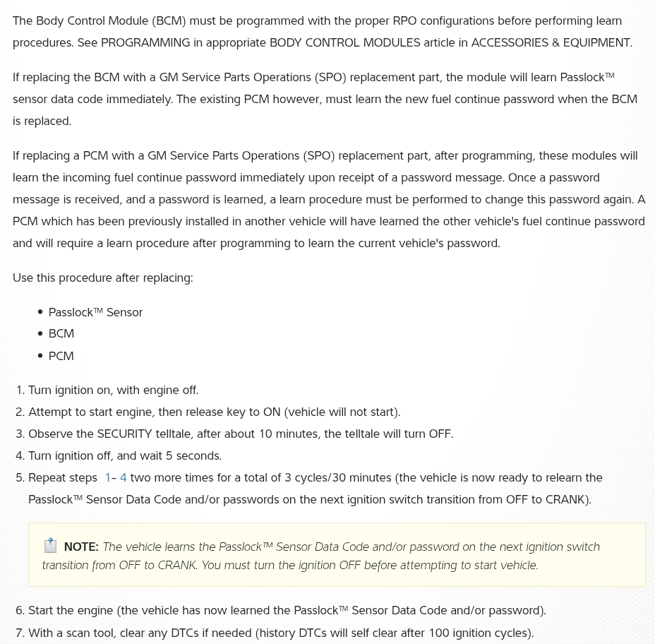

8 months 2 hours ago - 8 months 2 hours ago #92061 by Noah
Find attached the location and power distribution diagram for the RAP relay.
As you can see, the diagram shows that, if equipped, the RAP relay is power for the sunroof and windows.
Also find attached the Passkey relearn procedure as outlined by General Motors in service information.
Google or whatever AI isn't exactly the most reliable source of information. There a few variations of the relearn procedure and they must be followed exactly as outlined or will fail. I know from experience that 10 minutes means EXACTLY 10 minutes. If you let it sit 10min and 10sec, you need to start the process over. If you accidentally turn the ignition to the Crank position instead of the On position, you need to start over.
Some of them want the ignition turned to Crank initially and some of them want the ignition turned to On initially. If this step is not followed correctly, you need to start over.
It's very easy for this "30 minute relearn" to run well over an hour.
The security telltale remains long after 10 minutes
This alone seems to indicate an issue with the security system. As I I recall, the indicator should illuminate momentarily for the bulb prove and then go out.
VTD during key start showed Yes to the PCMVCM in VTD fail enable ' pid
and Inactive for the fuel disable and automatic learn timer pids
Do these PIDs change when the vehicle stalls after 30 seconds of running? Can the vehicle be restarted after it stalls without turning the ignition switch to the Off position?

7 months 4 weeks ago #92063 by StepSide88
Yes it should go out but it stays on so do I wait for it to go out or turn the key off at 10min regardless? also fwiw service engine light is on.
I can't say if it does since it won't consistently start and run for that long. I believe those are the same ones I have seen from the beginning of my looking at them.
I have no idea what/why makes it run when it does. Or why the codes come and go..
I understand the RAP isn't that important but the why* it's being coded still confuses me.
FYI the Key is good   I checked it's resistance

  • StepSide88
  • StepSide88's Avatar Topic Author
7 months 4 weeks ago #92066 by StepSide88
I need to up my reading the instructions game I think..
The test I was trying to do needed a little more than I thought.. it looks like I still need to get the Tech2 set up on my old laptop. Is a J2534 device the second tool required to perform the task?
From AllDataDIY..
TOOLS REQUIRED
 -  Tech 2
 -  Techline terminal with current SPS (Service Programming System) software
 1. Connect the Tech 2 to the vehicle.
 2. Select "Request Information" under "Service Programming".
 3. Disconnect the Tech 2 from the vehicle and connect it to a Techline terminal.
 4. On the Techline terminal, select 'Theft Module Re-Learn" under "Service Programming".
 5. Disconnect the Tech 2 from the Techline terminal and connect it to the vehicle.
 6. Turn ON the ignition, with the engine OFF.
 7. Select "VTD Re-Learn" under "Service Programming".
 8. Attempt to start the engine, then release the key to ON (vehicle will not start).
 9. Observe the SECURITY telltale, after approximately 10 minutes the telltale will turn OFF (the vehicle is now ready to
relearn the password on the next ignition switch transition from OFF to CRANK).
10. Turn OFF the ignition, and wait 5 seconds.
11. Start the engine (the vehicle has now learned the password).
12. With the Tech 2 (scan tool), clear any DTCs.
  • Noah
  • Noah's Avatar
7 months 4 weeks ago #92067 by Noah
That method is faster, but it is not necessary. The 3x 10 minutes relearn is an alternative to the factory scan tool method.
I think at this point buying a J box and service information subscription may be an unnecessary expense, but that's completely up to you.

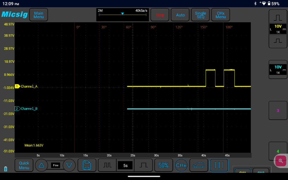

Should there be spark during the cranking portion of the relearn cycle?
When it says "will not start" is the PCM cutting the signal to the ICM preventing the firing of the plug?
I checked during one of the relearn start cycles and there was none.
  • Noah
  • Noah's Avatar
7 months 4 weeks ago #92069 by Noah
To my knowledge, the VTD will not cut spark. Knowing there is no spark is good information!
If the car is missing spark, then there is likely another issue preventing the car from starting.

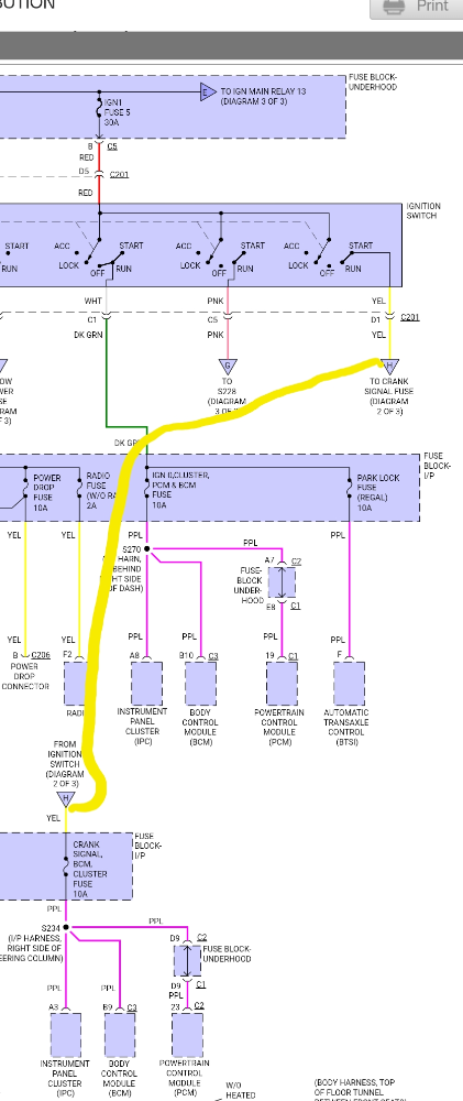

7 months 3 weeks ago #92075 by StepSide88
After my cousin suggested that and I checked the BCM ohms readings one of the first vids to show up on my YouTube recommendations was one of your VAT resistor replacement vids for a 98 buick. Still not convinced I need to go there to fix my issues with spark.
Fuses and relays haxe been my focus when not installing replacement garage doors and stuff, and I did find a circuit to investigate,
The IP panel fuse for Crank, BCM ,Cluster and the one for the Heated mirror have no voltage going to in from the under hood fuse box 30A Ignition main fuse which is good and powered up.
So that seems like the best place to look.

If that fuse does not have power key on, or in the start position, but the 30A fuse under the hood does have power, then you should investigate the circuit from the ignition switch, or the ignition switch itself.
Tell me if I'm looking at the correct fuse on the diagram.
Last edit: 7 months 3 weeks ago by Noah.

7 months 3 weeks ago #92090 by StepSide88
To busy to do much but did get this..
Fuse out and scope was hooked to leads from the fuse box terminals,
IP panel fuse A_3 & 4 (Crank signal, BCM, Cluster) channel A = 3 and B = 4 you can see the KI + KO prior to Start event (2x) so why is the supply from H (your line) is missing in the run position or does it stay on if the A_4 side of the fuse send a signal through the CAN bus?
Any particular events or tests you would like to see let me know.
Thanks again
  • Noah
  • Noah's Avatar
7 months 3 weeks ago - 7 months 3 weeks ago #92092 by Noah
I don't see in the diagram what you are referring to? There will be no CAN bus signal transmissions through these fuses, this is strictly power distribution.
If there is no power at the yellow wire that is labeled H in the diagram at the interior fuse panel with the ignition switch in the start or run position, then you must check for power on the yellow wire labeled D1 at the ignition switch with key in the on position, and with the key in the start position.
Missing the power here with the key in the on position and in the start position only would indicate an issue with the ignition switch (assuming the power feed to the ignition switch on the red wire is intact.)
