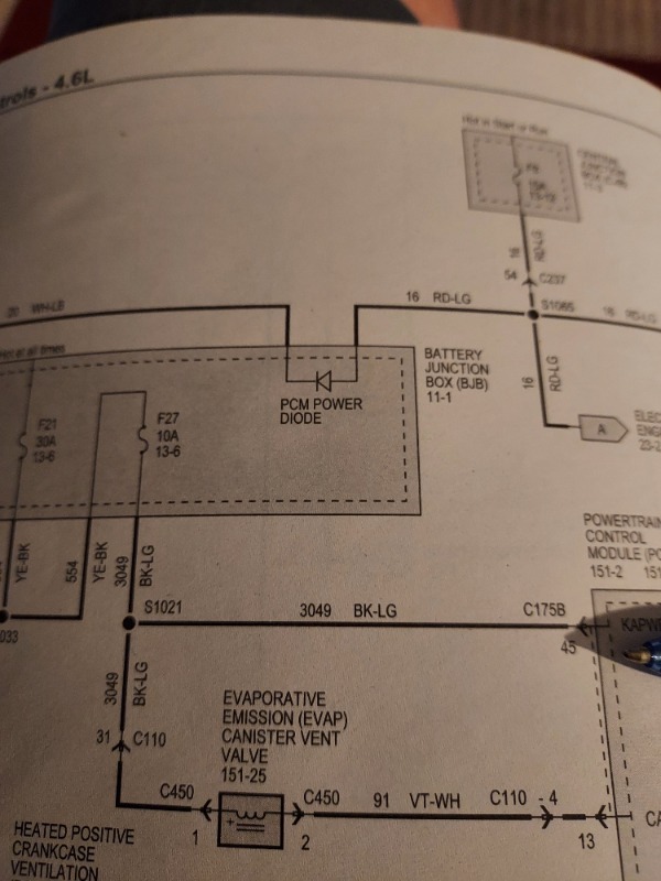

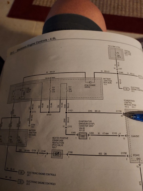

Run a jumper wire from the underwood battery junction box fuse 27 to the pcm kapwr pin #45. That is the Keep Alive power supply constant hot. I saw an e150 in the salvage yard with this. So far this has worked for me. It bypasses the bad wire inthe harness
2 years 7 months ago #62722 by Hurt
2 years 7 months ago - 2 years 7 months ago #62723 by Hurt
 I was in a salvage yard and saw a 2007 Ford E150 with a jumper wire that ran. From the underhood battery Junction box, fuse number 27 to the PCM pin number 45 pe that is, the middle PCM connector  this wire was bypassing the KAPWR wire.Keep alive power wire. It is a constant hot wire use an 18 gauge wire.  with the 2 blue spice connectors that you crimp with a pair of pliers.
