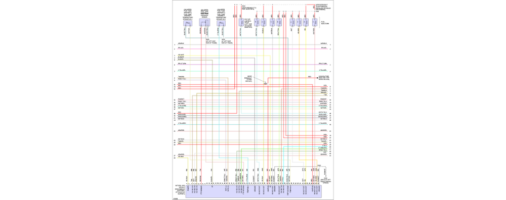

7 years 11 months ago #20843 by Dave101
Replied by Dave101 on topic 98 Crown Vic LX Fuel Pump
Not sure I've pulled up the right information. I pulled up the wiring diagram for a 98 Ford Crown Vic with a 4.6L engine. This is showing two fuel temperature sensors on the fuel pump assembly. The reason that I question this is they lead to a NGV module that should be on the front of the radiator support. If this is true, that is where I would start. I'm sending the diagram for you.

I think this is the correct circuit (i edited the diagram to fit more easily just the fuel pump circuit): i.imgur.com/7Dx2shn.jpg
Also, the red wire from the PCM powers other components on the car which I have removed from the image for simplicity sake.
I would just check for battery voltage on the Pink/Black wire while a buddy is cranking car. If you see battery voltage, and still no crank, then pump is bad.

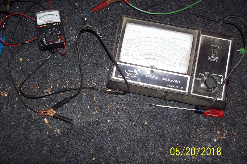

Okay, did my test in the trunk and more confused that ever.
* temp in garage 80°
* starts right up with steady 12 volts
* after 35 minutes voltage drops to 9-10volts
* second later engine dies then drops to 0 volts
* wait a bit and both prime and cranking are 9-10 volts, engine chugs
like it's trying to start.
* I didn't have the fuel pressure tester hooked up today
I've had this happen before, after a no start try a bit later and it almost starts
but chugs like today. I'll bet the farm tomorrow I can go out and it will fire right up.
Really confused now with the 9-10 volts, not what I expected to see.
Thanks very much, now what?

  • Oriley
  • Oriley's Avatar Topic Author
7 years 11 months ago #20853 by Oriley
Replied by Oriley on topic 98 Crown Vic LX Fuel Pump
Sorry, maybe I didn't explain it clearly. After 35 minutes the voltage in the trunk on hot and ground dropped to
9-10 volts then it died. Maybe 10 minutes later I tried a restart and still at 9-10 volts it wouldn't start.
I just have to believe this is temperature related to something, no idea what it could be. When it's cold
out it runs much longer than in warm weather. ????
Or, could it be a bad pump that itself is overheating after a while and that draws the voltage down then it dies?
Long day and thanks for all the comments, I'll take another look tomorrow.
If it matters, this one has the coil-over-plug. Friend told me a common problem is something on the distributor,
I don't have one.
Thanks

  • Oriley
7 years 11 months ago #20889 by Oriley
From bad to really bad?
Yesterday
Car ran 75 minutes - 30# pressure - 14 volts in trunk
Pressure slowly dropped to 0
Previously it only took a second or two to 0, now ~10+ seconds
Engine dies
voltage in trunk goes from 14 volts to 7 volts till I turn key off
turn key on, prime then 7 volts constant - crank 12 volts - no start - 7 volts
Also, when the key is turned to "on" the interior heater blower comes
on for 5 seconds or so then off like it should be. ???
The bad feeling it being the PCM is back.
Thanks again..

7 years 11 months ago #20898 by ScannerDanner
Replied by ScannerDanner on topic 98 Crown Vic LX Fuel Pump
Oriley wrote: voltage in trunk goes from 14 volts to 7 volts till I turn key off
So during cranking you have 12v to the pump and then with just the key on you have 7 volts on this same wire?
This sounds like a bad ground and it is back feeding through the fuel pump motor. Please give us a measurement of the fuel pump ground wire during cranking or running and then with just the key on.
This could explain the weird blower operation too.

  • Oriley
7 years 11 months ago #20909 by Oriley
I'm testing on the pink/black and black in the trunk, is that what you mean?
If so, yesterday I had 14 volts running, 6 volts key on. This morning still 6 volts key on,
unfortunately for the first time it wouldn't start cold. I'll have to run long wires to check
on cranking, I'll be back.
I found this old Sears meter I bought decades ago and notice it has an "amps" selection,
would this help me any? Has nice big numbers I can read.
Thanks again

7 years 11 months ago #20915 by ScannerDanner
Without looking at a diagram, I'm not sure. There would be 4 wires total (most likely), 1 = fuel pump power 2 = fuel pump ground 3 = fuel tank level sensor signal 4 = fuel tank level sensor ground.
With the key on, your pump power feed wire should be 0 volts not 6-7.
With the key on please give us the voltage readings of all 4 wires including their colors, with the connector plugged in and backprobing.
