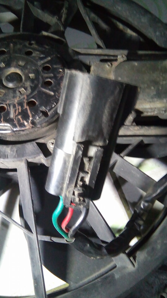

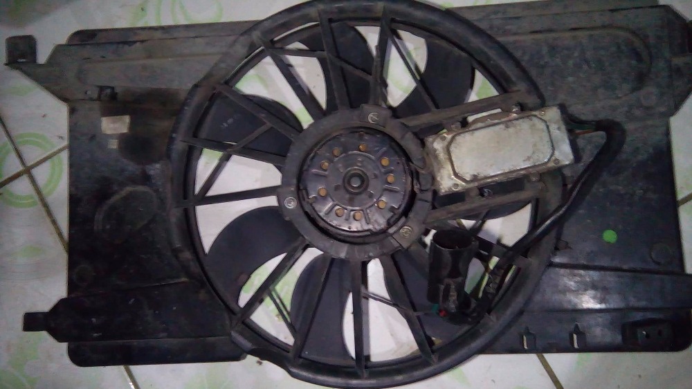

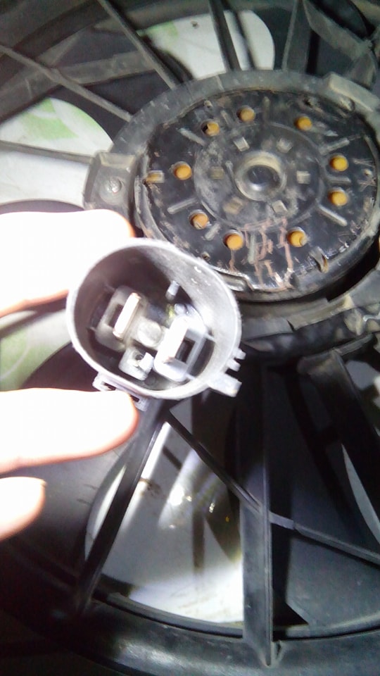

Hello Guys i have ford focus 2009 model (diesel engine) i have problem on my fan here the picture below
anyone know how to test this fan?
thank you guys i wait for your reply THANK YOU
3 wires

Which diesel engine?
The last focus fan control module I did had, power, ground and control from engine ECU
The control is a 12v pull down type circuit.
Scope the control wire and command fan on with scan tool to see if you have control present

Replied by arbez on topic .Ford Focus Fan Control Module
PCM controlled fan
Wiring diagram attached - Thanks BBB Ind.
Black Is Ground
Green is Low Power
Red might be High? Colors different from diagram. Check before you let the smoke out.
Easy diag. Check it out & let us know what is missing.

Red - 12v hot all the time
black - ground
small gauge green wire - control to ecm there 9v on that wire pull down type
