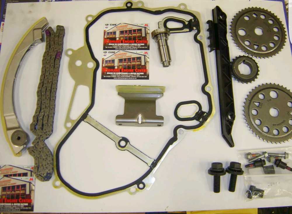

I suspected the problem was introduced, as it wasn't there before the chains were done. This was an OEM kit that was used. I've since looked at them on eBay and there's kits being sold with the two different gears! I'm kicking myself on this. I stripped the chains off and threw them away before I got the new ones trying to save some time!
Luckily it's my car. I bought it for £100 with a suspected head gasket. It was the balance shaft chain tensioner that failed causing the chain to come off the crank gear and so wasn't driving the water pump!

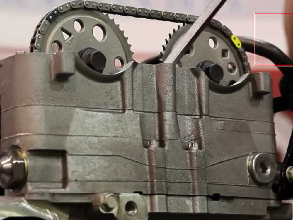

Out of curiosity, was the only difference between the intake and exhaust cam gears the presence of a sensor reluctor? Looks like the tone wheel is machined into the face of the gear itself.

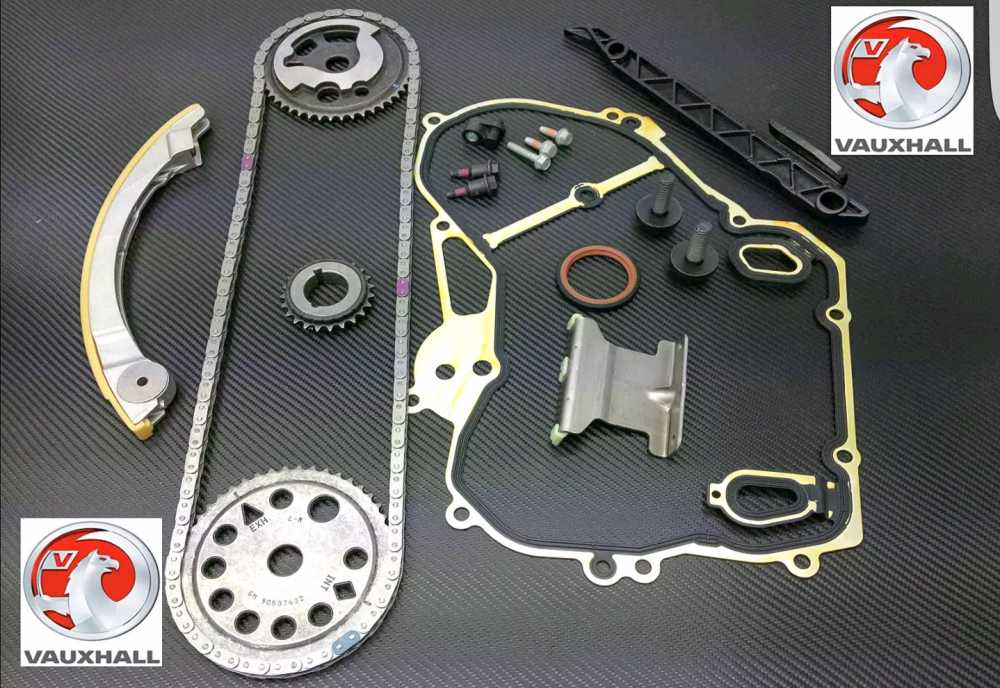

Both kits for this car are the same in every way apart from the exhaust cam gear, although I'll double check this. I was sent the wrong one. I have attached photos of both kits. You'll notice that in one kit the cam gears are the same. It was this kit that was sent to me. The other kit has a very different looking cam gear, much thicker looking! This is the correct gear. You can actually tell by the machined surface by what this gear does.

I've taken a screen grab of the other variant of this engine so you can see where the confusion was. This is from a video that's on YouTube. I hope it's ok to post this.
