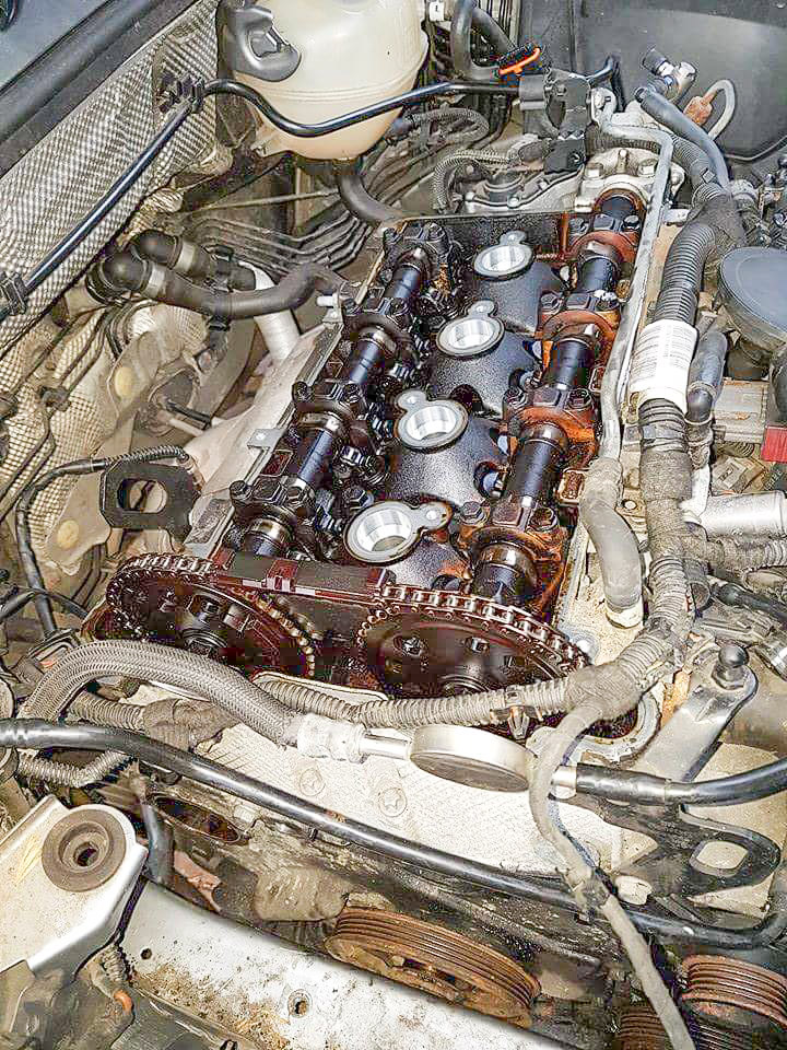

HI guys!
I'm at a loss with this car. It's throwing up a cam sensor circuit fault that I can't fix!
The sensor has a 12v feed coming from a fuse, the sensor ground goes to the ecm, and the signal has a 5v ref (pull down) coming from the ecm.
With the sensor plugged in, and the sensor unbolted from the car, the signal voltage is close to 0v. unplugged from the sensor it reads 5v. I've checked for voltage drops on all wires and they're all good!
The issue with this sensor is there's no signal coming from it when it's bolted to the car.... I can do a bypass on the signal wire by grounding the signal and pulling it down, creating a squarewave, and I can trigger the sensor by passing a piece of metal over it. It's seems there 's an air gap issue between the sensor and the camshaft gear, yet there's nothing out of place!
HELP!!!

10 years 2 months ago #1417 by nohere
Hi Paul! :-)
The signal wire has 5v unplugged. It has around 60mV plugged in. When I place ferrous material near the sensor it pulls it back up to 5v. The original sensor had 763mV on the ground plugged in. Based on that I changed the sensor. I checked the sensor ground and it's less that 100mV with everything switched on (loaded). No drops on the feed either. The car runs but cuts out if you take your foot off the pedal.
I'm not ruling out that I might have made an error installing the new chains, but I don't understand why I'm not getting a signal. It's screaming 'air gap' issue but it really can't be. If anything the gear would be closer if there was an error during assembly.
The transducer I bought needs to go back, as it's faulty. I was looking to use that to confirm a timing issue.
I've had both P0340 and P0341 codes appear at different times. After clearing them one or the other will return.

10 years 2 months ago - 10 years 2 months ago #1420 by ScannerDanner
Replied by ScannerDanner on topic No cam signal on a good working circuit P0340
Can you get an inspection mirror to view the reluctor? How about an image of what that reluctor should look like?
Did you have that gear or reluctor off when you did the chain?
Don't be a parts changer!

10 years 2 months ago #1422 by nohere
Hi Paul,
The reluctant is the exhaust cam gear. There's holes cut out the gear that basically triggers the sensor. I'm not sure if you can make the photo out very well. I had to brighten it up using a mobile version of Photoshop.
  • nohere
  • nohere's Avatar Topic Author
10 years 2 months ago #1423 by nohere
Paul, you have just inadvertently fixed this car by asking for a photo, and you've no idea how dumb I feel right now!
The photo I sent you was before the chains were replaced. I'm looking at that gear in the photo and it's not the same! I've just put two inlet cams on this thing!I've been sent two inlet gears in the kit! Either that or it is round the wrong way! They both have the same part number stamped on them.
This is an air gap problem because it's the wrong gear!!
As much as I feel like an idiot I'm still happy that I knew how to troubleshoot the sensor and was correct about the air gap!
