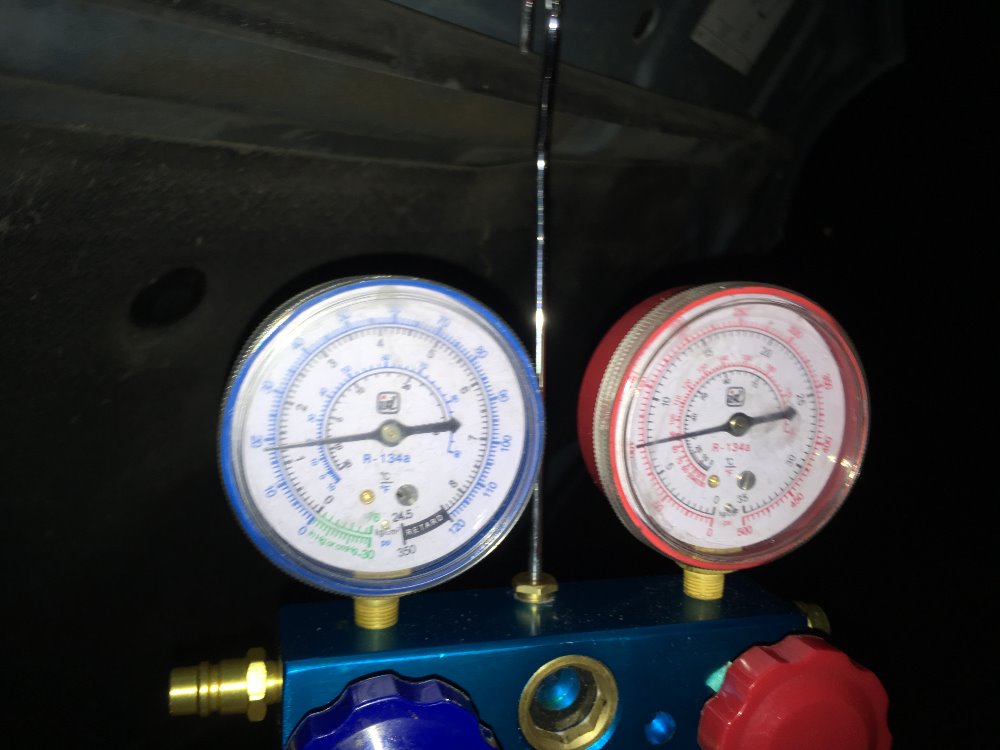

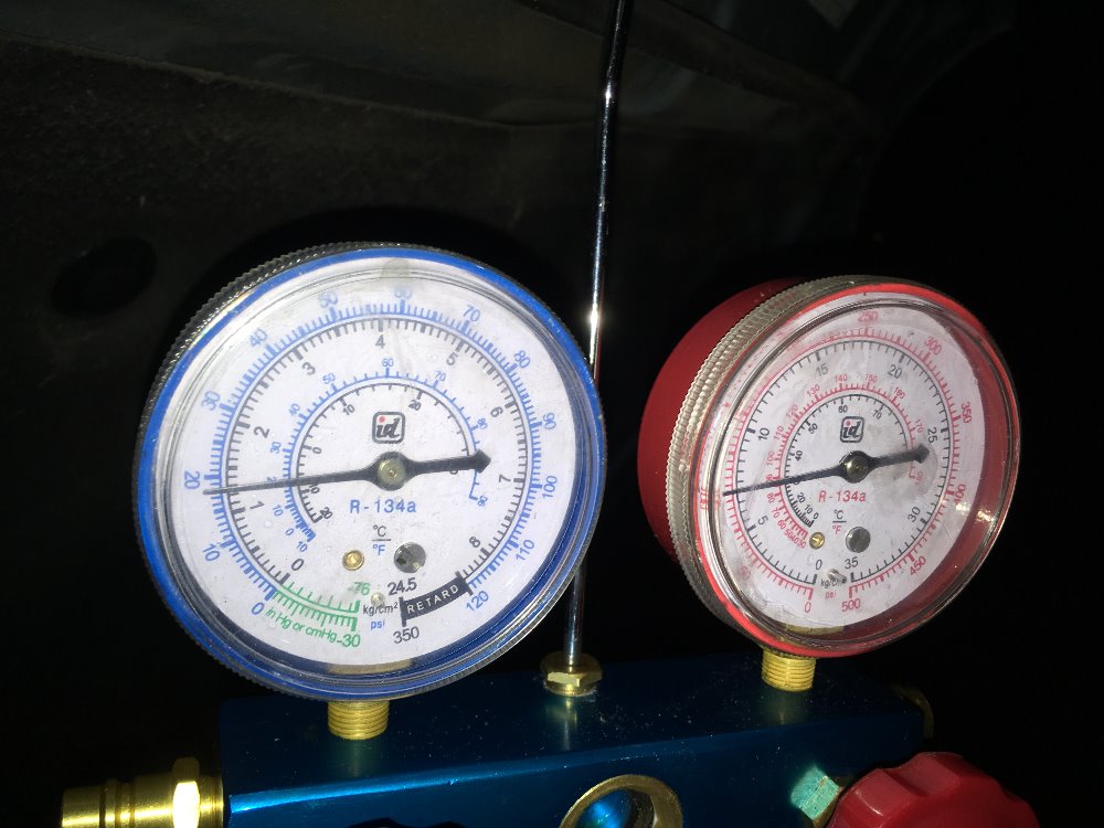

Hello, on the below Youtube video by Paul, around min 3:25 started talking about the low pressure will cycle and the high will rise as the compressor engages and the clutch would spin, I have a Scion TC 2006 the low pressure it’s reading about 20-25, the high about 70, it doesn’t cycle or goes up but the clutch it's spining, I’m thinking the compressor is bad as it’s probably weak to make the pressure rise. I also noticed the RPM change when the AC it’s turn on as describe at the beginning of video. So, all this would mean everything is fine and I would need a compressor, What do all you think ?

What is the pressure engine off engine stone cold ? With R134a the pressure measured in PSI on either port should be roughly the same number as the temperature in degrees Farenheit.

the pressures at rest engine not running are about 90 on both, then AC on 20 low side & 70 high side, the clutch engages, it has a small system capacity of about 16 oz so it has probably 14 oz in it. the evaporator, expansion valve, condenser was replaced this weekend but when filling Freon it's about those pressures.

90 psi of rest psi, then a low , low side and a low, high side pressure. This is an odd symptom. It could be the compressor. What is the history of this. Why were all those other AC parts replaced? When did this problem start?
Are you 100% sure on that charge capacity? I could check too

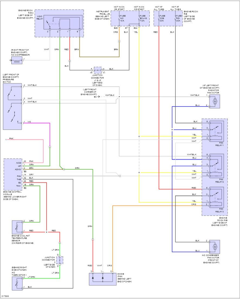

I did check things electrically as shown on your video for the Odessy and the AC clutch was engage. I noticed the RPM changed when turning the AC on as you described on video, knowing the clutch was engage it means the compressor it's getting power, well at least in my understanding; checked the relays for power and ground. I noticed something and perhaps if you can explain this to me will greatly appreciate it so I can learn: on the relays you mentioned there must be two powers and two grounds for the control and load side, well I found this as the key must be on to check powers at relay, without the relay, the load side there was power and ground, the control side there were powers on both, had my test light on ground and show power on both but on one when it showed power on my test light the fan came on, I guess that relay also controls the fan.
can you help me on this or guide me? Maybe if you can post a copy of the diagram here so I can understand with your explanation.

If the clutch is engaging, chances are that everything electrical is ok. I have seen weird pressures similar to that before. A car came in from another shop. They had installed a used compressor . The little red shipping plug was STILL in the compressor!
Are you sure you have removed all shipping plugs? No restrictions?
8 years 7 months ago - 8 years 7 months ago #13237 by Andy.MacFadyen
Replied by Andy.MacFadyen on topic 2006 Scion TC A/C Help
pole71 wrote: If the clutch is engaging, chances are that everything electrical is ok. I have seen weird pressures similar to that before. A car came in from another shop. They had installed a used compressor . The little red shipping plug was STILL in the compressor!
I have been thinking about this over the last few days and that is only idea so far that i makes sense, a blockage in the high pressure side after the compressor outlet but before the high pressure test port.
It explains why the running pressures don't make sense compared the rest pressures. With the system running a lot of refrigerant must be trapped at very high pressure after the compressor but before the HP test port.

Hopefully, these will help with the clutch engagement.
As for trying to find a restriction, there will be a temperature change where there is a pressure drop. 70 psi down to 20 psi is not HUGE, but should still create a temperature change. Can you FEEL a place in the lines, other than before and after the TXV, that the temperature changes for no apparent reason?

I have checked here at the AC relay and seems to be fine, as I jumped the load side the clutch kicks on, when I checked the control side my fans come on, I'm not sure which direction to go to now, I have power on both sides of relay , one thing I noticed now is, when I turned AC on there is no change in rpm and compressor clutch doesn't come on
Any ideas ? Please advise I'm completely lost now

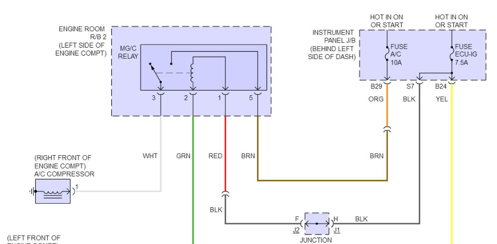

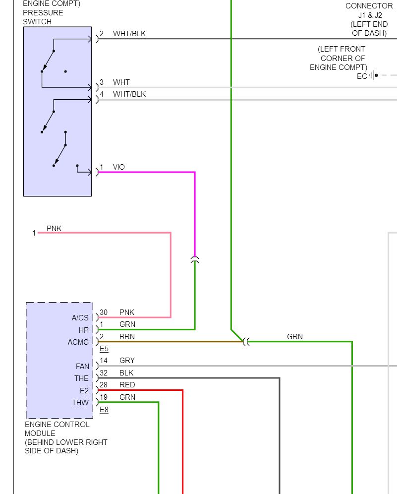

Have you checked the relay, itself?
If the command for AC Clutch is present, the GRN (2) wire at the Relay will show a ground with the relay removed. If it does, all inputs and ecm are fine. The problem lies at the relay, or after.
Back probing the BRN(2) (which becomes the GRN) wire at the ECM to ground, with the relay installed should kick on the clutch AND fans. If it does, you have an input or .ECM problem

Cheryl, at this time I don't have a scan tool until mid this week, all sensors are plugged in, i was able to jump the load side and the clutch came on as it has power, the control side I have power on both and fans come on as the control side controls the fans, I have no freon on it yet as the clutch would not engage, just replaced it and when o was going to charge it I noticed the clutch would not engage. If is getting the fans on it means the relay is being grounded, I have checked all fuses and all are fine, swapped the relay with another one and didn't do anything either, that's where I am.

joshuamal wrote: I have no freon on it yet as the clutch would not engage
You have to start charging to increase the internal pressure before the clutch will kick in. :whistle:
Low pressure cut out.

If the low side pressure gets pulled down TOO much (because the compressor is stuffing all the freon over to the high side), say below 20-25 psi, the pressure sensor will detect this too. The compressor cuts out due to the lack of pressure/freon. After the compressor stops, pressure from the high side bleeds over to the low side via the TXV, or orifice tube. Pressure on the high side falls, Low side rises. Pressure sensor sees pressure on the low side, again, turns compressor on. This is what happens when you hear a clutch kicking on and off ,excessively. It's a sign of low freon.
