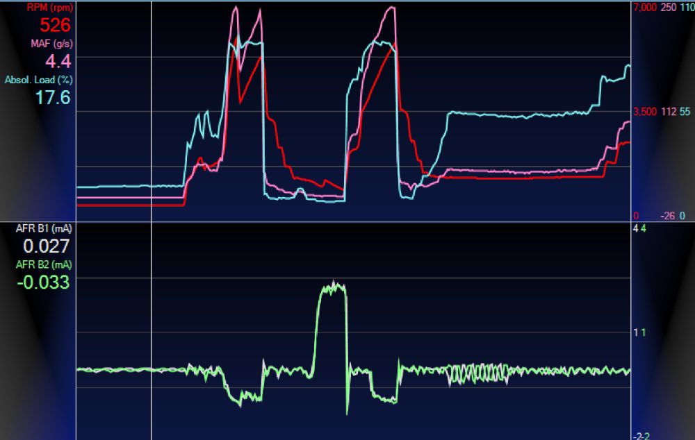

This is directed to anyone with a lot of wide band sensor readings See in this thread reply #64954. see the jpeg 2024-03-19. Bank number 1-86 ua. Bank number 2- 35 ua. Does this look right??
The following user(s) said Thank You: 52Tele
2 years 5 months ago #65353 by Tyler
Replied by Tyler on topic F150 No code intermittent misfire issues
You mean this post, bills?
www.scannerdanner.com/forum/post-your-re....html?start=40#64954

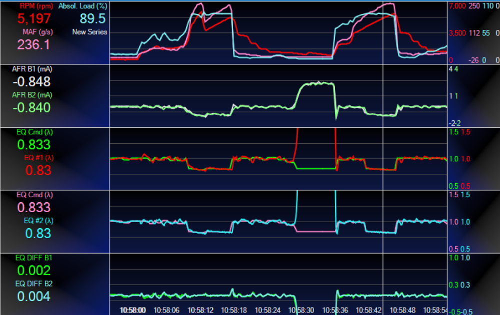

Those values seem pretty normal for Ford AFR's. For reference, this is off a known good 2011 F-150 5.0L at idle and during a WOT run:
HPTuners displays the AFR's in mA, but the Autel shows uA, so there'll be a little mental math involved. .027 mA would be 27 uA.
I find that fluctuations of +/- 100 uA is pretty normal for those systems. That's not a rule, just a trend I've noticed.
As long as the commanded equivalence ratio and the actual generally agree, I wouldn't sweat the AFR's too much. Here's another capture of a test drive with the equivalence ratios for both banks, plus a math channel of the difference between commanded and actual. The only real difference comes during decel fuel cut off:

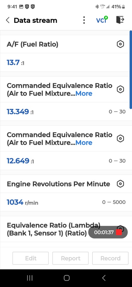

Hey guys I also noticed something odd when I plug in either scanner. There is a Pid in the Ford data stream for air fuel ratio and it states 13.7:1 instead of 14.7:1 I'm pretty sure it used to say 14.7:1. Any ideas on this?

Here is an image of what I'm talking about on top.
