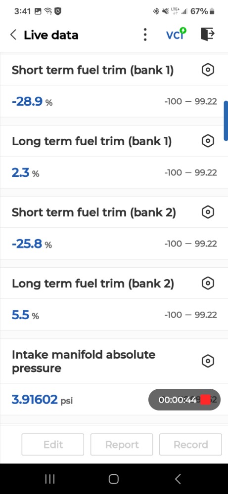

2 years 2 weeks ago #64900 by 52Tele
Replied by 52Tele on topic F150 No code intermittent misfire issues
OK thanks. Today while at lunch in the truck in park with ac on I had really rich fuel trims anywhere from -10 to -28.79.

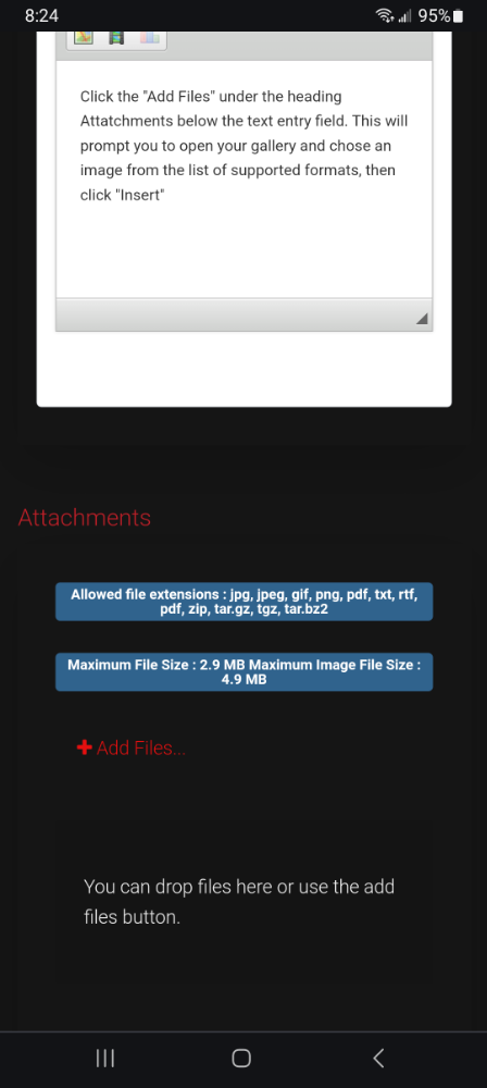

  • Noah
  • Noah's Avatar
2 years 2 weeks ago #64906 by Noah
Replied by Noah on topic F150 No code intermittent misfire issues
Click the "Add Files" under the heading Attatchments below the text entry field. This will prompt you to open your gallery and chose an image from the list of supported formats, then click "Insert"

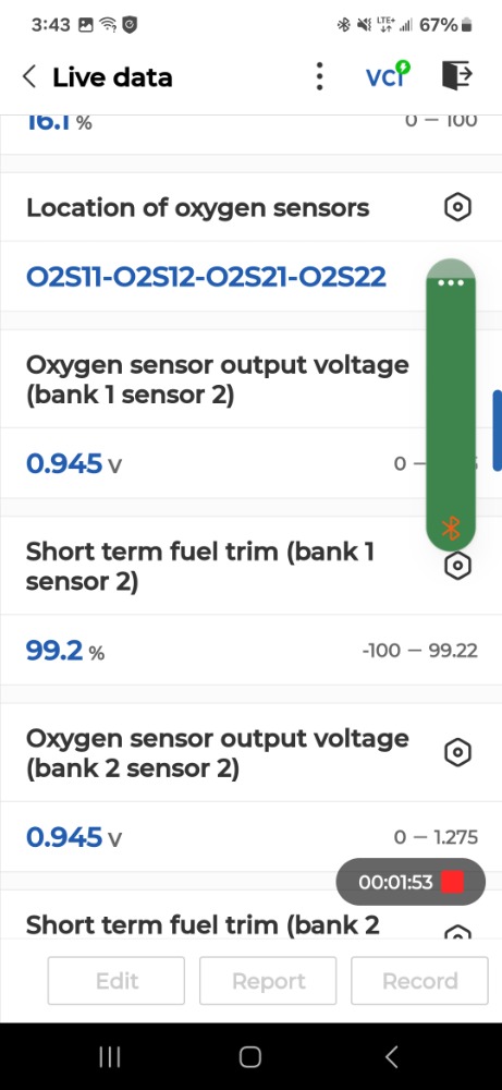

2 years 2 weeks ago #64910 by 52Tele

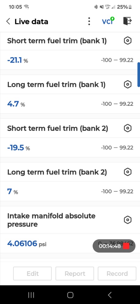

Sorry the rpm wasn't on there but these were at idle. Twice after pulling up and stopping at a red light. And the one with short term trims of  -21.1 bank 1 and -19.5 bank 2 that screenshot was at lunch parked with ac on. Rpms were anywhere from 530-600
2 years 2 weeks ago #64913 by bills4065
Replied by bills4065 on topic F150 No code intermittent misfire issues
Here is where you are at: at idle both stft taking fuel away,- both downstream O2 sensors at .950 volts do suggest rich. What were the upstream O2 sensors reading? At 3469 rpm both banks are running lean. Noah's suggestion of pids to monitor great idea. Your idle readings were taken in closed loop. Has truck had an oil change lately?

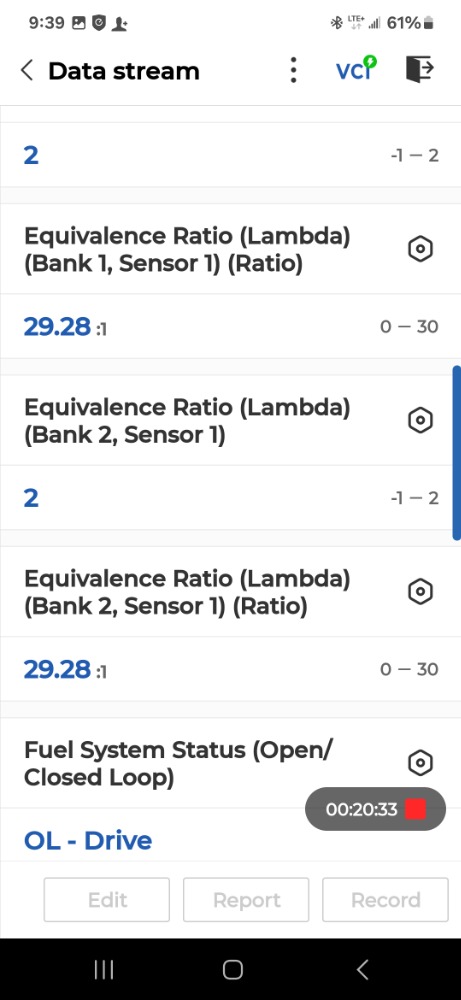

2 years 2 weeks ago #64923 by 52Tele
This was while doing a deceleration coast.

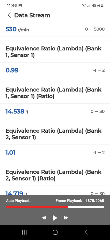

  • 52Tele
  • 52Tele's Avatar Topic Author
2 years 2 weeks ago #64924 by 52Tele
This was a random idle capture of rpm and upstream data.

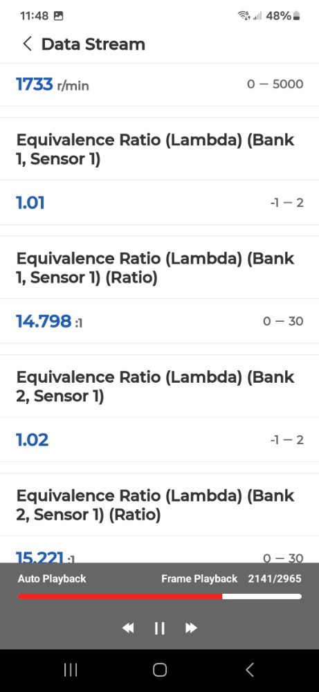

Another random capture at 1733 rpm while driving.

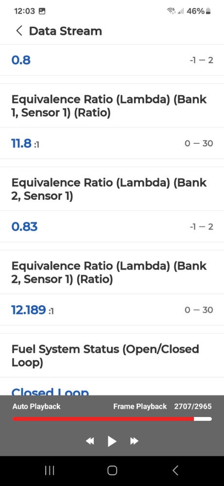

  • 52Tele
2 years 2 weeks ago #64926 by 52Tele
This is right after going back into closed loop from a deceleration. To me this doesn't seem normal but again trying to learn more if I'm wrong. The rpms were 931.
