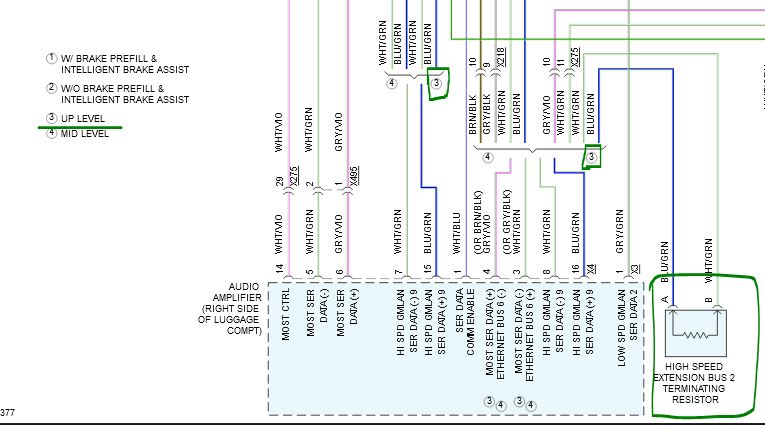

2 years 2 days ago - 2 years 2 days ago #64174 by Chad
Replied by Chad on topic 2017 CTS V Canbus delete
Here is the network schematic for the 2017 CTS.
Total network resistance should be 60 Ω....two 120 Ω resistor, in parallel.
>   120 Ω + 120 Ω = 60 Ω   (One resistor at each end of the network)
As Noah pointed out, you are missing a terminating resistor. The schematics are for multiple option packages. You must decipher the schematic to match what you have. For example:
Here,  a "3" corresponds to the "up level" package, and one of the terminating resistors is an external resistor.
Last edit: 2 years 2 days ago by Chad.
2 years 2 days ago #64175 by Chad
Unfortunately, you can't see the "white" circuits.

2 years 2 days ago #64176 by TexasGrench
Replied by TexasGrench on topic 2017 CTS V Canbus delete
Precise Schematic VERY HELPFUL!
Great to know that the resistor is external, which means it was mostly cut out of the circuit and also means I can get one and add it back.
I will locate the circuit that appears to be near the Harmon Kardon/Onstar device and report back after 4 pm CST.

  • TexasGrench
  • TexasGrench's Avatar Topic Author
2 years 1 day ago #64182 by TexasGrench
Better news but no cigar just yet.
This time when I scanned the system after troubleshooting I was able to see three more modules. The gauge cluster, audio amp, performance data module, along w/ keyless entry module and ac/heating.
Troubleshooting: I was not able to locate the external resistor BUT, I was able to read 120 ohm on both sides of the X275 connector and at the X276 connector. With three BLU (high) connected at the crimped junction that I cut, I read 120 ohms at the junction, 125 ohms across the OBD2/DL, and 2.5 high/1.5 low across at OBD2/DL. Once I connect the fourth BLU at the junctions the short returns. I traced that BLU wire to the shifter indicator module, so I will start there tomorrow.
