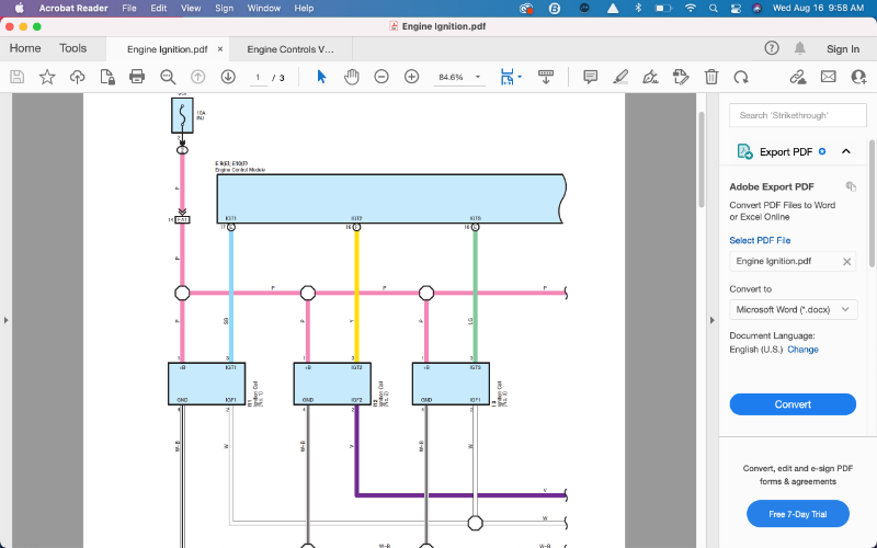

As for spark: Since you've swapped/replaced coils and spark plugs, you shouldn't be concerned with secondary ignition, but rather ignition control coming from the ECM/PCM. You can test both control as well as current to see if the primary side is working. Current is tested via a current clamp, and often the best way is to install a fuse buddy at the fuse that powers the ignition coils (and you can do the same for fuel injectors), and use your current clamp on that wire that goes between the 2 terminals on the fuse.
Ok, I’ll have to order an amp clamp.
Can I also measure resistance in the trigger wires from the ecm to the coil? It’s an intermittent problem, so if the wires are the issue, im guessing I’d see a slightly higher resistance than the other trigger wires?
2 years 1 month ago #62577 by JoshuaK
Do you have a 3- or 4-wire coil? If so, the trigger wire is very low current -- it's just a 4-5v signal firing a transistor in the coil, so resistance isn't going cause this kind of a fault.

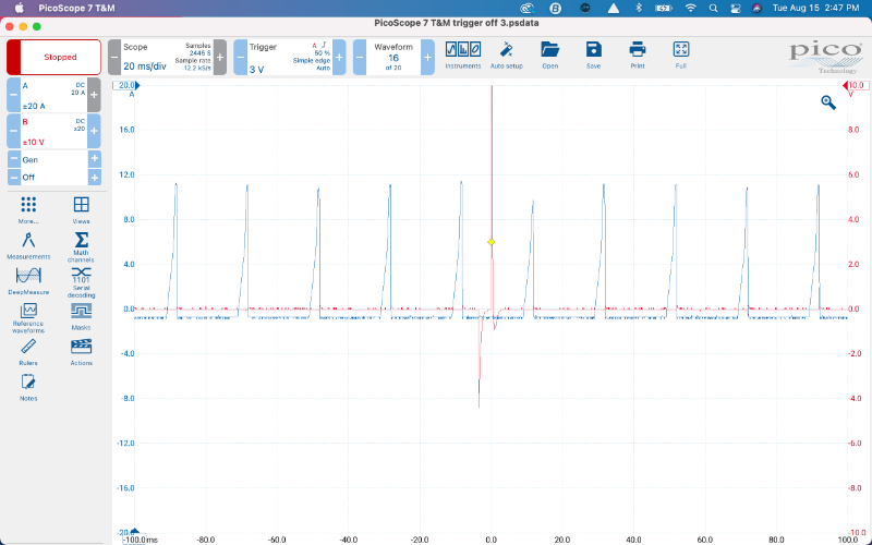

   I was able to mess with it a little yesterday, but not enough for all the tests needed mostly because I got unexpected results from the first one. I still need to take it on an actual ride with the scope hooked up. I hooked up the current clamp to the power feed for all coil and then triggered off of cylinder 3 injector. What I see is consistent looking waveforms on all cylinders except cylinder 1 which has the same curves, but is a lower amperage. Cylinders 2-6 all show an average of 11.3 amps but cylinder 1 is at 9.1 amps.
This threw me off because I was expecting to see an issue on 3, so I kept retracing wiring to make sure my trigger was on the right injector.

2 years 1 month ago #62638 by juergen.scholl
Replied by juergen.scholl on topic Cannot fix Single cylinder misfire under load.
Your sample rate seems to hover around 6ks/sec which would be very low......
You may have to account for that the injection event does not take place anywhere near TDC compression, especially on port injection but often time also on GDI, depending on the operation mode. So make sure your sync event really happens when it it should in order to get the cylinders identified corecctly.
Eventually you may want to sync on a specific coil using the trigger signal or a secondary wand/probe, just to avoid possible confusion.

I did this same test again and you are correct. I triggered off of number 3 coil and it lines up with the one with one that is lower in amperage than the rest. Now my question is, why?

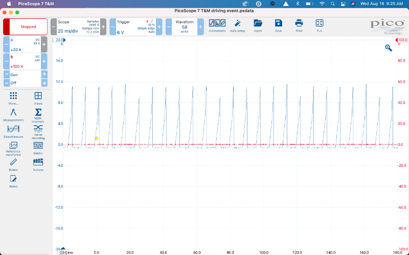

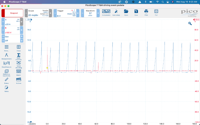

  I was able to drive the truck with the scope hooked up last night and made the misfire happen. On the picoscope, I'm seeing that the red channel, which is spark, simply turns off and stays off until I'm able to get to side of the road and turn the engine off and restart it. I don't see anything leading up to that though. The amperage draw is still lower than all the others, but it doesn't change throughout the event.
After restarting, I drove home just a few miles away. When I pulled into the drive, I could feel the miss at idle. I watched the scope and could see there was no spark on 3. I blipped the throttle and the spark came back. Why would it do this?

2 years 1 month ago #62642 by juergen.scholl
Shouldn't be too tough to figure it out:
Or there is a problem = voltage drop or on the positive or ground side leg of these specific #1 coil circuits or it's the coil itself that got higher primary resistance than the other coils thus limiting current flow. Voltage drop testing will be your friend....
I didn't follow this thread from the beginning so I have a couple of questions:
Is the #1 coil same brand as the others?
When swapping coils will this #1 coil while put in another cylinder draw less current as well?
Will another coil put into #1 cylinder now draw less current than it did in the cylinder where it came from?

Just saw the images....If the red channel was spark why wouldn't it line up with the current ramp?
The coil may be shut down intentionally, you may want to check/verify that the injector is also shut down at the same time.

I was wondering the same, but this is my first time using a scope. I am using the pink wire after the fuse for the current and the light green wire out of the ecm for the coil.
2 years 1 month ago #62646 by JoshuaK
If you zoom in and look at your primary coil dwell time, is it exactly the same amount of time for all coils, or is #3 a shorter time? If so, that would be the PCM/ECM.
Otherwise, swap coils and see if the lower current changes to another cylinder. If not, then do the voltage drop testing at coil #3. If all checks out, replace the ECM/PCM. However, without checking the direct injector waveform patterns, there is a chance that this lower current on #3 coil is not THE problem, and that the problem lies elsewhere such as the injector.

Compare another cylinder's IGT signal to its current ramp, just to make sure it looks similar or not.
I understand the misfire occurs when putting the car under load. This may go along with a shift from gdi to port injector during this load increase.
You may want to hook the two channels of your scope to both injectors of a non misfiring cylinder and make the engine misfire. Then look for a possible shift between injectors. Then repeat the same on the misfiring cylinder #3. and compare.
