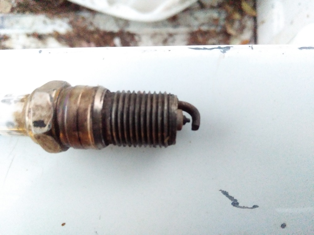

8 years 11 months ago - 8 years 11 months ago #9725 by JeremyS10
Replied by JeremyS10 on topic I'm at wits end.
How does this spark plug look to you guys? It has maybe 2000 miles on it. It's about 5 months old, and I pretty much just drive to work and back, which is about 20 miles round trip.
Last edit: 8 years 11 months ago by JeremyS10.

8 years 11 months ago - 8 years 11 months ago #9726 by JeremyS10
Ok I did number 3, and it reads 40 psi. Number 4 reads 50 psi.

8 years 11 months ago #9751 by Noah
Replied by Noah on topic Pictures
Yikes! Something terrible happened in there for sure.
