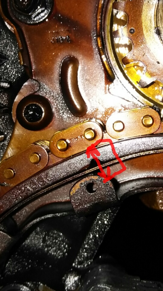

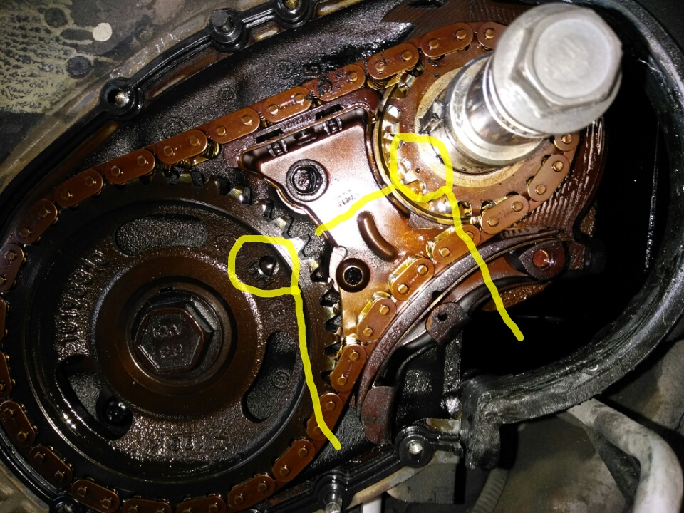

In those pictures, the one with red shows a gap that I've read should be no more than 8mm. Mine is much more. The one with yellow shows the marks, and how they don't quite line up. I couldn't make straight lines, but they do show the direction.
8 years 11 months ago #9616 by Chad
Replied by Chad on topic Pictures
The chain is stretched. I would replace the sprockets, chain, and guide/tensioner. A timing set for that engine is only about $50.

So is that what happened, or what is happening now?  If it suddenly started running like crap, and then died, and now cranks over kind of funny but won't start to save it's life, that doesn't sound like the symptoms of a stretched chain to me.  Chain stretch occurs over time, not all at once.  What you describe sounds more like right out valve train damage.
The service info I have states that:
If the distance between the hole and the unworn surface of the timing chain tensioner shoe is more than 8 mm (0.314 inch) , replace the tensioner, timing chain, and both sprockets.  Your measurement is "Much more", and the timing marks are clearly off.  I wonder if the engine might jumped timing and bent some valves.
I wasn't sure if a 2.2 push rod motor was an interference motor or not, but a quick Google search showed instances of jumped chains resulting in bent valves. I don't want be a doomsayer here, but I think there is the potential for more damage than just the timing components.
Here's to hoping I'm wrong!

Looking at that picture of my timing chain, it seems obvious (now that I know) that my chain is stretched. But I'm wondering about whether or not it did jump teeth. My sprockets don't line up, but they are so close, if I were to somehow move one gear, just enough to adjust one tooth, it would pass the line up marks and be off on the other direction. The gap, or distance, I'm not sure how that would be measured, is less than the distance between teeth on the gears. It seems like the only way to line them up, would be to shorten the chain a tiny bit, otherwise it would move too much. For instance, if the chain jumped one tooth, and that would take the timing off by 10 degrees(random number for example), then the marks are currently only about 5 degrees off. So if I adjusted the chain one tooth, it would be either 15 degrees off of center in the clockwise direction, or 5 degrees off of center going counter clockwise. By looking at it, it appears that it's only off because the chain stretched. So, taking that into account, unless there's something I'm not understanding, or seeing, It doesn't seem like it jumped. And if it didn't jump, the pistons wouldn't hit the valves, correct? I apologise for being like "well if this, what about that", this is what I've been going through for the last several weeks. I greatly appreciate you guys taking the time to help me figure this out. It seems like everyone I know is more in to Facebook, than mechanical stuff. Hell my brother graduated from motorcycle mechanic school, and had to ask me if red is positive. So there's really nobody I can ask for help.
