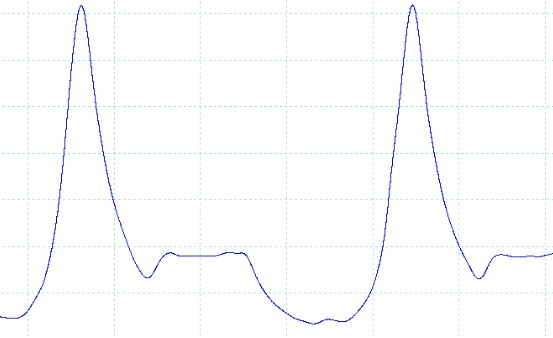

7 years 11 months ago - 7 years 11 months ago #23712 by Andy.MacFadyen
Replied by Andy.MacFadyen on topic DIY Pressure Transducer
If by notchy you mean you can see distinct steps in the trace it would suggest the sensor is mis-matched to the range you are measuring. For a running compression test a zero to 200 psi works well. The one below was made with a zero to 300 psi sensor. Also of course switch the connection wires to either a twisted pair or co-axial BNC as close as possible to the cylinder. On the scope settings make sure peak detect is turned off.

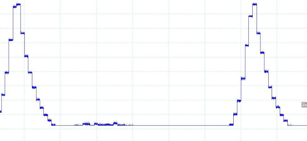

7 years 10 months ago #24311 by Sooknanan
Replied by Sooknanan on topic DIY Pressure Transducer
I believe i may be a victim of a crappy transducer. I bought 3 from amazon, tried the 0-300psi for a cylinder waveform and it came out like this.
Are any of my settings wrong that can cause this or should I just buy the transducer from the ebay link provided on page 1. Thanks in advance.
7 years 10 months ago #24312 by Andy.MacFadyen
Have you checked the output voltage against shop air -- wondering if you have been given a 3000psi sensor ? A lot of Chinese suppliers aren't too careful about what they send out.
