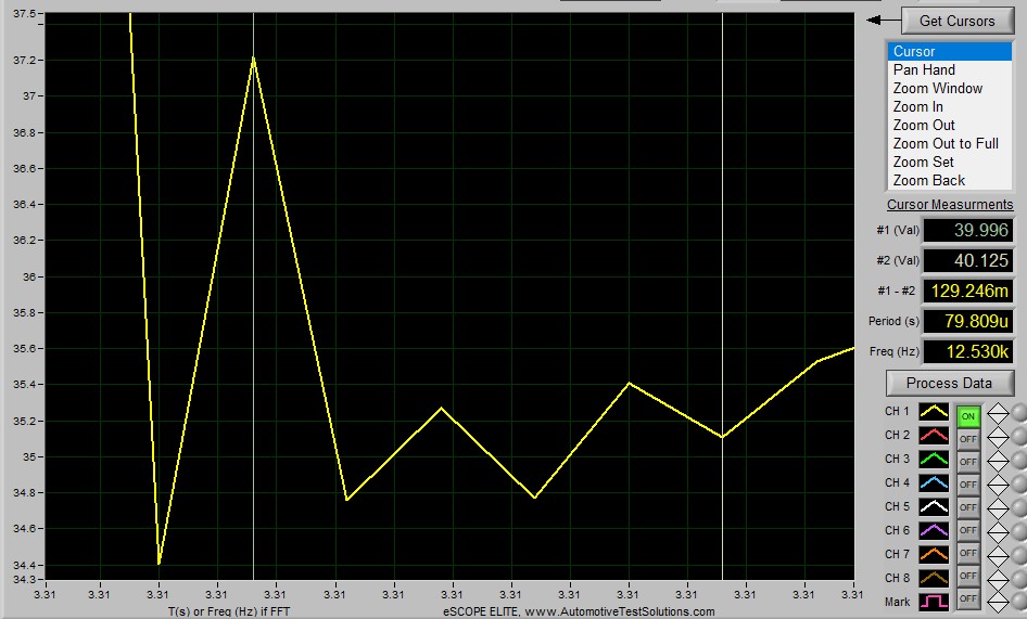

Ok so the fancy scope helped, though you can do the same with the frequency setting on a Pico/others. Seen a good few of this guys videos but this is an amazing catch even by his high standards!
5 years 8 months ago #46868 by Chad
Replied by Chad on topic Who would have caught this ?
Wightscope wrote: Ok so the fancy scope helped, though you can do the same with the frequency setting on a Pico/others.
Features like this are what set the eScope apart from other scopes. Yes, you can do this with other scopes. I have used the the Pico to graph crank frequency many times. Each time, there is a "tuning'', as I call it, process to go through. Dialing in the proper frequency range, applying the correct amount of filter, setting the proper zoom level, plotting out and labeling cylinders... The eScope does all of this for you. Very nice! It is designed to be stream-lined for this kind of things. It has become my preferred scope.

My honest opinion is that I love it. But, I encourage you to check, and compare, specs before you make your decision. Many people seem to think that it has the sampling power of Pico. It doesn't. In fact, Snap-on scopes have more sampling power. The uScope has the same sample rate as the eScope. It is more than suitable for most automotive applications. Here , is my first opinion/review/comparison with Pico. It has been awhile, and I could add a lot more to that comparison. Both, good and bad. But, it is a good first-impression comparison.
I love the eScope. But, I would not want to be without a Pico, either.

Chad wrote: I have used the the Pico to graph crank frequency many times. Each time, there is a "tuning'', as I call it, process to go through. Dialing in the proper frequency range, applying the correct amount of filter, setting the proper zoom level, plotting out and labeling cylinders...
That and "guessing" what RPM is doing around the sync notch.
Couple other options that appear to have the ability to "smooth out" the sync are the USB Autoscope and the Rotkee. If you don't want to watch the entire vid it gets interesting at around 9:40 ;)

Wightscope wrote: Many people seem to think that it has the sampling power of Pico. It doesn't. In fact, Snap-on scopes have more sampling power. The uScope has the same sample rate as the eScope. It is more than suitable for most automotive applications.
Shared 1 MS/s is very low considering the price point.And the file you posted in the "review" thread looked like it was only hitting about half the claimed sampling rate.
5 years 8 months ago - 5 years 8 months ago #46888 by Chad
Matt T wrote: That and "guessing" what RPM is doing around the sync notch.
YES! That is a HUGE plus! I have been wanting to check out the USB Autoscope. And, I just started hearing about Rotkee. :dry: So, many scopes. So, little time (money). :whistle:
Agreed. It doesn't go, totally, un-noticed, either. If sample rate is what you are shopping for, eScope would not be my recommendation. Still, I go for the eScope, first. The appeal for me is the lack of channel set up. I, REALLY, like that. Going back to the Pico, I get a little frustrated at have to set up the channels. :( I get even MORE frustrated when I set the scaling wrong on a channel, and have to RE-capture. :angry:
I justify the price with/by all the EXTRAS. Not, the sample rate. Take all the EXTRAS into consideration and the price is...well, still pretty hard to swallow.:woohoo:
I, still, highly recommend the eScope. But, if your on a budget and don't have a Pico, I would recommend getting the Pico, first.
