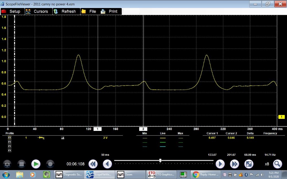

The Camry had it's turn in the shop today.
This is the capture taken in cylinder after changing the cat:
You can see that through the over all range that exhaust pressure remained steady. A great improvement over the other cat.

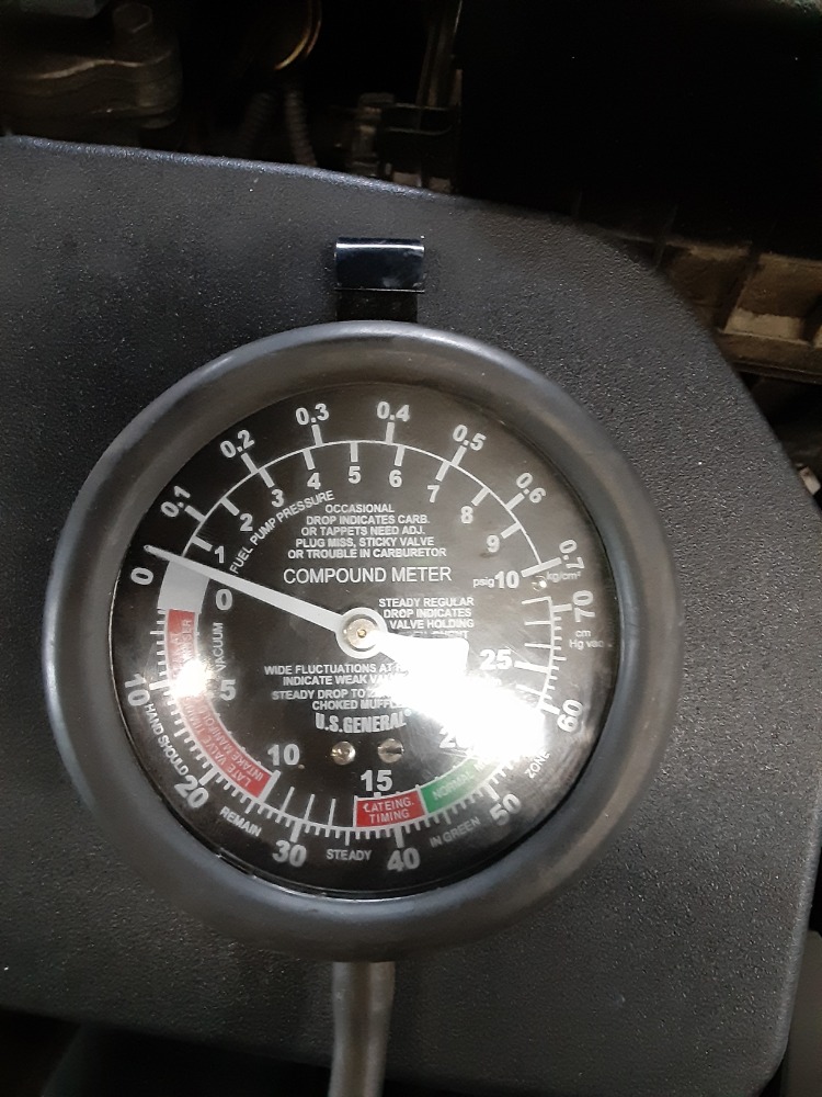

Gauge pressure confirmed the restriction had been removed.
However, power was not restored. So, in the eyes of the boss-man and the other mechanics, I blew the call.

I installed a fuel pressure gauge to appease the boss. Fuel delivery isn't on my list of suspects based on my prior test drive data.
To T in, i removed the entire snorkel, MAF, filter, etc.
It didn't want to run, but i managed to give it the magic boot and noticed that after a bout of bucking and farting that it was free revving better than it ever had :S ...
I removed my pressure gauge, installed the air cleaner assembly and suddenly the car has 95% more power.

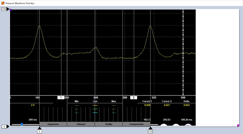

This the in cylinder idle waveform as it is now.
There's still the tail at the end of the exhaust plateau that suggests the exhaust valve is closing too early, but you can actually drive the car now, and I'm not sure why. :S

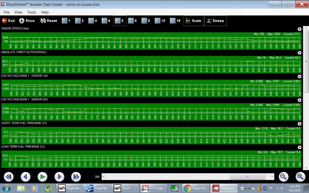

You may have fixed a restriction somewhere in the air intake. Do you have MAF and MAP PIDs in your pre-fix scan data?

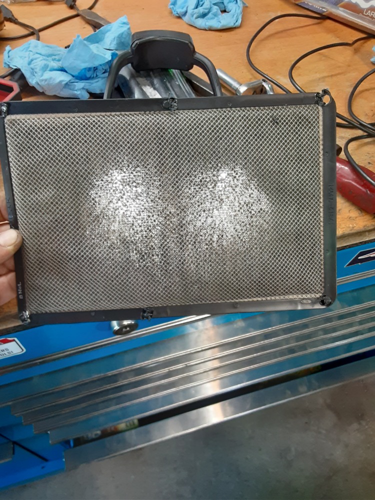

There was this bit of under britches integrated into the lid of the filter housing assembly.
And there were some leaves in the bottom of the box, pre filter, but I don't think either one explains the change in symptoms.
It still barely ran with all of that off the car until I gave the throttle a right boot work out.
I returned said under britches to it's place in the filter box and it still runs just the same.

One quick thing you could do is have a look for camshaft position PIDs. Might tell us whether the cam timing is screwed up or something the PCM is doing.

The EVO is advanced, but it's closing almost on time. This to me can be an indicator of valves out of adjustment. A tailpipe waveform tailpipe waveform along with the in-cylinder could confirm this. But the opening early with the spike does look like an advanced cam. Pretty nice capture with that sensor.
