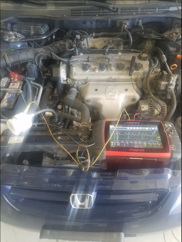

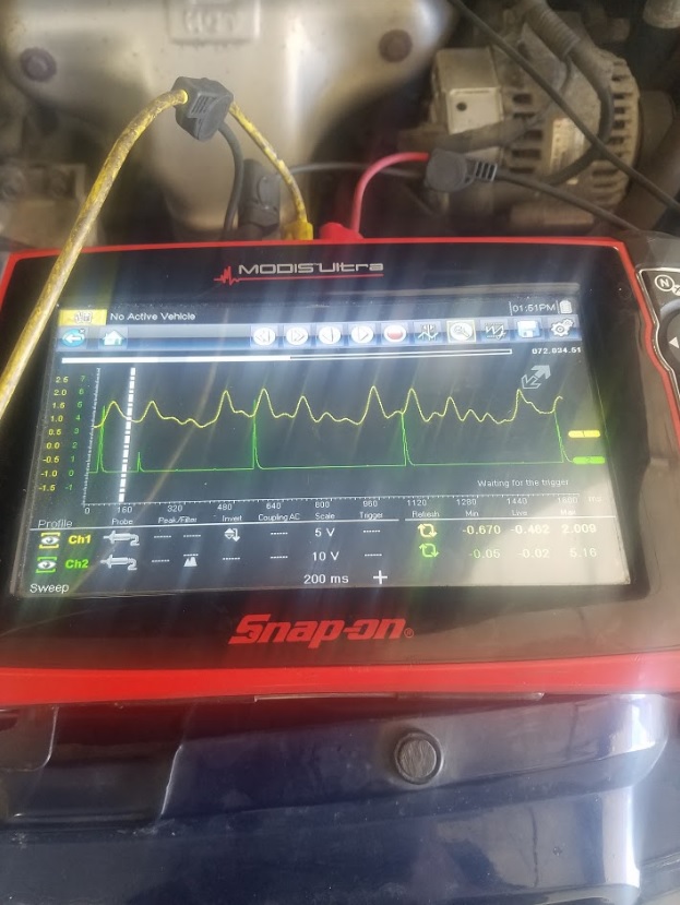

Had the chance to expand on this test Ro-longo first posted about. 2000-something Accord came in with an obviously blown head gasket. While I'm waiting, I connect the homebrew pressure pulse tester to the radiator and an ignition sync. Please excuse the poor photography. :blush:
If I'm looking at it right, three cylinders (#1, 2 and 3) are blown. :lol:

It looks like the Homebrew FLS work pretty well. Do you have pics of the build?

Actually, it's dead right now. :lol: :blush: I was using it on a suspected blown head gasket, but didn't suck enough coolant out of the radiator before cranking the engine. Filled the sensor to the brim.
I can get pictures for anyone interested. Got the electronic bits from Digikey, and the PVC from Home Depot. I was going to buy a Nicholson pulse sensor, but the website is down.
Replied by Tyler on topic Combustion leak detection
Chad wrote: It looks like the Homebrew FLS work pretty well. Do you have pics of the build?

This is a pretty cool application for the FLS too
