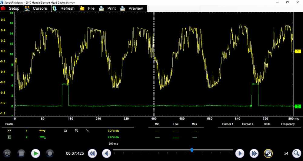

Speaking of head gasket failure testing. This is what I got when I stuck a fuel tank pressure sensor in the radiator filler neck of a Honda Pilot with a blown head gasket.

Thats interesting. Would you mind going over the set up?
I'm guessing the engine was probably cold, system not pressurized? And what's your synch trace, and did that help ID the cylinder with the problem?
I'm currently salvaging FTPs out of GM tanks at the junkyard to make a rig like that, I never would have thought to try it on the radiator to check a head gasket..

Ro-longo wrote: Speaking of head gasket failure testing. This is what I got when I stuck a fuel tank pressure sensor in the radiator filler neck of a Honda Pilot with a blown head gasket.
Hey, that's cool! :cheer: Like Noah asked, setup? Very interested to try this.
Just curious, how bad was this head gasket failure? Like, misfiring? Or, just overheating?

9 years 10 months ago #4089 by Ro-longo
Replied by Ro-longo on topic Combustion leak detection
Noah wrote: Thats interesting. Would you mind going over the set up?
As far as the set up goes, Cold engine, and water pump belt off. The sync in #1 ignition coil trigger, I was trying to see if I could identify the which cylinder but it didn't work as I wanted.
And for the tool set up I used a standard fuel tank pressure sensor with a 1K ohm resistor on the B+ feed to drop it down to about 5v. Then I used an adapter out of my LANG Exhaust backpressure tester . If you follow that link, its the little rubber cones.
When I got the vehicle all the RO said was "2nd opinion on if it needs a motor". I had pulled it in my bay over the weekend and when I went to start it the next Monday it would not start, even though two days prior It started and ran fine. After doing all the basic checks for a crank no start, I took the radiator cap off and noticed pressure in the cooling system. That's when I decided to put a pressure transducer to see what results I could get.
When I did it with the water pump belt on I got a very different signal, then I took off the belt and got that signal. I have the trace on a/c coupling and inverted, the GM pressure transducer is aboutn1.5v atmospheric pressure and pressure makes the voltage go towards zero. I did a running test as well but forgot to save the file. :(
I have done this test on a couple of other vehicles and I can see a pressure increase but at a steady rate. The Honda was a very bad failure. And both other times the engines were cold, I don't think this will work on a warm or hot engine.

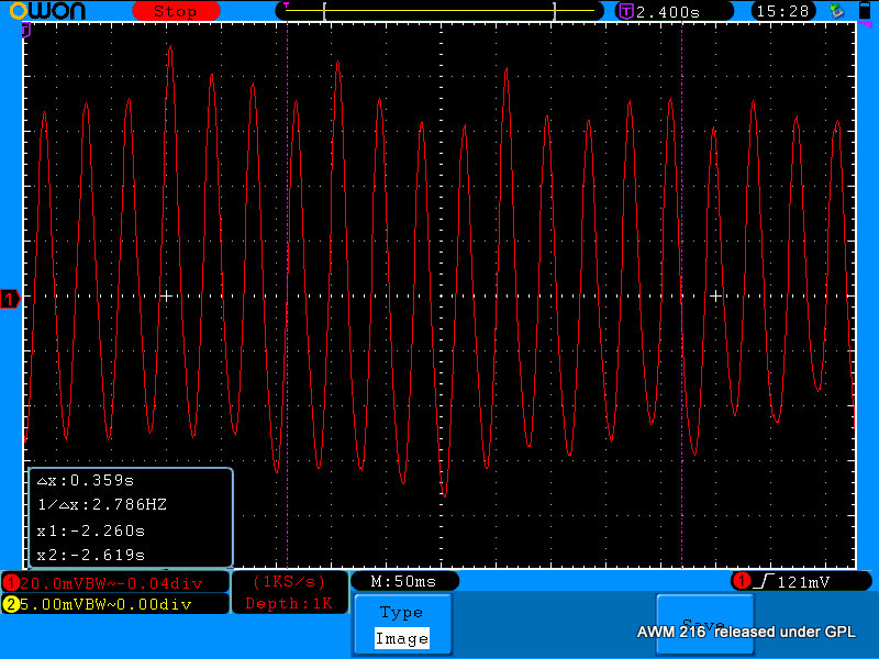

9 years 10 months ago - 9 years 10 months ago #4129 by Andy.MacFadyen
Replied by Andy.MacFadyen on topic Combustion leak detection
Even if the head gasket is perfect you will see a regular pressure pulse in the coolant tank.
This known good 4 cylinder at idle was taken with a FirstLook style sensor, with a hardware filter to take out the higher frequency noise. Pulses corespond to each compression stroke.

9 years 10 months ago #4130 by Noah
Replied by Noah on topic Combustion leak detection
Andy.MacFadyen wrote: Even if the head gasket is perfect you will see a regular pressure pulse in the coolant tank.
I was wondering if that would be case. You answered the question before I could ask it, thanks Andy!
Was that capture with the water pump belt off like Ro-Longo's capture?
Obviously that would be unrealistic if the pump were timing chain/belt driven.
9 years 10 months ago - 9 years 10 months ago #4135 by Andy.MacFadyen
The water pump was driven of the cam belt, the low pass filter took unwanted water pump noise out.
