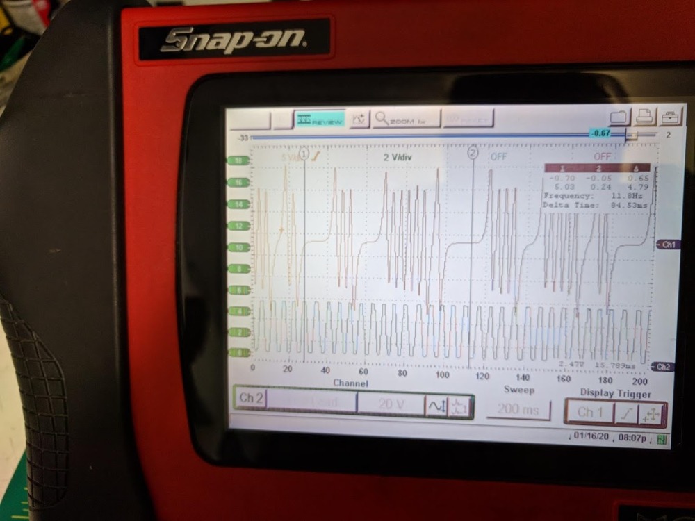

Great suggestions here! However, unless I missed it I didn't see the SnapOn MODIS on the list of affordable 4 channel portable scopes. It's basically the big brother of the Vantage Pro and the older model to the Verus with all the guided component tests as well as a full scanner etc.
I purchased mine about 3 yrs ago on ebay, came with the 14.4 software. Then I pieced together all the components (battery, charger, test leads, diagnostic keys, OBDII cables etc). I think I have $750 into it but I see them for sale on ebay for around $500 time to time. What I really like about it is the 4-channels. Say you need a cam/crank correlation and you want a sync with the ignition coil or injector, you need a 4 channel scope. Or you want to see data from the two banks on a 6 or 8 cyl engine with a sync, you need a 4 channel scope. I've considered selling mine to move up to the 4 channel PICO Auto for a couple of features I'd like but as a DIYer I can't bring myself to swallow the price tag on those bad boys. I may trade up to a Verus though.
Unfortunately the screen on my MODIS is just starting to go dim/dark from years of use which still isn't too bad actually but for crystal clear pic I just connect it to the my 20in LCD or copy the files over to my PC and view them in the free ShopStream software.

The Modis is a good choice at the right price point.
That was my first scope as well
