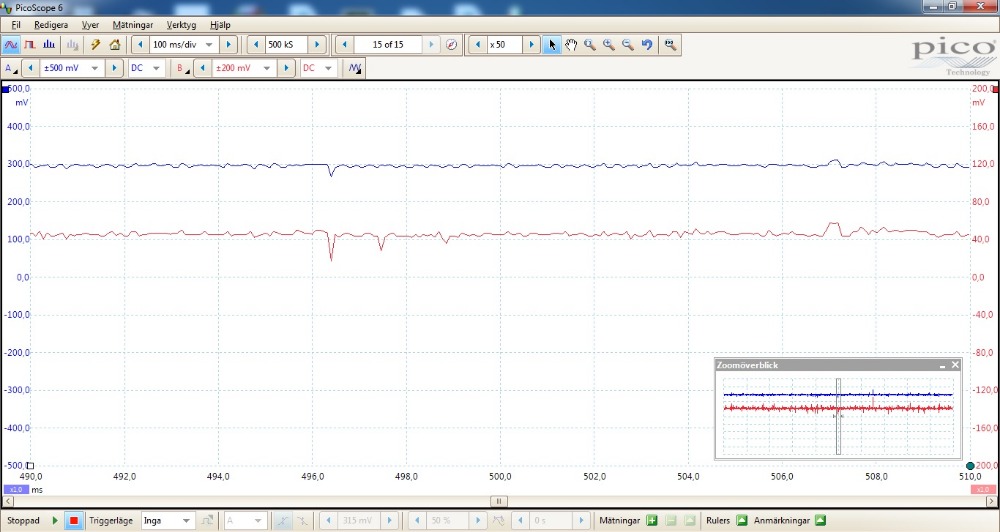

I have Pico 2206 and knowing nothing of scoping I guess I dont get much out of it - this is what the best result looks like for lambda sonds from a 2012 year natural gas Passat:
I only have two of the basic probes, like the one that follows with this scope.
When I tried to put the settings as prescribed in Automotive software - the results looked grazy....

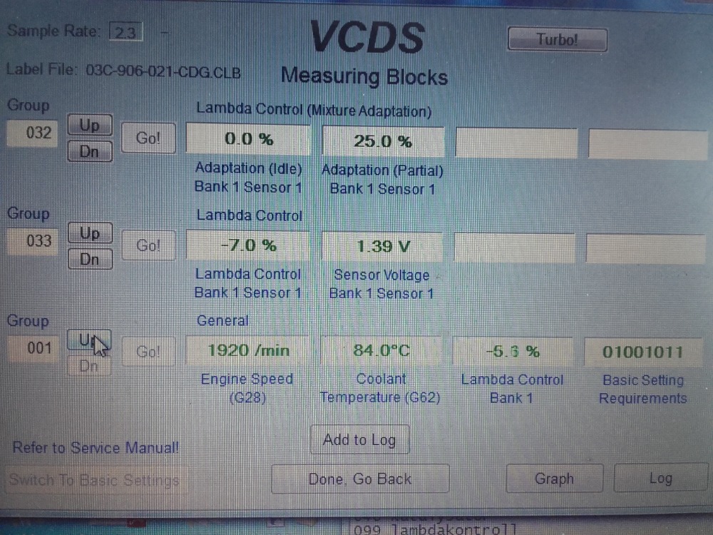

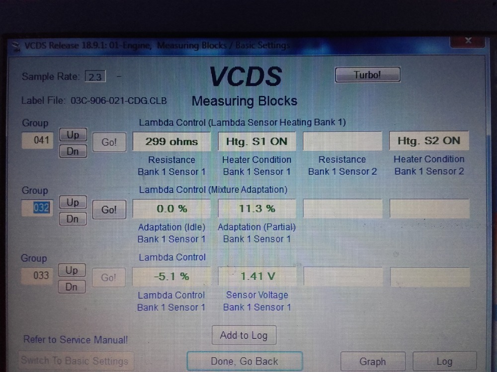

Are the sensors and cats warm ?What are the the O2 sensors showing in OBD II live data ?

Andy.MacFadyen wrote: Are the sensors and cats warm ?What are the the O2 sensors showing in OBD II live data ?
Yes - both warm.
I didnt even think of the OBDII data (in VCDS) - but I have VCDS data for long and short term fuel trim. The long term adaptation is very high.
I have fault code P2177 lean at idle - no vacuum leaks. This comes as I have understood now - when the car adapts from one fuel to an other. At first I thought it only came when driven on petrol - but last time it came after putting natural gas in. She told me she drives the car like a thief - perhaps the adpatation between fuels is the culprit.
Also - I dont know if this has anything to with anything - the second lambda heater resistance is missing for long periods of time, during which time the "Hetaer Condition" turns on and off all the time.
