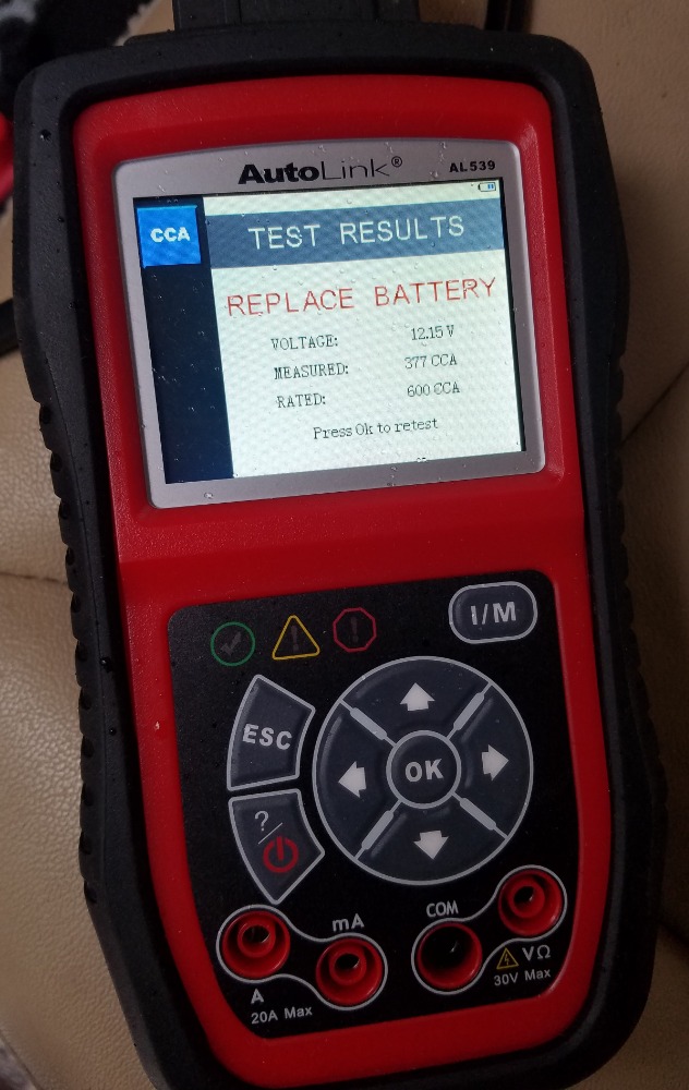

Heard a slow crank while I was driving one of the Escapes today, so I go straight to the battery tester:
Welp, time for a battery! But before I head to the parts store, I decide to try out the ammeter function for a parasitic drain test. I don't suspect a drain, but we're here, so why not? :silly:

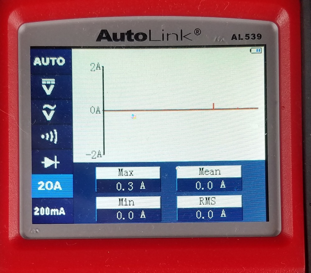

The results were somewhat disappointing. On the 20A setting, the meter doesn't have very good resolution, only showing values out to one decimal place. So, when everything on the car timed out, the result looked like this:

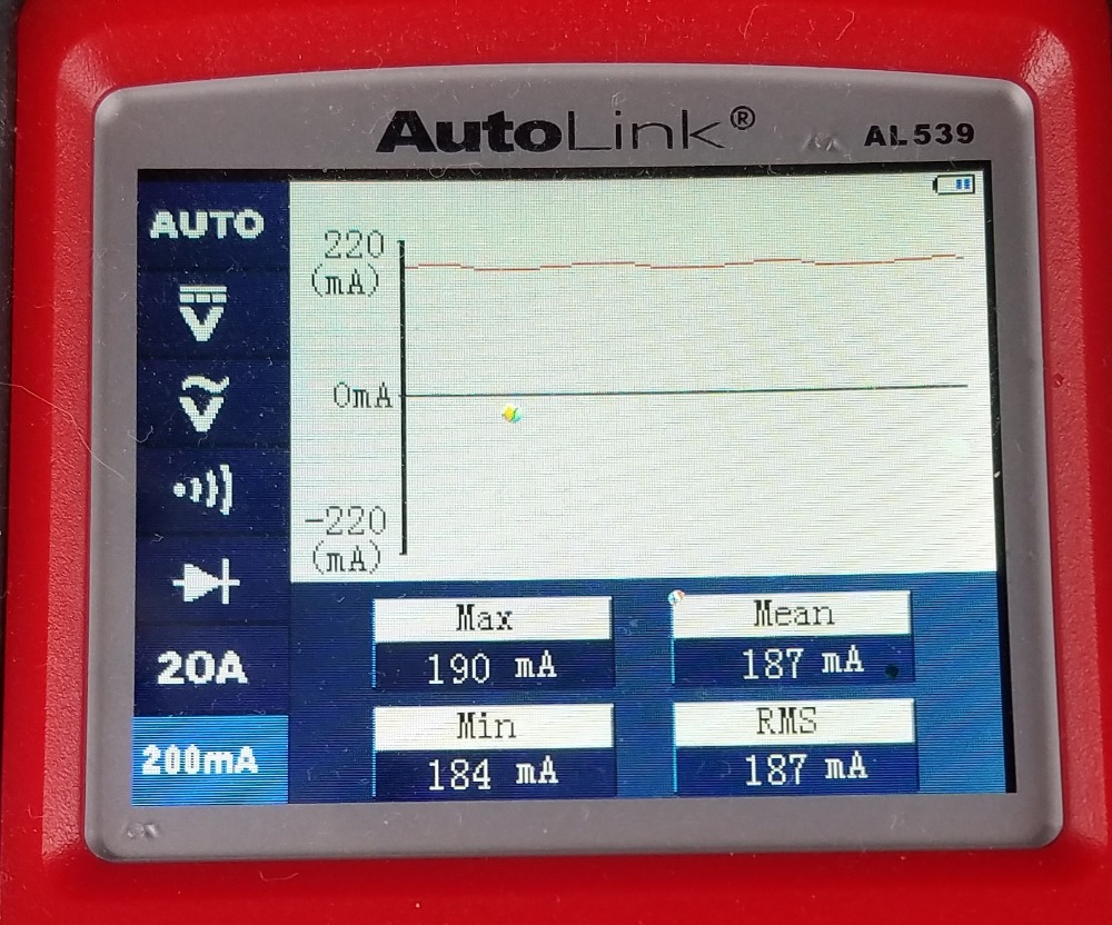

Tough to tell if I'm less than 100mA, or there's no connection. :silly: So, use the 200mA scale, right? That was even more confusing:
It appears that the 200mA scale literally maxes out at 200mA - I suspect that because when the meter is connected across battery negative, no arc occurs when the connection is completed. Makes me wonder if the current is being intentionally limited in this mode. :huh: I don't have any other meter with me, so I can't verify this. Maybe another time.
